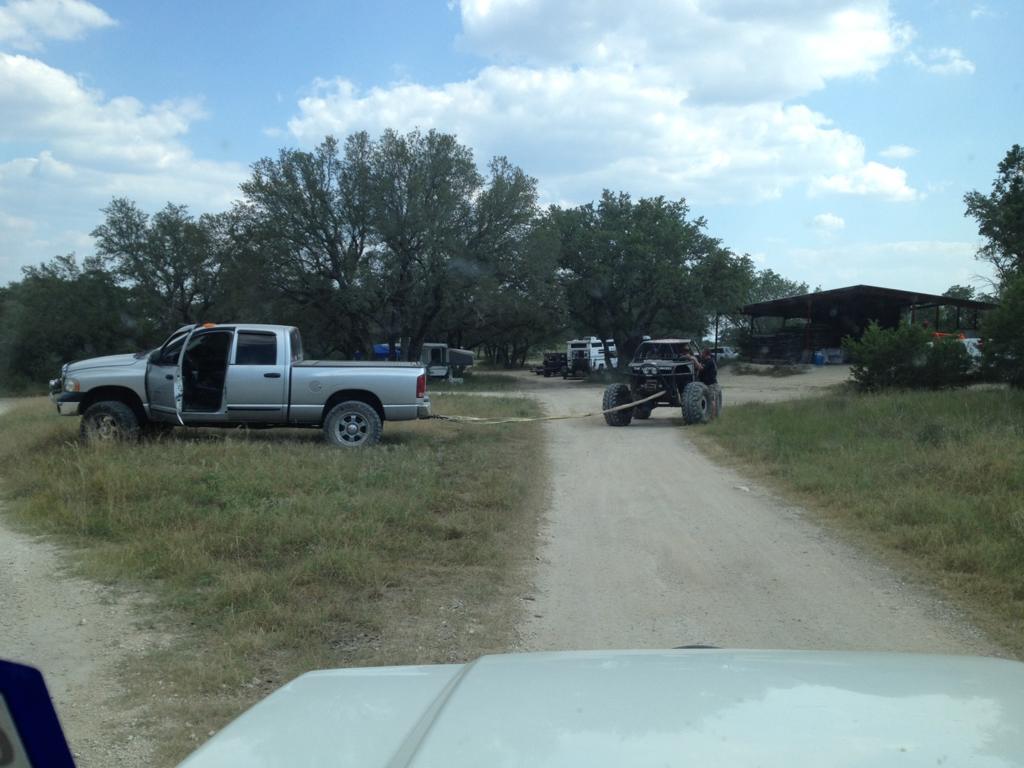

Drag link off pitman arm. Suppose to look like this! Now looks like that after some modifications to make it back home 3 1/2 hours.
Re: 05 PW upgrades!!
Post by 05PWrockcrawler » Wed Sep 04, 2013 4:55 pm
Ordered complete DOR steering replacement set up. And now I have a steel driveshaft. Broke driveshaft Friday evening and got up and drove 70 miles to Austin TX and looked for one in the junk yards with no luck (Weird)! Went to multiple driveshaft shops and no one could do it the same day. Finally found a hole in the wall shop and the guy barely spoke English and he hooked me up. Said come back in 2 1/2 hours. So we went to Dave and Busters and drank some beer and played some games until he called me. Big thanks to that guy!! Back to the Offroad park and installed the driveshaft and wheeling again by 3 PM. Until about 11 PM when the drag link broke. Then trail fix and back to camp.

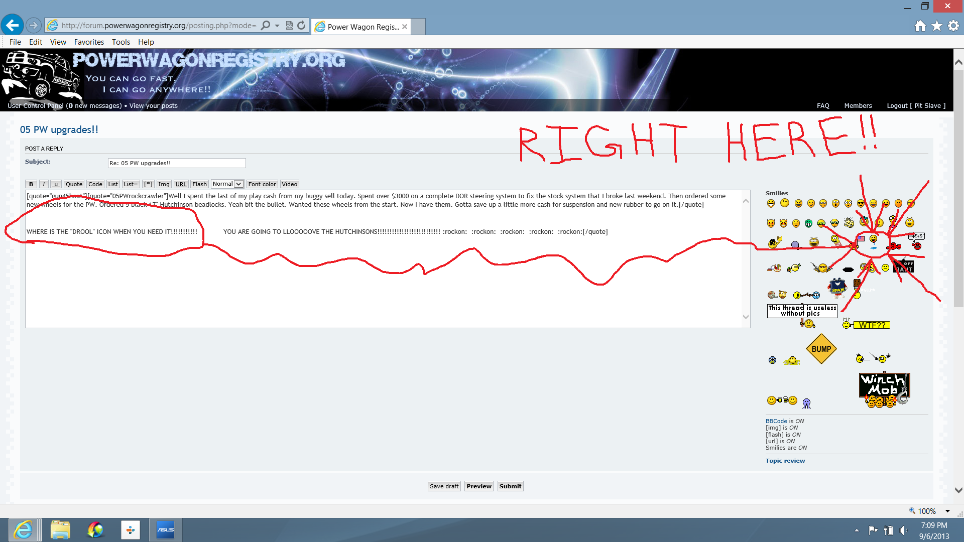

Pit Slave
Posts: 1486
Post by Pit Slave » Fri Sep 06, 2013 7:20 pm
gun45boat wrote:
05PWrockcrawler wrote:Well I spent the last of my play cash from my buggy sell today. Spent over $3000 on a complete DOR steering system to fix the stock system that I broke last weekend. Then ordered some new wheels for the PW. Ordered 5 black 17" Hutchinson beadlocks. Yeah bit the bullet. Wanted these wheels from the start. Now I have them. Gotta save up a little more cash for suspension and new rubber to go on it.
WHERE IS THE "DROOL" ICON WHEN YOU NEED IT!!!!!!!!!!! YOU ARE GOING TO LLOOOOOVE THE HUTCHINSONS!!!!!!!!!!!!!!!!!!!!!!!!!! :rockon: :rockon: :rockon: :rockon: :rockon:
look at the pic......... :P

Pit Slave wrote:
:doh: :doh: :doh: I SWEAR IT WASN'T THERE WHEN I WAS LOOKING FOR IT!!!! :digahole: :rofl:
