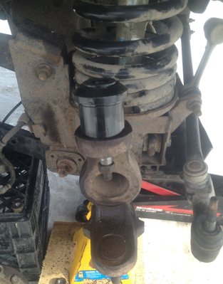

Re: PW Chase Vehicle Build By NEO
What brand are those?...any other pics of the removal and install?
Dynatrac. And this round i didnt take many pictures due to time constraints. Only have one other pic

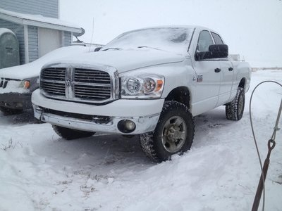

verdesardog wrote:I can tell it's a Cummins, looks like the block heater is plugged in.
LOL
Mine came with one too, but it sits safely tucked behind the bumper. I love being able to park the truck in my garage when it's snowing and cold outside.TwinStick wrote:verdesardog wrote:I can tell it's a Cummins, looks like the block heater is plugged in.
LOLI have one of those on my Hemi Power Wagon. Everyone thinks it is a diesel !!! LOL

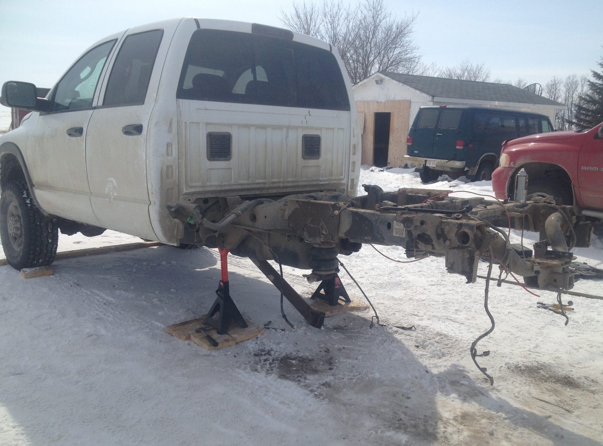

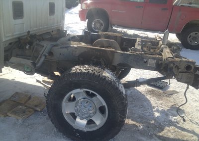

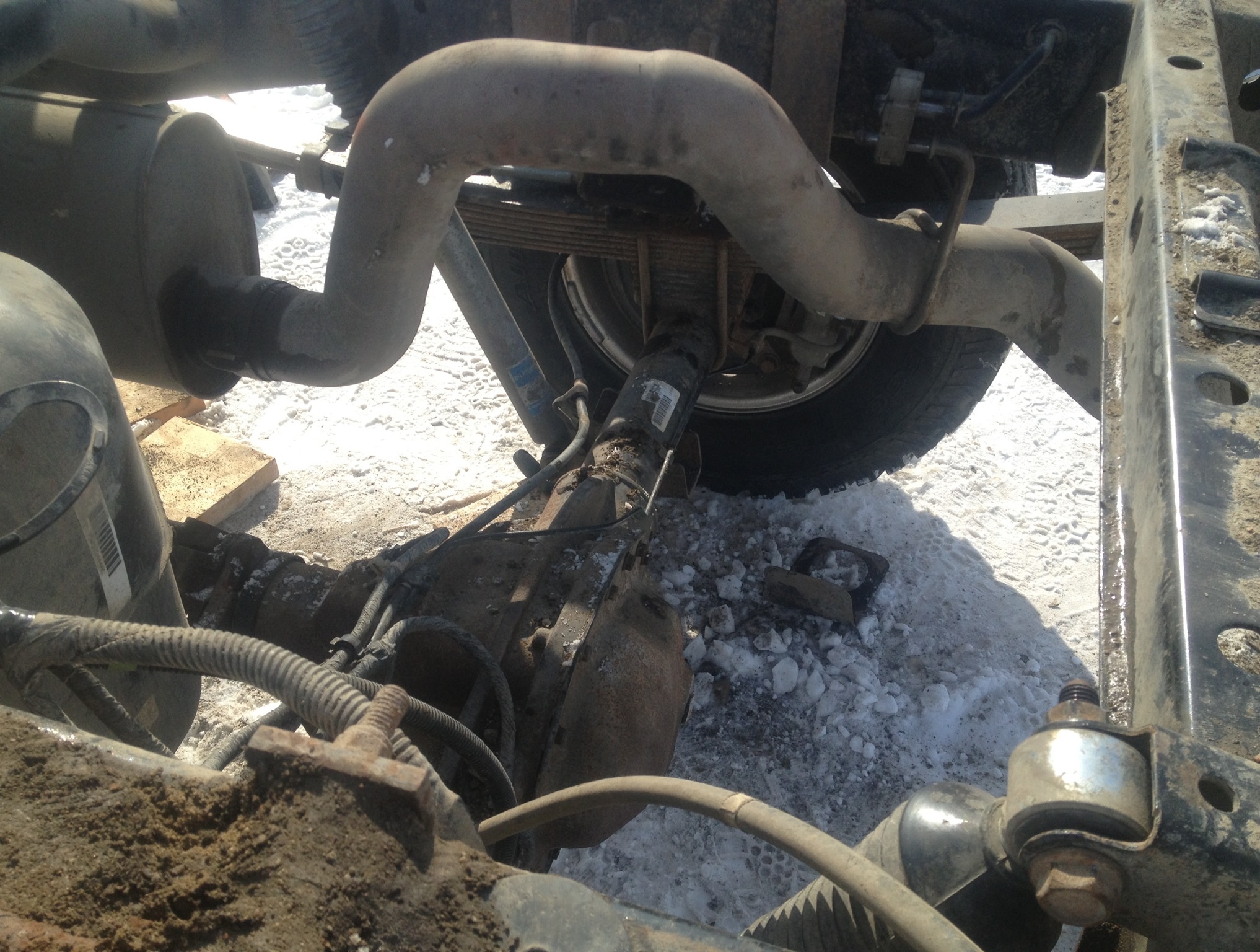

Alright boys. Today is the day for the rear axle. I convinced a buddy to come help me take the box off. And gonna tear into the rear end. I'll make sure to take some pictures. Here we go

Alright. 5 hours with 2 people and no hoist or fancy tools. Still have to take it for a run. Fluids and brake bleed yet to go. And track bar in front

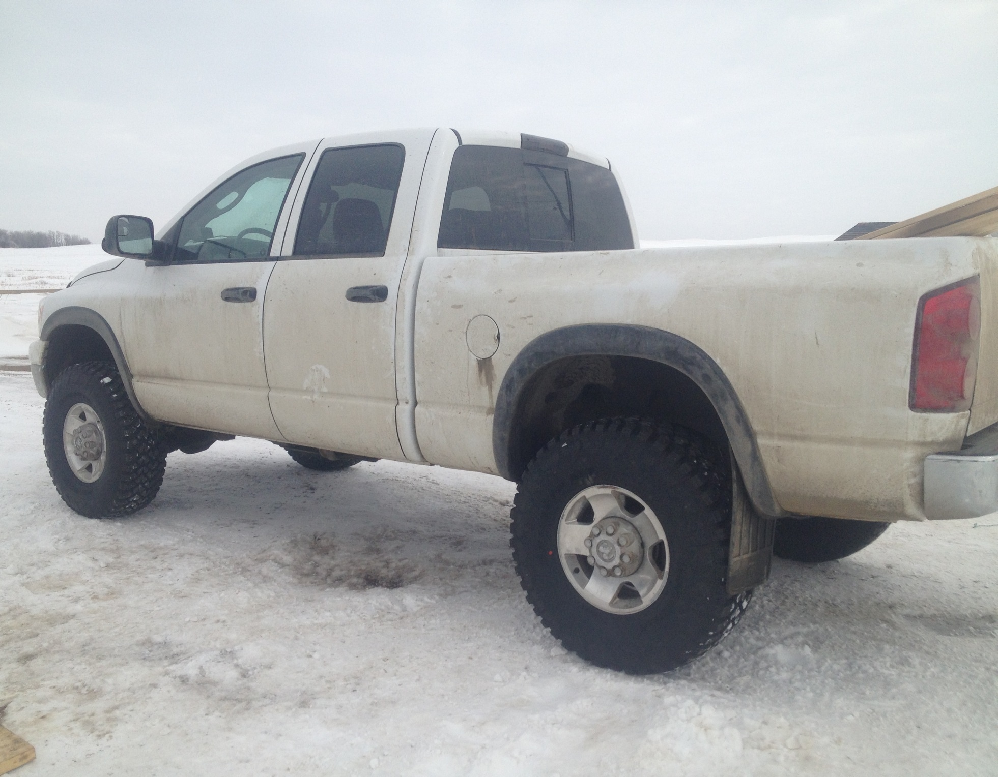

Tires on!! Had to trim the fender flare on fronts at bottom but otherwise fit perfect

What size are those?
37-12.5/17SheepdogOutdoorsman wrote:What size are those?

Awesome! The truck's looking great! Lets see some of the trimming photos...
Same trimming i had to do on my old powerwagon. And there is no rubbing on control arms or sway bar so im haply
Nice...factory control arms? ...would a set from Thuren and etc..help to avoid the trimming while centering the axle..or we must add lift also...I like the way she sits
Factory control arms sort of. I don't know how much of a difference but im using the pw lower arms with the diesel upper. Also when I swapped the track bars cause the diesel was shot with the powerwagon it moved the axle. I noticed because i had to re Center my steering. Also looked a hair longer side by side. Realistically i am now the height of you guys. Any taller isn't worth it. Tires are what give you the real ground clearance.
