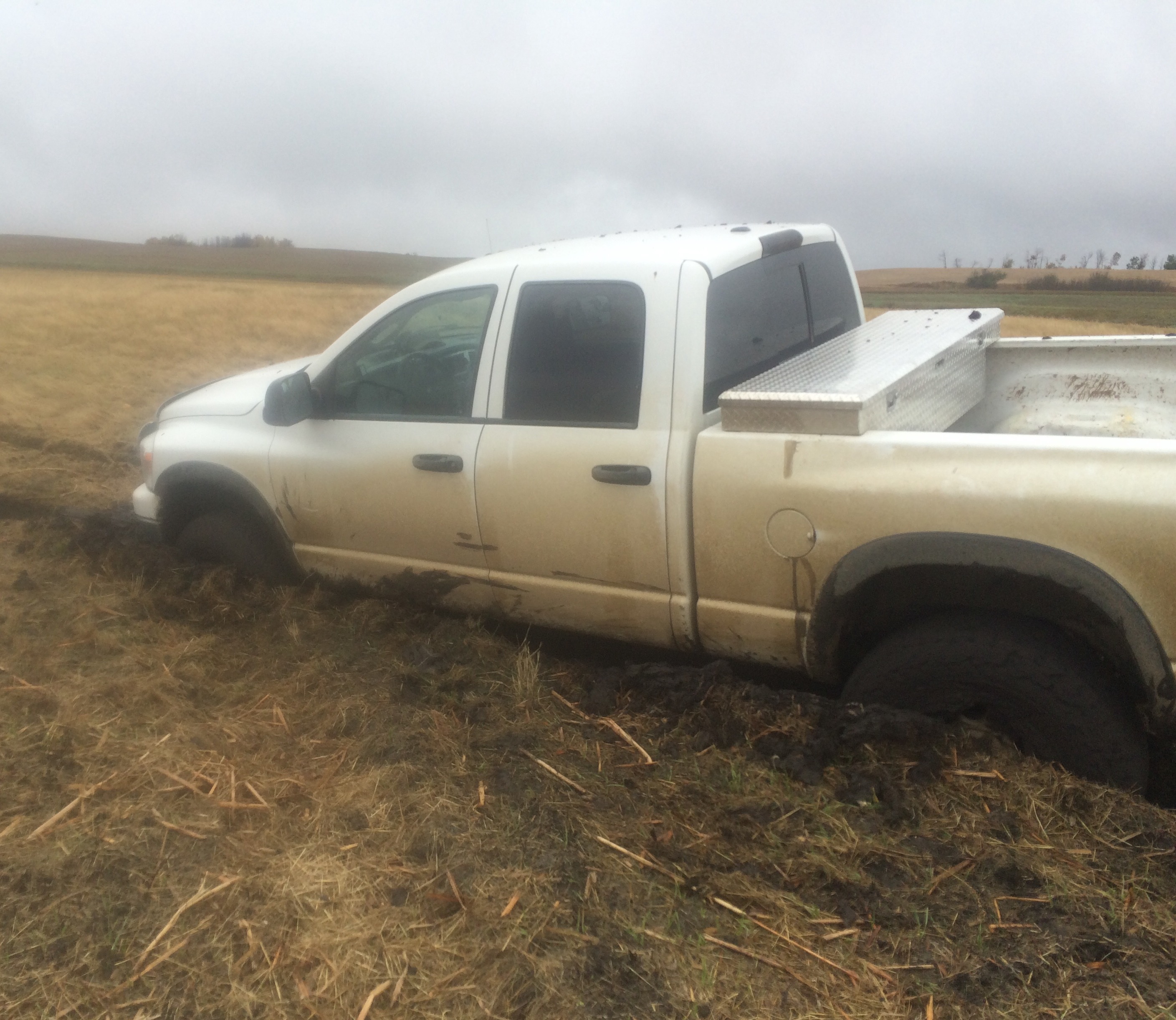

Re: DamageWagon's AdventureWagon
You mean like so?
I was thinking more like....
Both pretty similar though.
There's stuck.
Then there's STUCK.
Then there's "Hey buddy... You got insurance?"
Sent from my safe space
There's stuck.
Then there's STUCK.
Haha. More alike than we know lol
