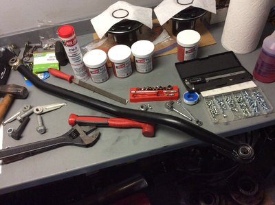

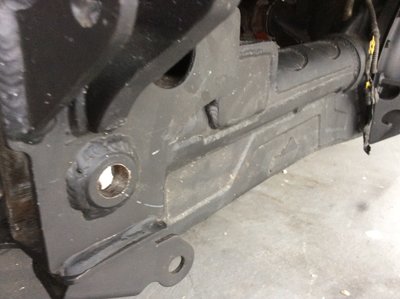

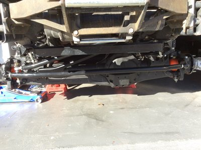

It turns out that when the axle was trussed they put a weld washer on the track bar mount to reinforce it and it has rendered the stock bolt to short

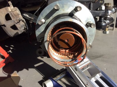

Pulled the dynaloc hubs off my tj and swapped in the drive flanges from the truck, I missed having lockouts on the street. Packing the new bearings and hubs with redline cv2 and getting them on the truck this weekend I hope.

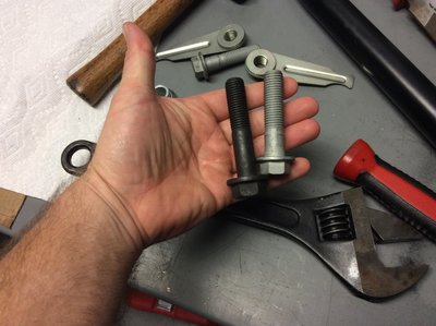

McMaster Carr came through with a M16x2.0 80mm flanged hex bolt grade 10.9 to my door in two days for 12 bucks. The fastenal in town would only sell a pack of 25 for 110 and could have them in a week lol.

Got the new Carli track bar adjusted and ready to go on today as well

Maybe the old hole was oblong from a loose track bar. Nice replacement. I think you'll enjoy haveing the free spins on there again. It's nicer and quieter during highway rides ofcourse. Plus pick up some mileage and not wear out all your u joints as fast.

And.......dynaloc hubs don't fit in spyntec shorty freespins, damnit! Back to the drawing board on that one, either going to run regular lockouts or maybe go back to driveflanges and just pull the pucks when I'm city driving.
At least the hubs are on anyway.

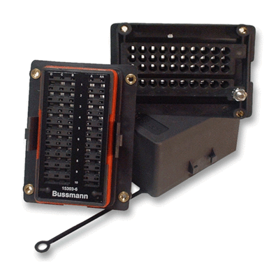

- Sealed bus bar-one side ground other power
- image.jpeg (24.65 KiB) Viewed 5500 times
- TE connectivity sealed fuse relay block (got 2 of these)
- image.jpeg (33.82 KiB) Viewed 5500 times
- Kenwood radio, gonna do MARS mod and get broadband antenna for max versatility

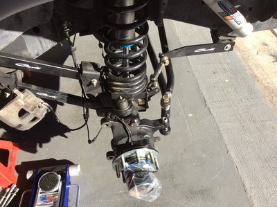

Got a little more done today, test fit the extreme overkill steering with emf tie rod ends and cycled it. Alls looking good just waiting on CJC to send one more rod end.

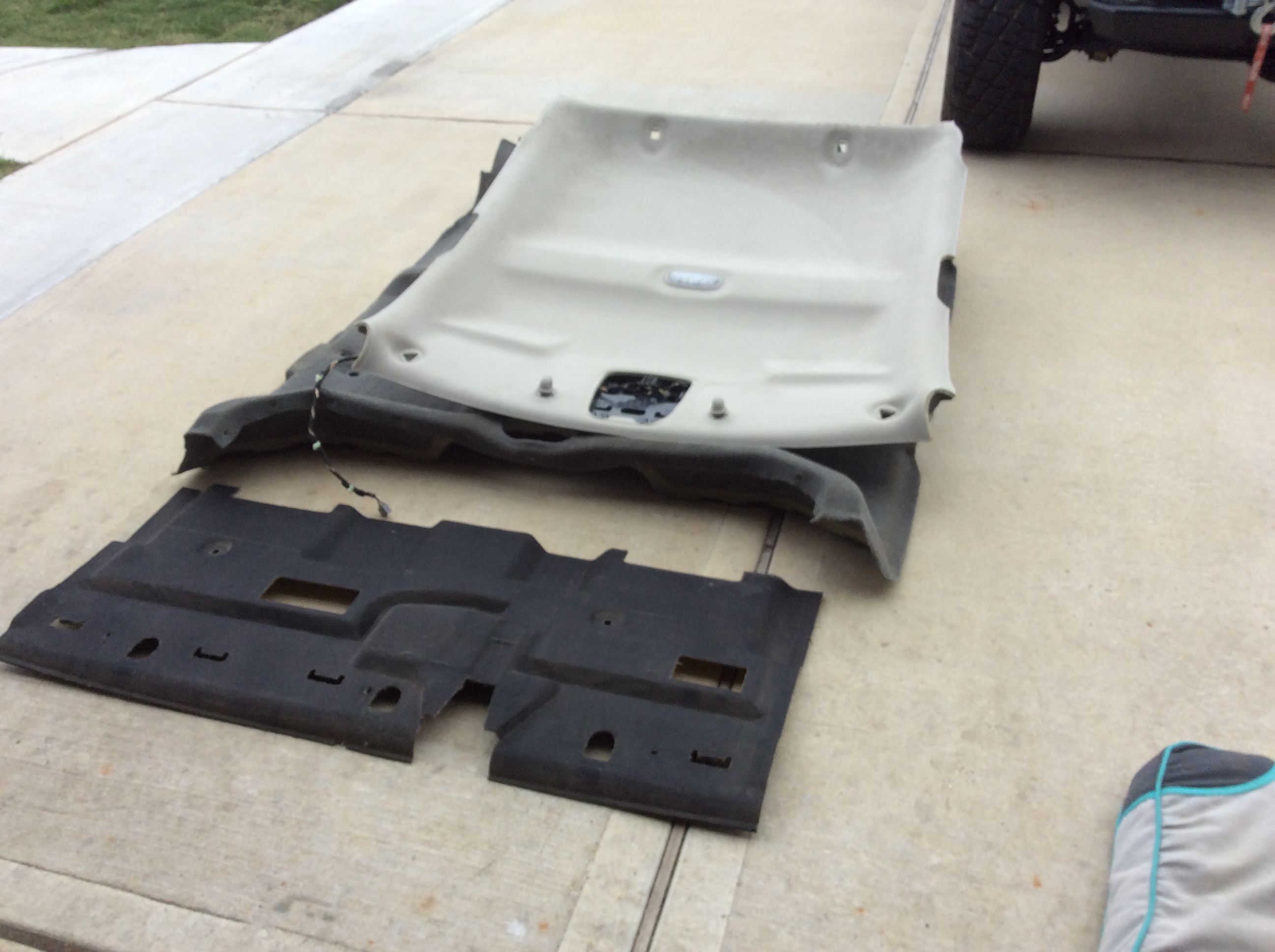

Pulled the rear seat today in preparation for a new/used 60/40 split bench I scored off eBay. While I had it out I pulled the carpet and tried to figure out how best to mount the fire suppression cylinders. Turns out I was able to trim the carpet and fit them into the under seat cubby's just fine!

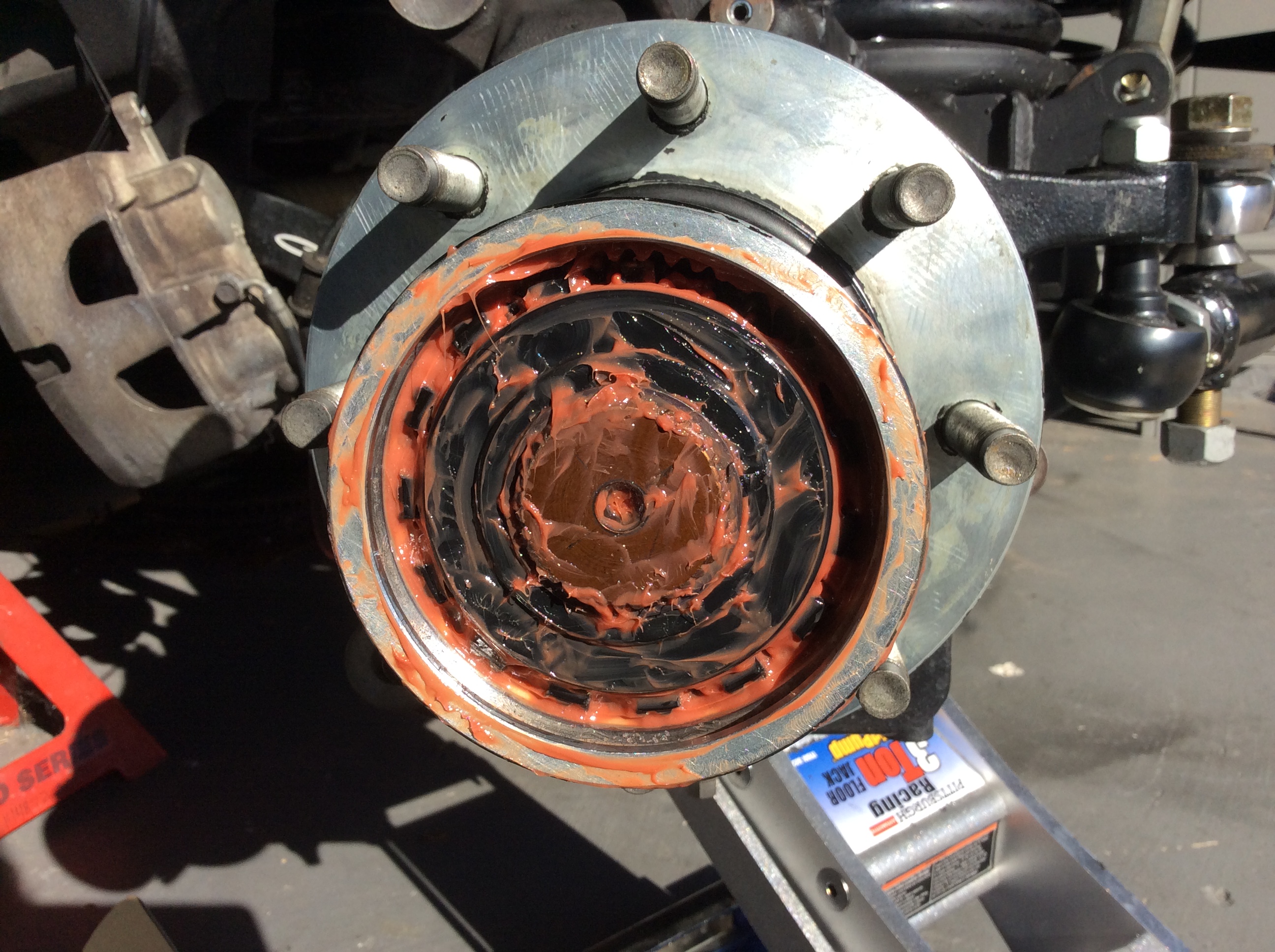

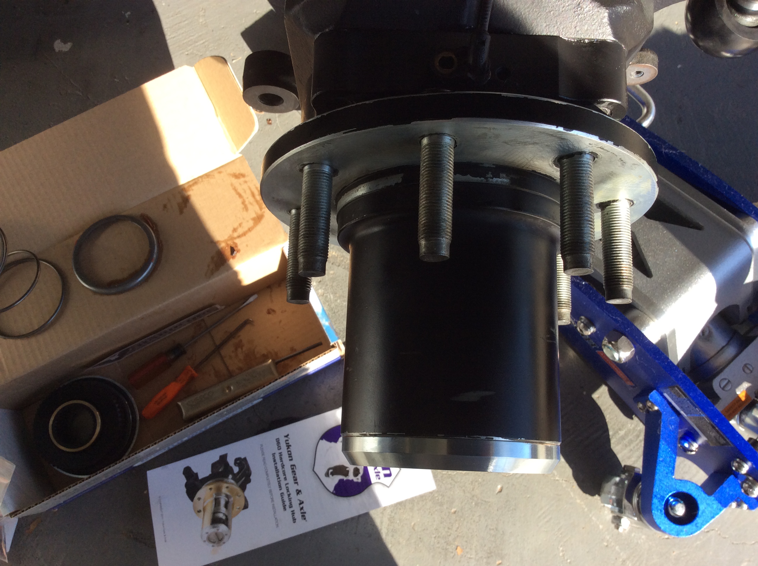

Got the lockouts from Yukon yesterday and test fit today. The quality and fitment are really good and they're a very simple and sturdy design. I ordered the wrong spacer on some bad advice from one of their distributors but I called them and the correct spacers are already on the way. Great customer service.

Can you measure from the flange to the outside of the locking unit? This setup you put together looks to be the shortest locking hub setup I have seen. Either that or your tire sidewall sticks out quite far

The dynalocs don't stick out far at all AZ I believe they are the shortest

AZ- I'll get a measurement for you tomorrow and post up some pics
2wagons- I have a set of dynalocs on the bench so I'll lay them out next to the yukons and measure them, I would love if you could measure the length of your freespins so we can compare overall length against the spyntecs. Maybe I'll start a thread in general

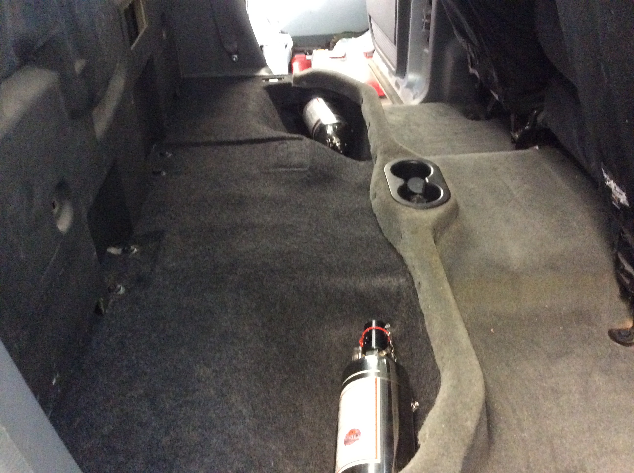

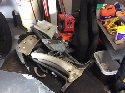

Pulled the interior today in preparation for sound deadening and install of ham radio, gps, air locker plumbing and wiring and fire system plumbing. Seats and carpet are out as well as all interior paneling and the headliner.
