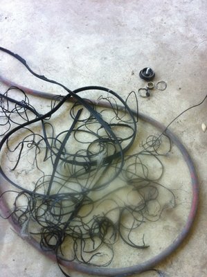

Ok the next day I had a DR appointment and took the PW and made it about 30 minutes down the road when dash light came on to check gauges, noticed the voltage was a zero then the temp was sky rocketed!!! Shit shut down and coast to side of road. The bottom pulley just came apart and then new belt was shredded and got wrapped around the fan and other pulleys. I am pretty pissed off by now and don't even want to call the wife since she hates my truck and I have spent a ton of cash on it lately. Go to dodge and spend another small fortune on more parts.
what's left of the belt and pulley!!!

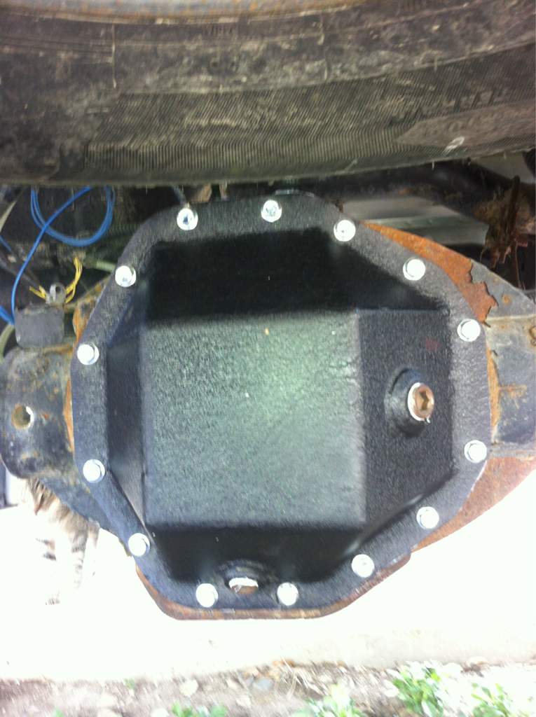

Well got back in from offshore and got my DOR diff covers installed, everything cleaned and expected. Fill up with Amsoil gear oil. Looking good. Gonna try to get my Airflow snorkel installed tomorrow maybe. And the Tuesday pull off my Amp Research steps ( gonna miss them) to make room for the rock sliders.

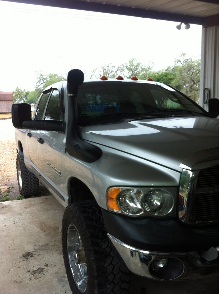

Well got my snorkel on today!! Wasn't too bad except that black mastic they said to use instead of silicon. It got everything covered with that crap.

Drive the truck to town today. Should have seen all the double takes, stairs, and rubber necking. Had 9 different people ask what is that on your truck? I said a snorkel. Blank stare and then what????? Lol

Looks awesome. Great install. Looks damn nice!!!!

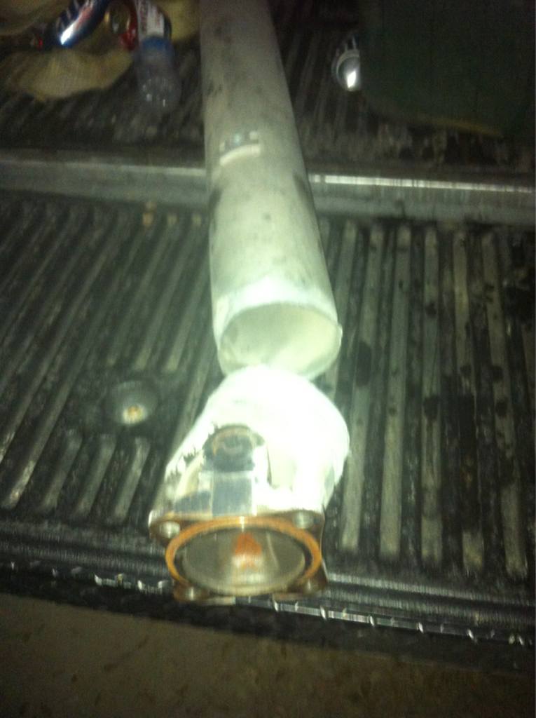

Hey 05. I am running a stock front driveshaft (because it is BALLZ tough). But the rear I shortened up and ran a 3 1/4" ID 3 3/4" OD .240 wall DOM tube, because the rear stock DS is a POS... Now I can land on a rock and have the ENTIRE weight of the truck on the shaft, and it wont even think about breaking. Here is what happens to a cheap ass stock rear shaft that just barely kissed a boulder under half throttle. I honestly dont know why Dodge ran a stock shaft with .040 thick tube :doh: :doh: :doh: :doh:
If you want to make a bullet proof shaft using the stock yokes etc. We can make you one as I have some left over tube to build a few. They are a bitch to balance, but I figured out a perfect way to have a self balancing shaft :rockon: :rockon: :rockon:
We put a half ounce of steel BB pellets inside the shaft before we welded it up, IT WORKS AMAZING!!!!!!!!!!!
here is what happend to my stock POS the 1st time I took it out:)
