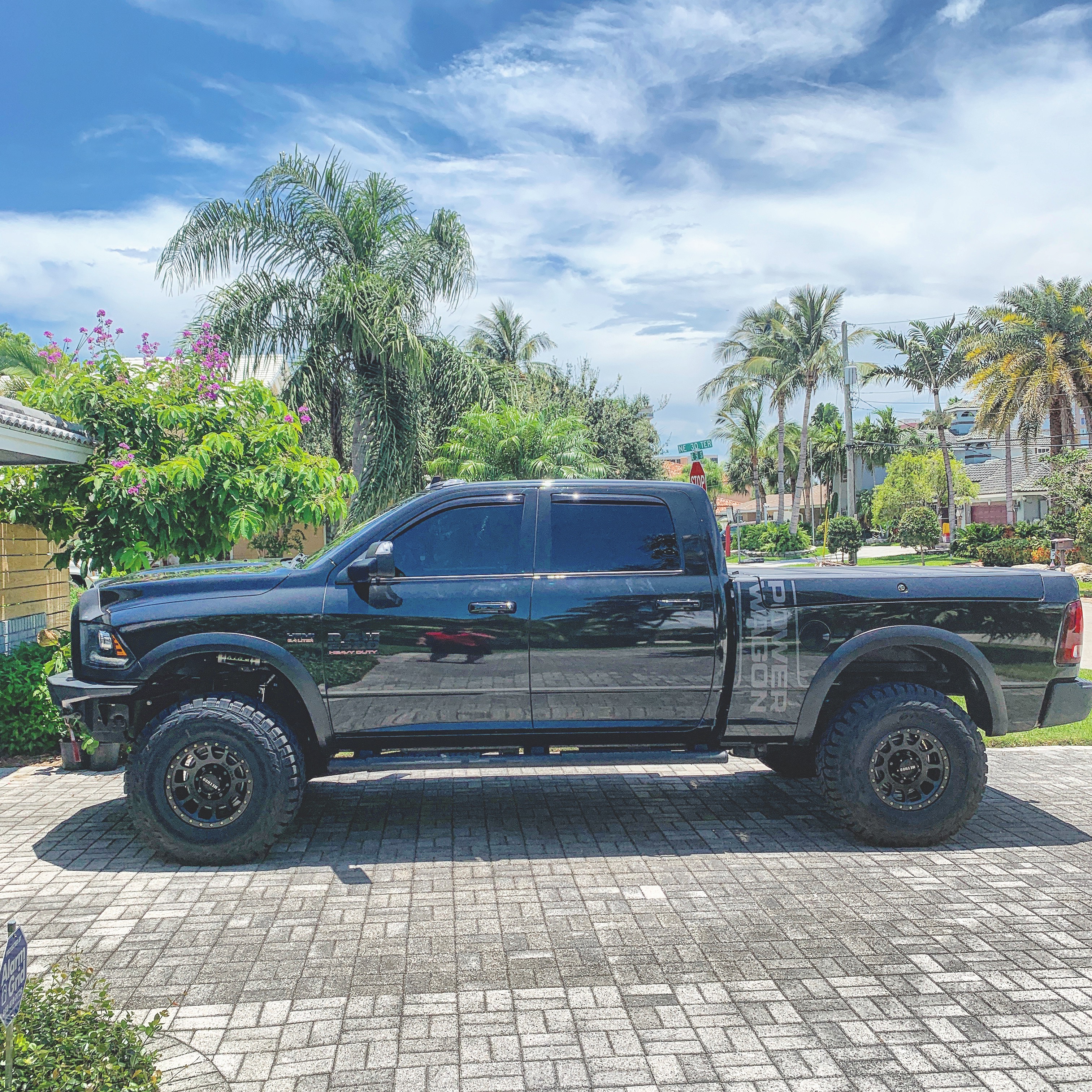

these Toyo rt 37x12.5 have changed my life.
the 35s had over 20k miles. 1 tire had 3 nails 2 tires had 2 nails and 1 tire had 1 nail over the course of their life.
(gave them to my Brother in law for his tacoma... they will see another 20k miles and probably wont ever pop or puncture with the featherweight above...)
sooooo they rubbed. I actually did not expect it, but it is what it is.
had to trim the bulging plastic at the back of the front fender wells. Tin snip made this quite simple and its not the prettiest but it clears the pinch seam just fine.
The ride has improved 10 fold. 42PSI front and 34PSI Rear.
They mute the transitions and rough surface of the road much better then the beat up 35s. Road noise is down, MPG are the same, braking is still adequate.
AEV procal needed 36 inch input for correct speed, and the Transmission is unbelievably more efficient.
I assume the truck would lug more at X Speed being a lower RPM for the same gear, but instead of sitting in the same gear lugging away, it is more inclined to downshift.
80MPH on the highway and 5th gear is more readily available.
So very close to curb stomp status.(40s if i make it to 40k miles)
