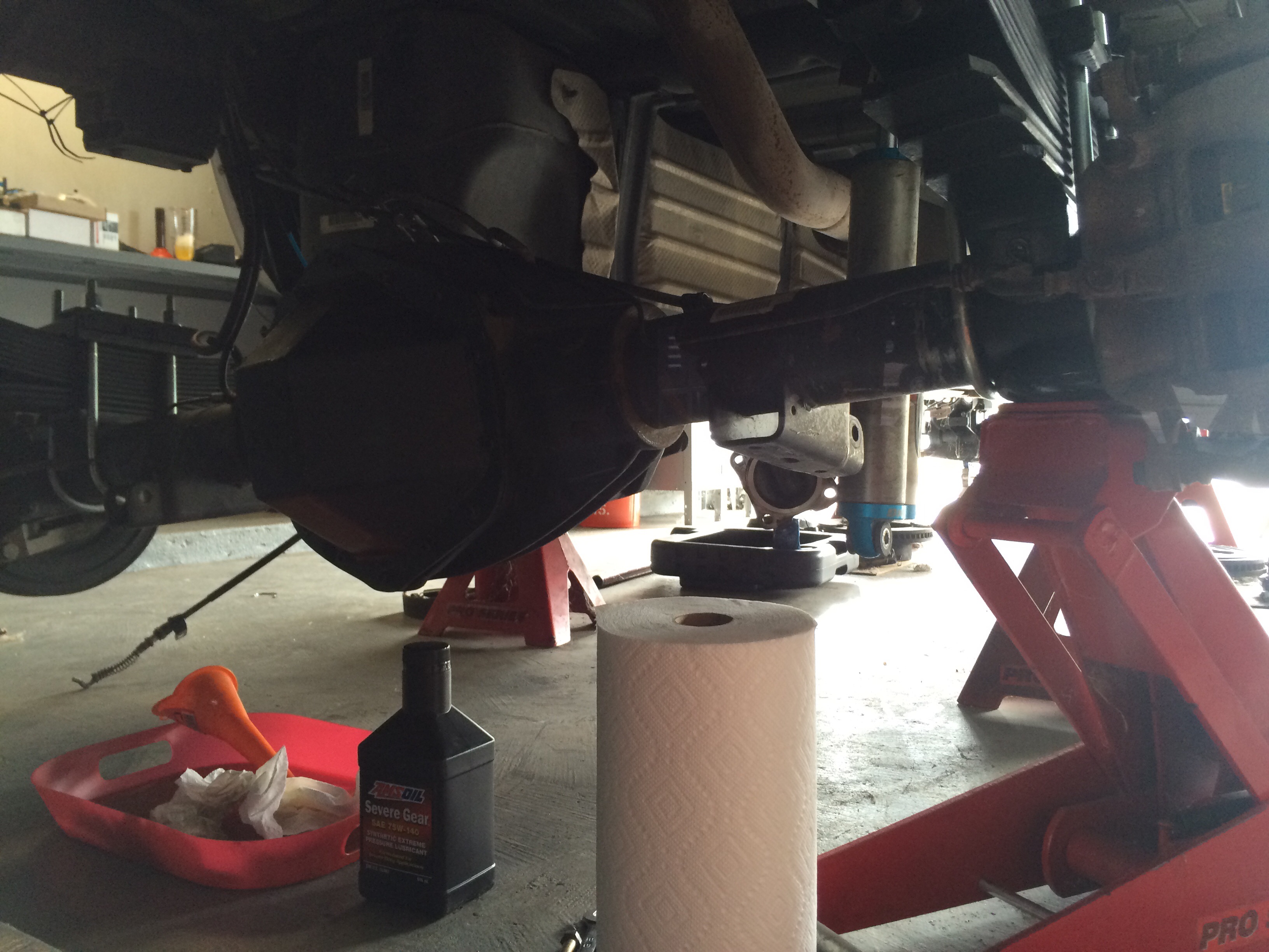

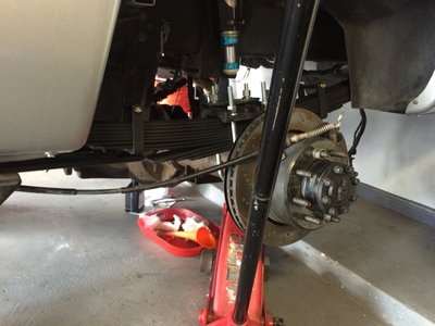

Filled up the rear axle today, along with hubs and the ballistic fab cover she took a little over 9 quarts of gear oil lol. Also put 2 gp101 filtermags in there to keep metallic particles from wearing the ARB orings prematurely. Put them in the casting and they're so strong my socket kept sticking to the cover bolts on that side.
Buttoning up the parking brakes and then getting the wheels on and setting her on her own weight again to torque the suspension down.
Have to jack up one side at a time so the hubs can fill
big damn diff cover

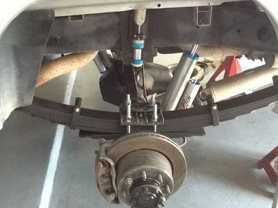

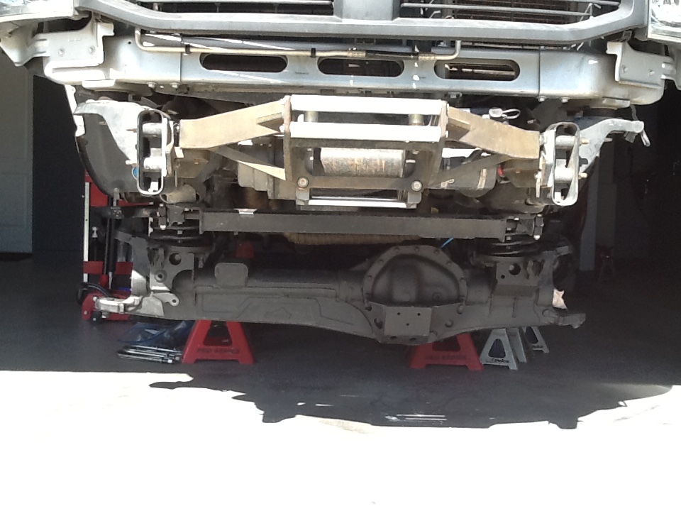

The rear is about done and the front axle is on the truck today! Still plenty of work on the front end, next up is balljoints and wheel bearings.
Ridetech 5 gal. aluminum air tank should be here today and arb twin compressor and powertank jet pack 2 show up Monday. So next week I'll start plumbing the air system.
Decided to install an on board fire suppression system with two zones, engine bay/trans tunnel and gas tank/transferflow fuel cell. Going with manually operated coldfire systems and a couple of halotron handheld units in the cab for electrical fires. Stuff is ordered and should be here soon.
Rear buttoned up
Hanging by shocks and control arms

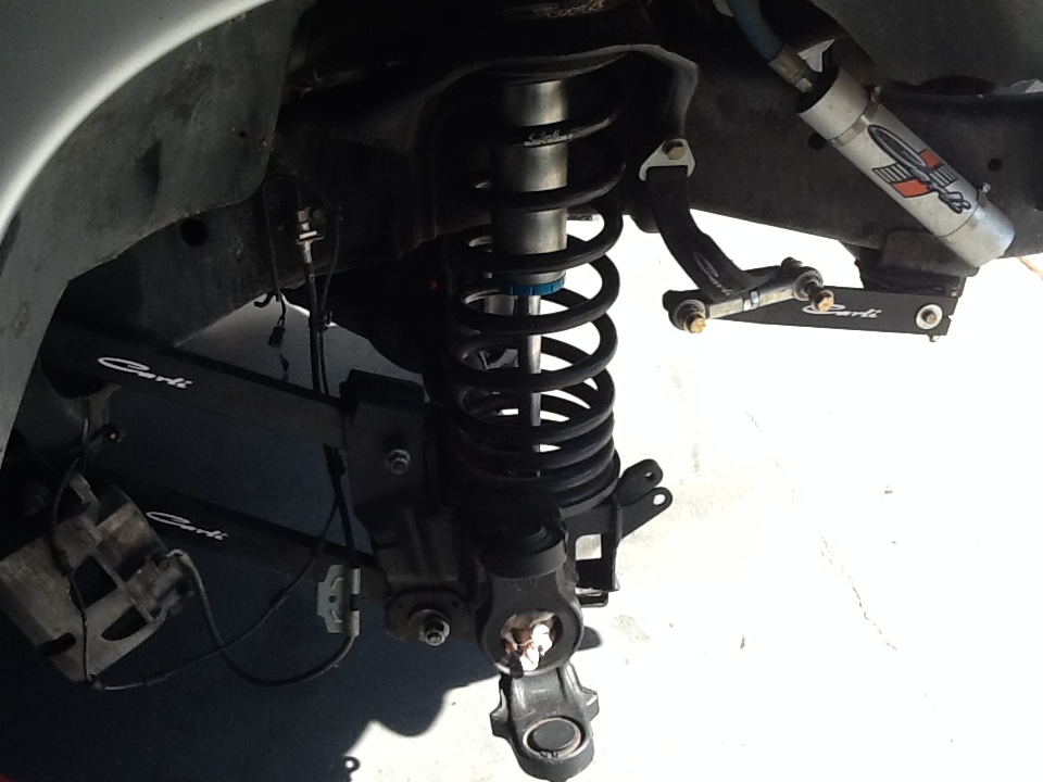

Did the carli ball joints this weekend, holy sh*t! removing the cooked in joints from when creative fab trussed it was insanely hard. Used my snap on press and a breaker bar with a hilift handle extension and I barely was able. A few times a joint would let loose a little and it sounded like a gun going off and I thought I broke my press lol. Got the knuckles back on and the spindles cleaned and painted. Front should be back together soon.
The hernia
The carli joints
The knuckles
