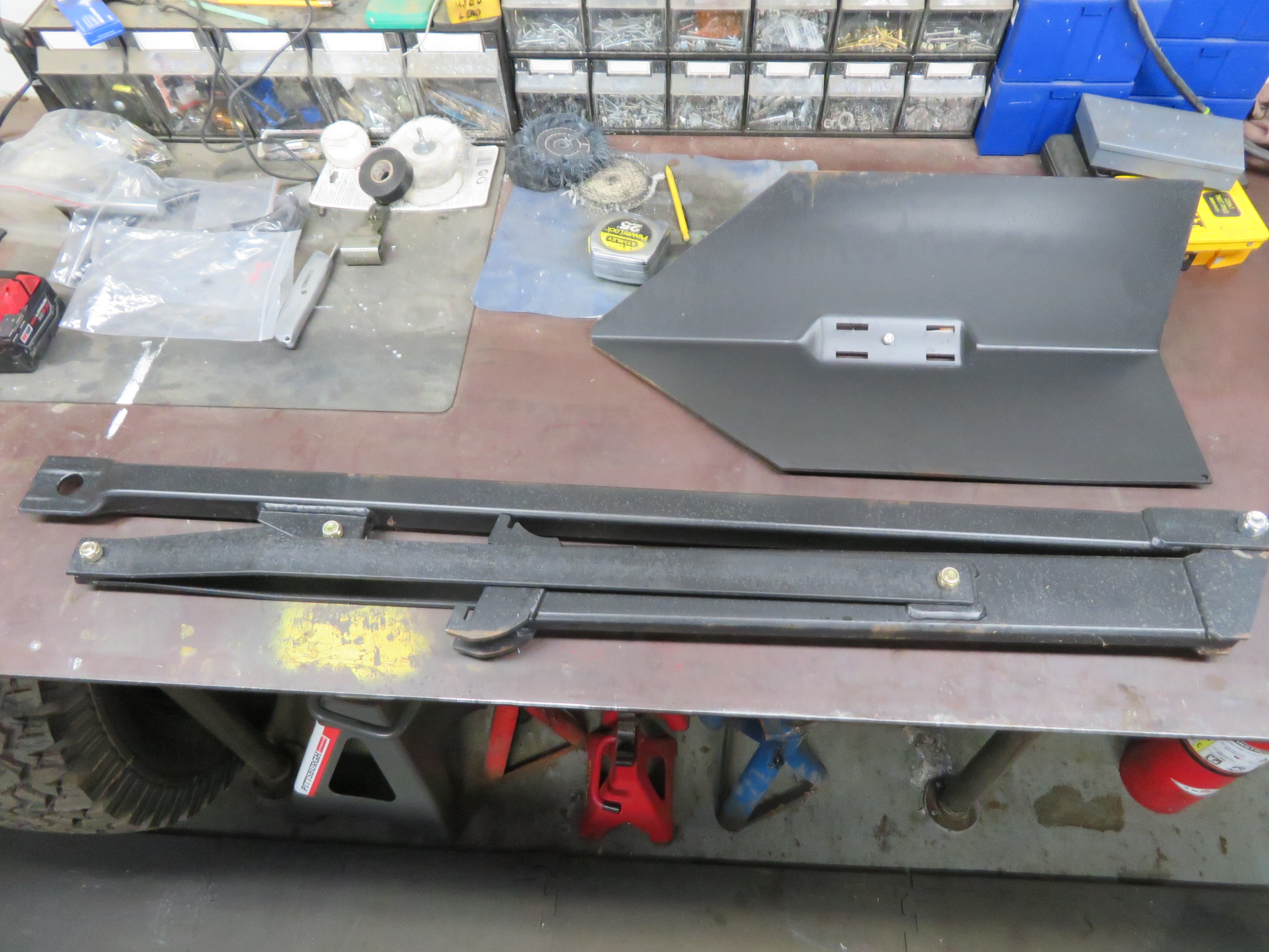

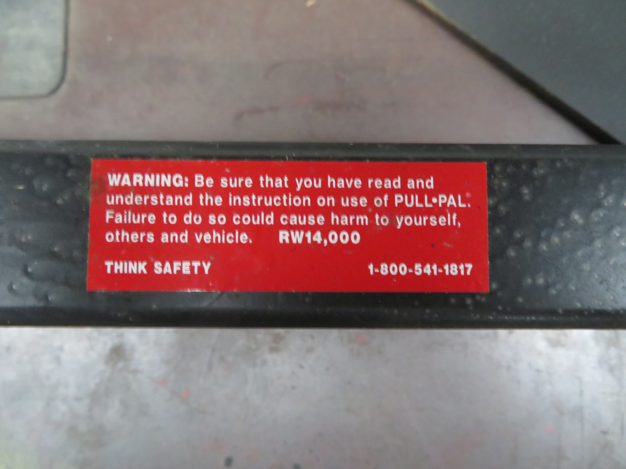

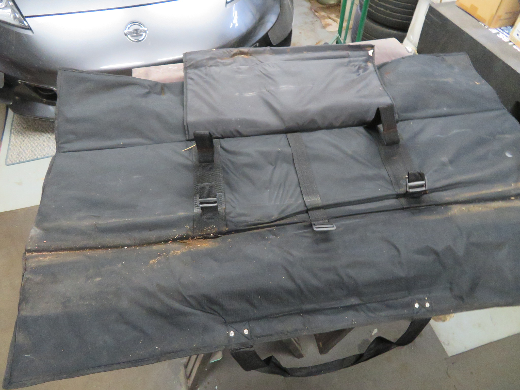

I had bought the 14,000 lb pul-pal years ago. I had it in the front of bed. Between the tool box and front wall, standing on end. I haven't had the need to use it yet. I had to clean the bed out yesterday. Was hauling patio brick, sand and base. The bed was a mess. So I took it out to check it's condition. Surprised that it has no rust on it.
The damn thing weights about a 100 lbs.

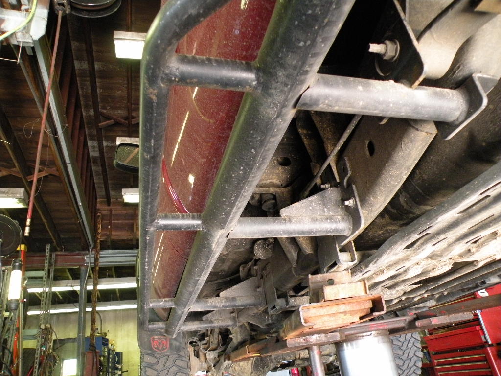

I'm seeing that on my factory rock rails, too.
- Posts: 5575
Re: Rusty's Build - 2008 POWER WAGON RC
Get someone to weld that gap up.
Their thought process was probably to get rid of moisture inside the tubes but i think welding them solid & just drilling some tiny weep hole would be better ?
- Posts: 5575
That would be the proper way of doing it. The weep hole would have to be about 1/8" diameter. And it would get plugged with mud.
