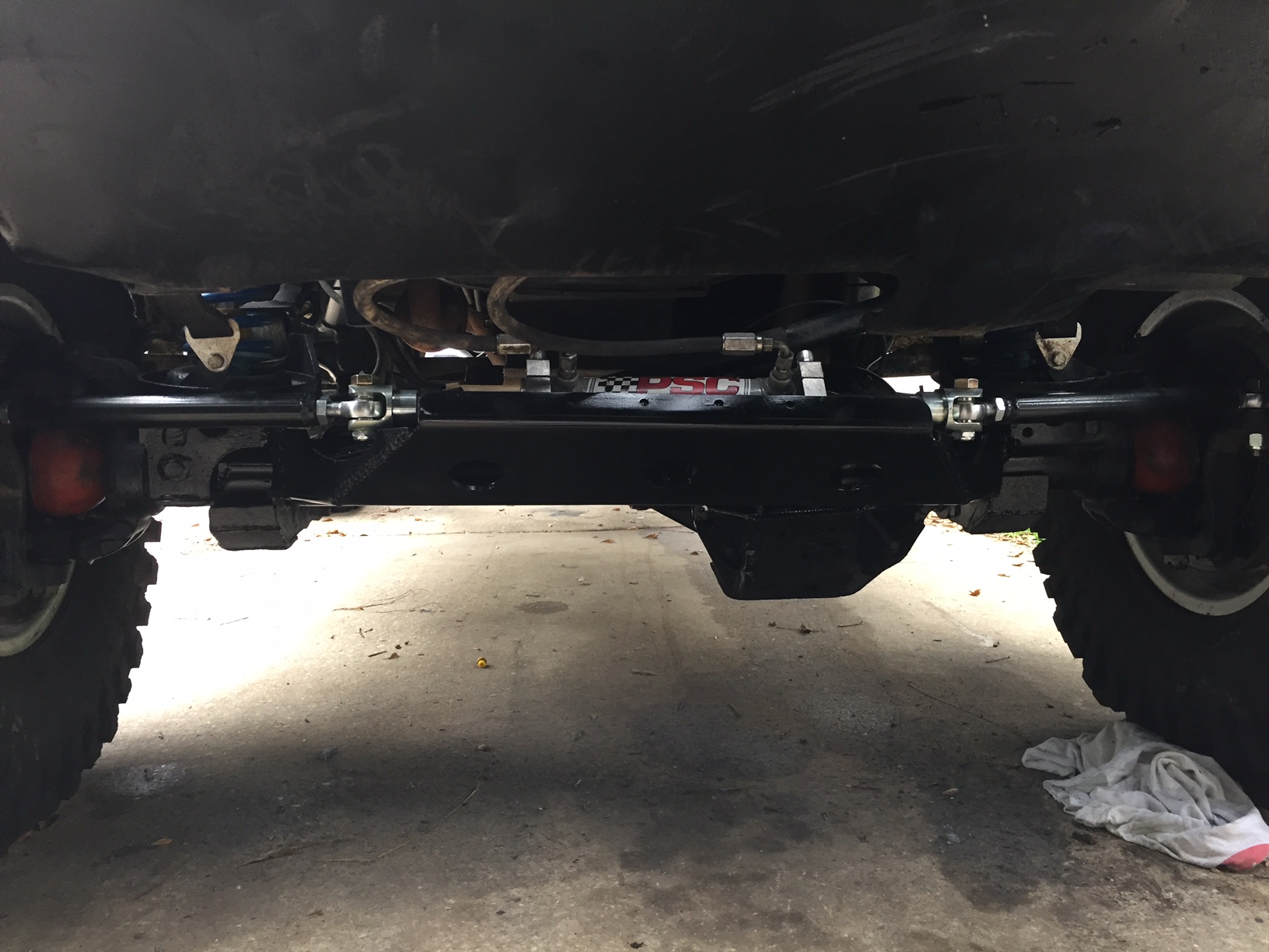

HOLY SHIT!!!!!!!! This conversion was a MAJOR pain in the ass..... about 30 hours of labor/fabricating to make everything work flawlessly... and man what a HUGE difference in suspension flex and steering feel..
Went with the full Feedback and self centering orbital valve (about $300 more than a regular orbital valve) and a 2.5" PSC RAM IT is a MAJOR difference and brought everything high off the ground and out of the rocks. LOVE the self centering feature....
MAJOR Fabrication to make this work.... It took me longer to do this than Truggy'ing and triangulating the rear suspension.....
after some back breaking work, and back to the drawing board 3 times. I finally found a way to make everything work while using the stock location of the factory track bar, under full flex on both sides.. .... The results are fantastic, and driving on the road is completely doable, as the feedback is impressive...
Enjoy the pics, and if anyone wants to go full hydro, please let me know, as I found all the "To do's and what NOT to do's) Got all the measurements and lengths/distances and all the hard shit worked out in case any of you want to do it to there's and save a ton of time and cursing.. :doh: :doh:

It looks a little crooked in the pics,,, but the rear passenger tire was half full, thus making the truck body lean... AND the front diff skid got hit HARD by a rock and shoved itself over a bit making it look funny.. ;) ;)
