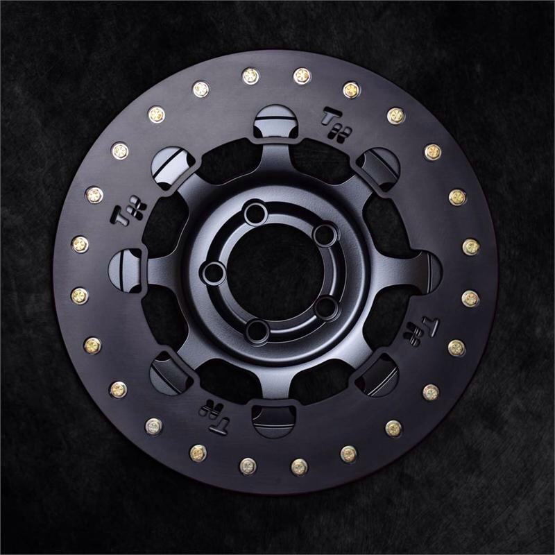

Are they steel? That would help. Gonna look sweet. Thread lock the shit outta those bolts though. I've heard enough guys talk about em coming loose over time
Re: "Saggin wagon" short and sweet.
What the bead locks? Ya I believe thread locker is manditory for bead locks

Yes. I know you know but so many idiots out there ruin it for the rest of us. Can't wait to see how they look on your rig2wagons1driveway wrote:What the bead locks? Ya I believe thread locker is manditory for bead locks

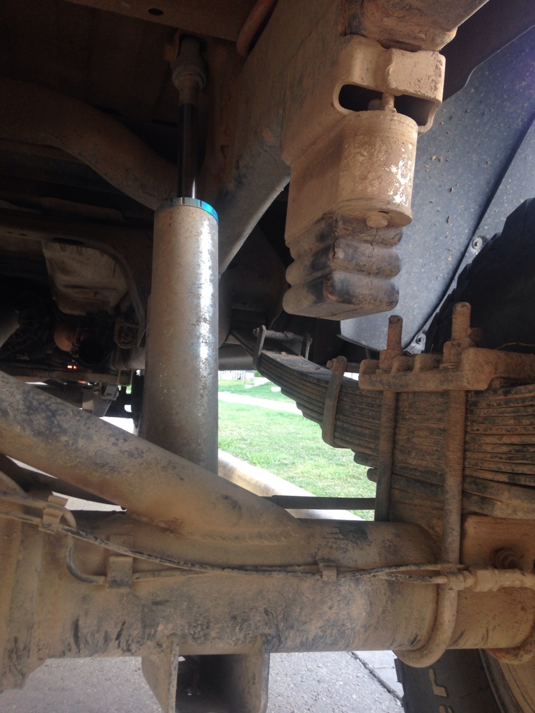

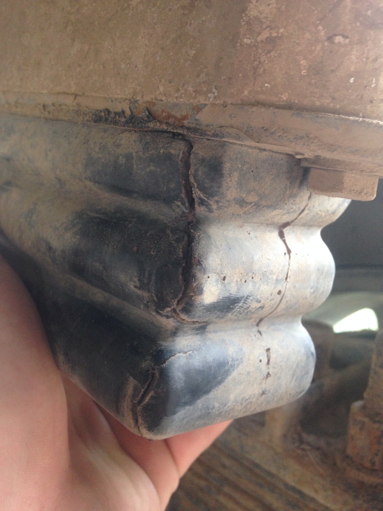

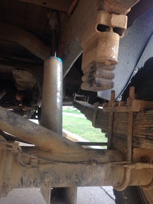

On a side note: my rear atlas leafs move the axle alittle further back than factory about 1/2" so my rear boogies have been taking a shit kicking on there back side (they are as far back as they can go currently) and one has started to split possibly from when I hit that ditch lol it hasn't split a lot just a bit tho.... So I will be making a plate for them to better distribute load like the fronts have.
