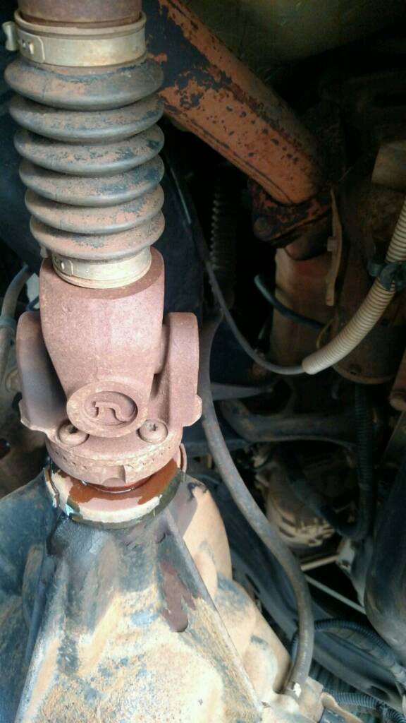

I thought my front pinion has had a seep but think I just realized that when you spill a little oil on an oil change, it'll follow its way all the way down and drip right on the pinion. Haha pretty sure I've spilled some in the past.
Re: 2010 Improvements
Yup dealership told me mine was leaking and I asked if they cleaned up their mess from my free oil change. They said yes they had. I said okay so do it I have a lifetime warranty. They called me back and said it was a mistake the guy dribbled oil on it when he did the oil change. I said yup I thought so and went down to pick it up. F-ing crooks I swear!Will wrote:I thought my front pinion has had a seep but think I just realized that when you spill a little oil on an oil change, it'll follow its way all the way down and drip right on the pinion. Haha pretty sure I've spilled some in the past.

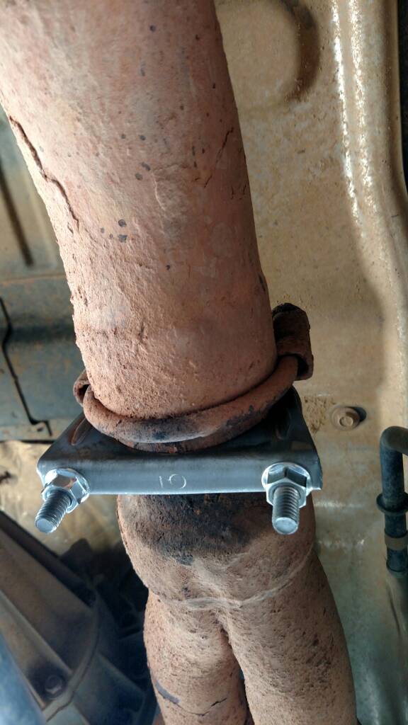

Finally took the time to figure out what the hell was rattling on my exhaust. The joint where the extension pipe meets the Y pipe was loose and everything from there back was slipping forward and backward and twisting. $4 clamp and its all good again. I plan to replace the Y pipe and install a new muffler but I'm too busy right now to deal with it. My welder is in storage and I'd have to take it to a shop.
