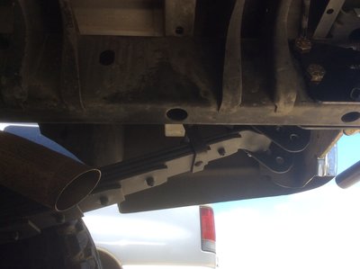

Boogie wagon take 2

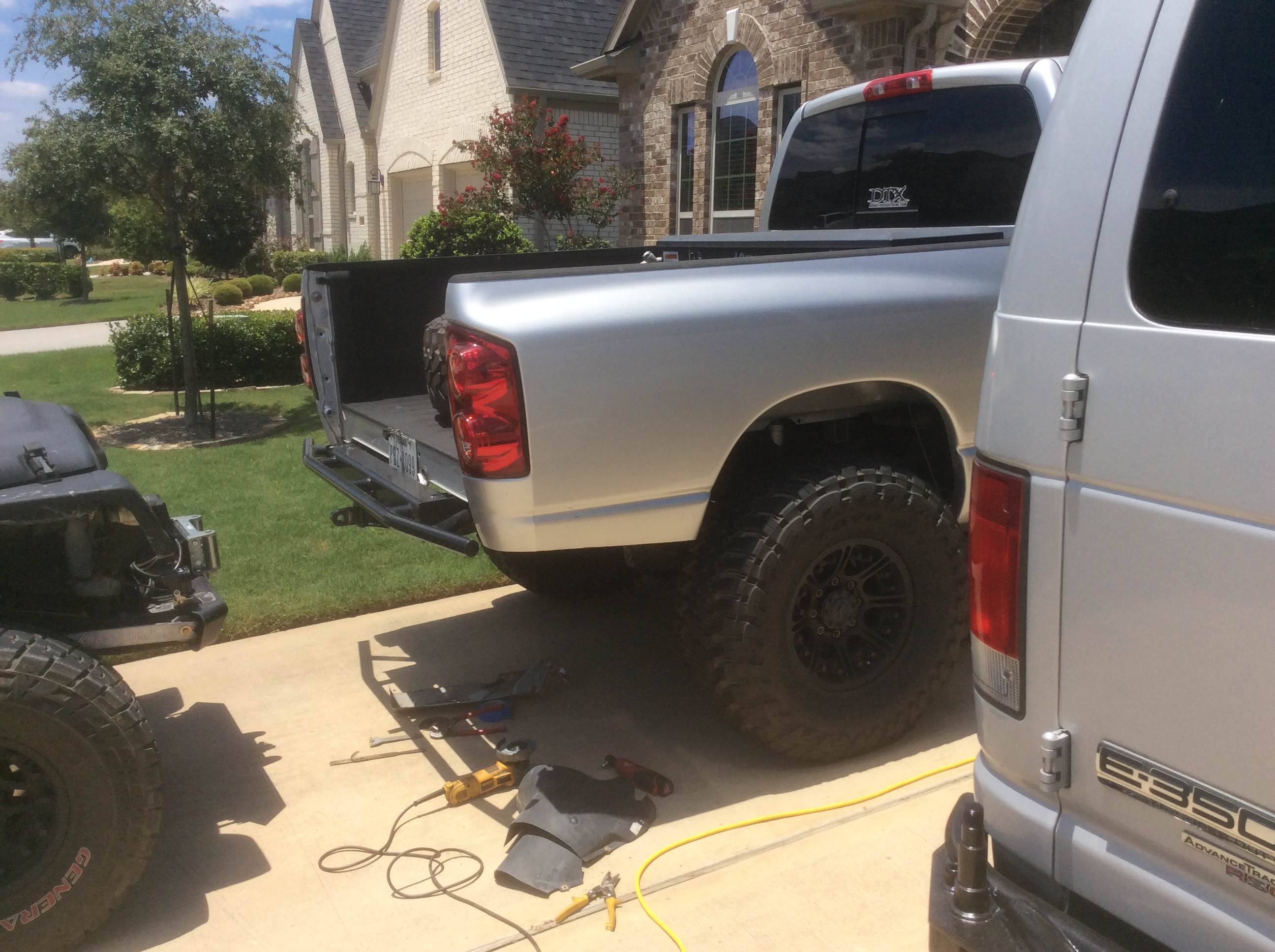

I'll get you some shots in the wild soon sir!MikeKey wrote:I want to see a whole picture of this boogie wagon and not just close ups :p

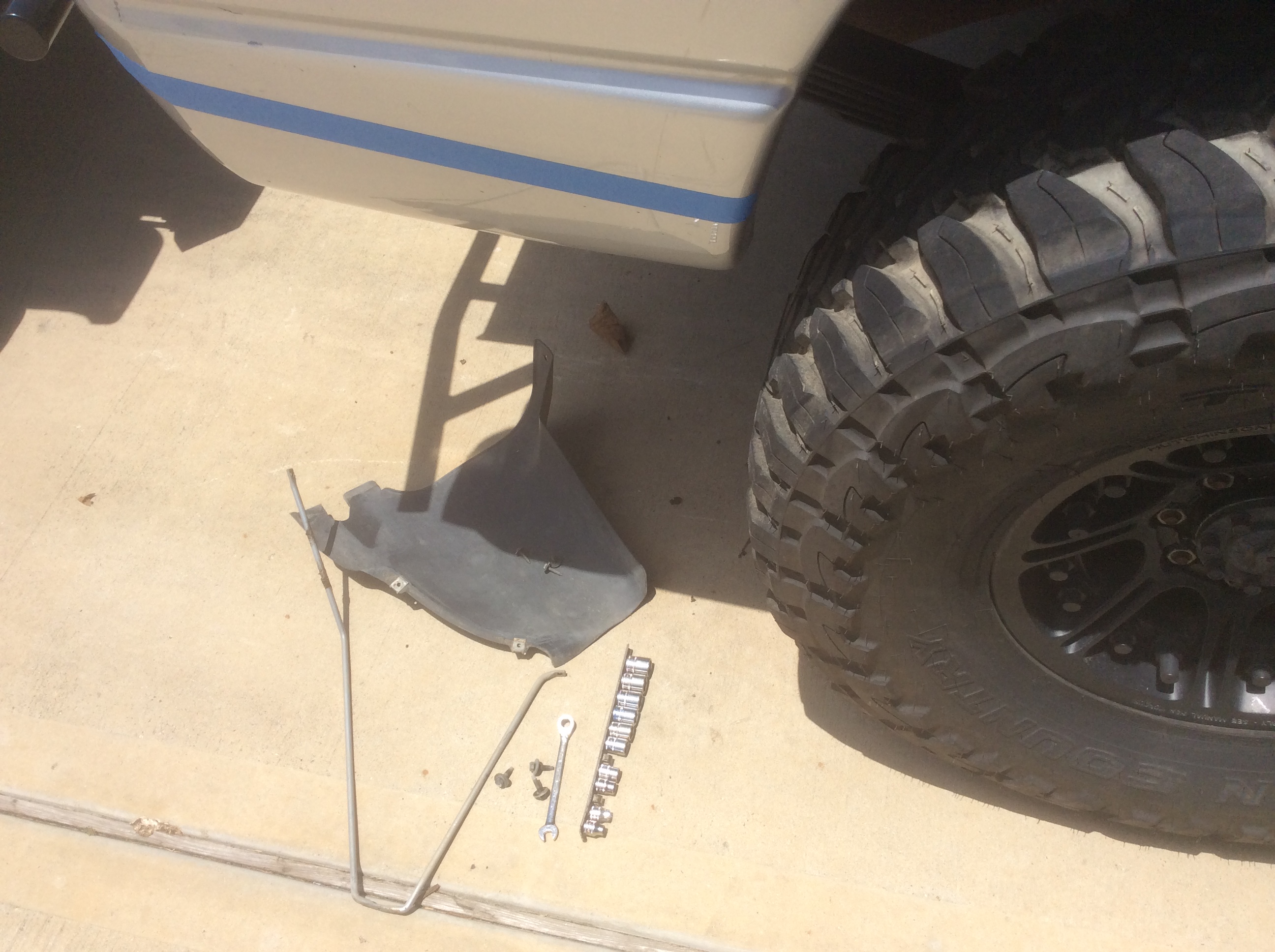

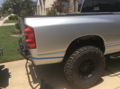

In the meantime, I finally got around to cutting the bedsides. Not too bad a job really.

Those aren't Thurens LT leaves are they?
Re: Boogie wagon take 2
Looking good.
Thank you sir.
Nope, just standard Carli leafs. Very tempted by the lt thuren springs though
