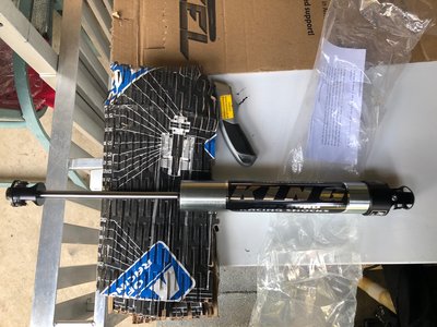

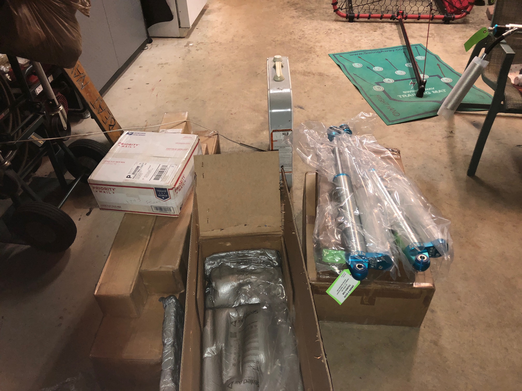

Received all the Thuren 2.5 extreme parts finally. The shocks took about 8 weeks or so to arrive. I ordered the shocks mid-May, then ordered the rest of the kit end of July. Everything trickled in over the last week. Also received Marcus (DAMAGEWAGON) trans-skid a few weeks before (see landing page for links to all). Installed 12" wide x 8mil 3mm vinyl on the shock bodies--sort of a pain in the ass. But living in salt central, I'd like the shocks not to look like Neal's Carli's after one winter. pics coming..... :cheers:

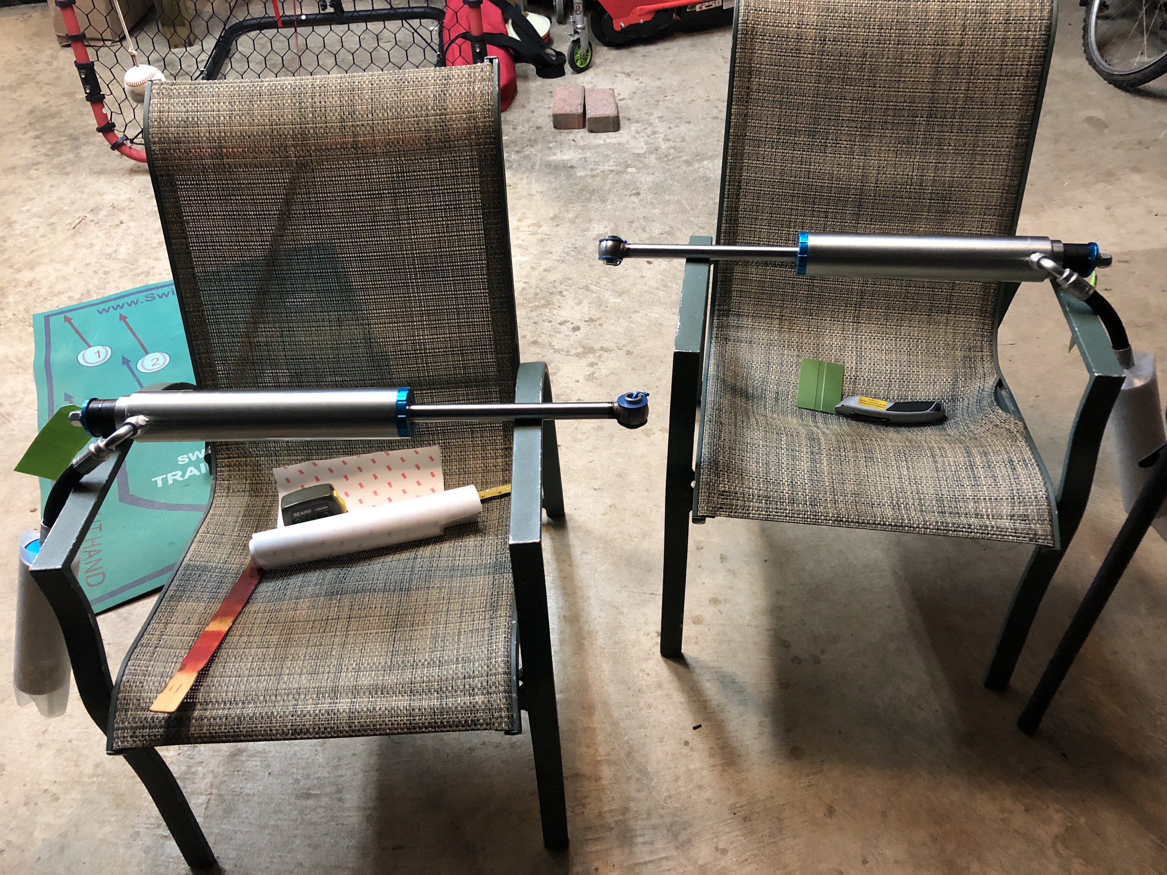

Complete Thuren 2.5” Extreme kit + front boogies & shock boots
Front 2.5 Kings, added 12”x 8mil 3M vinyl to shock body...need about 2” overlap strip for complete coverage.

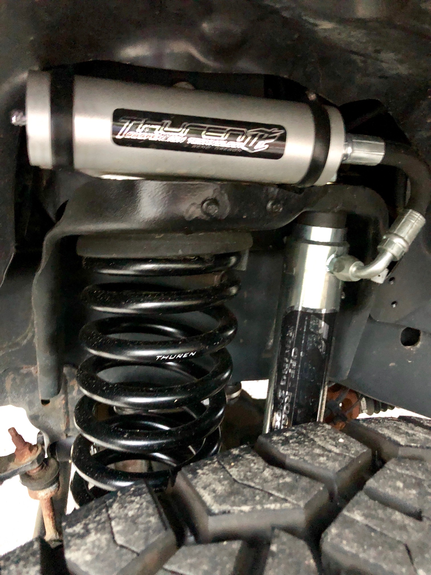

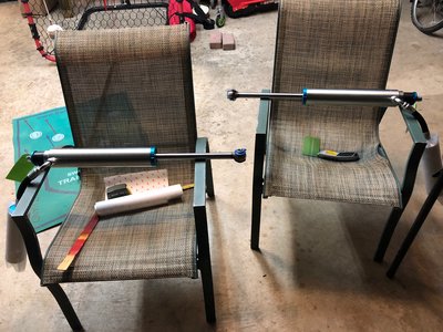

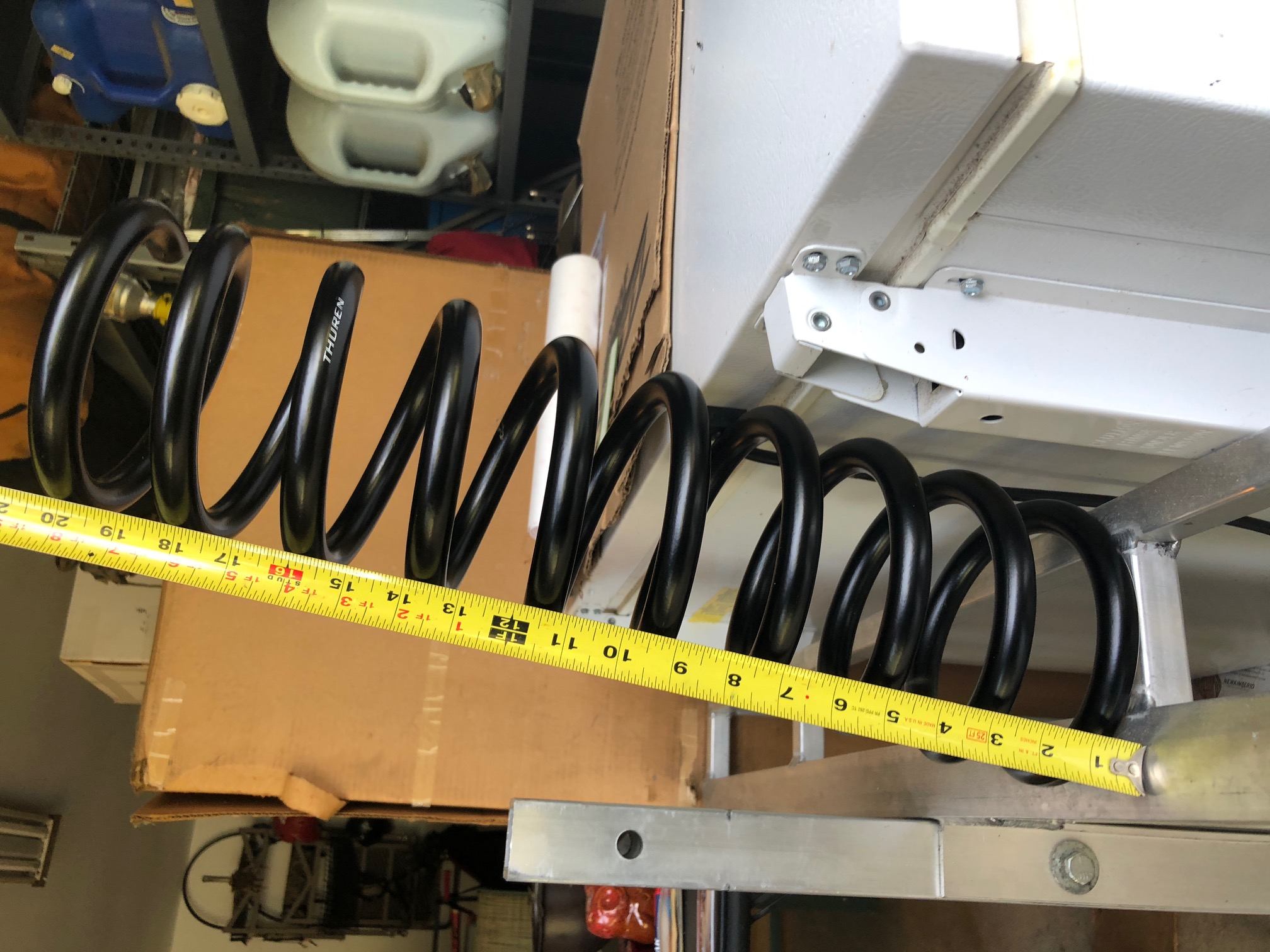

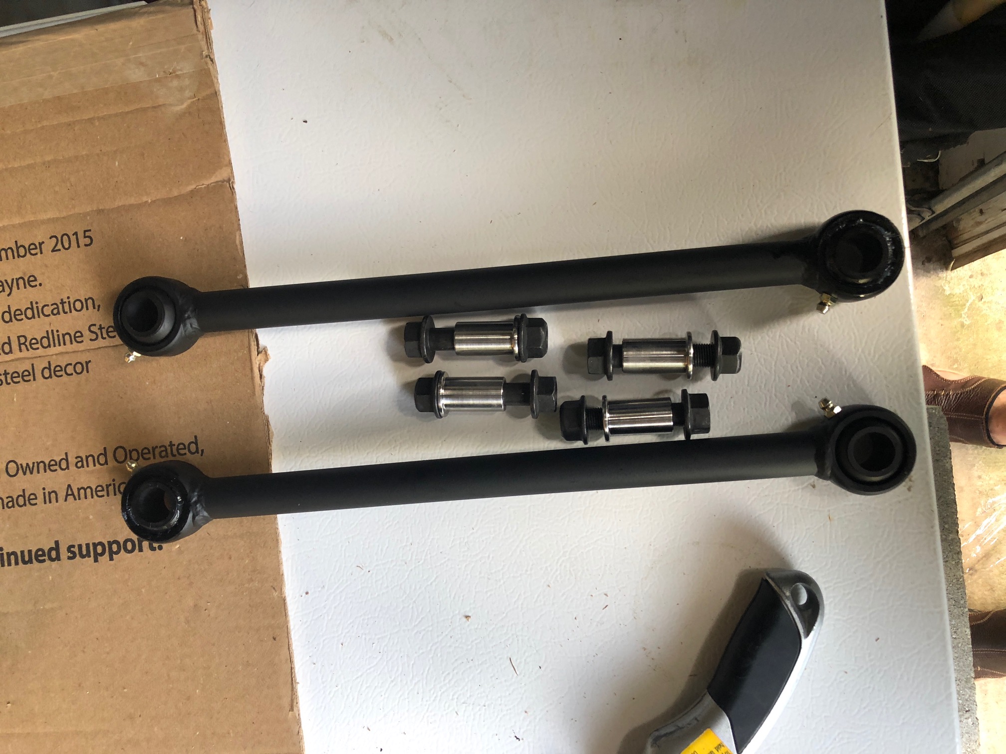

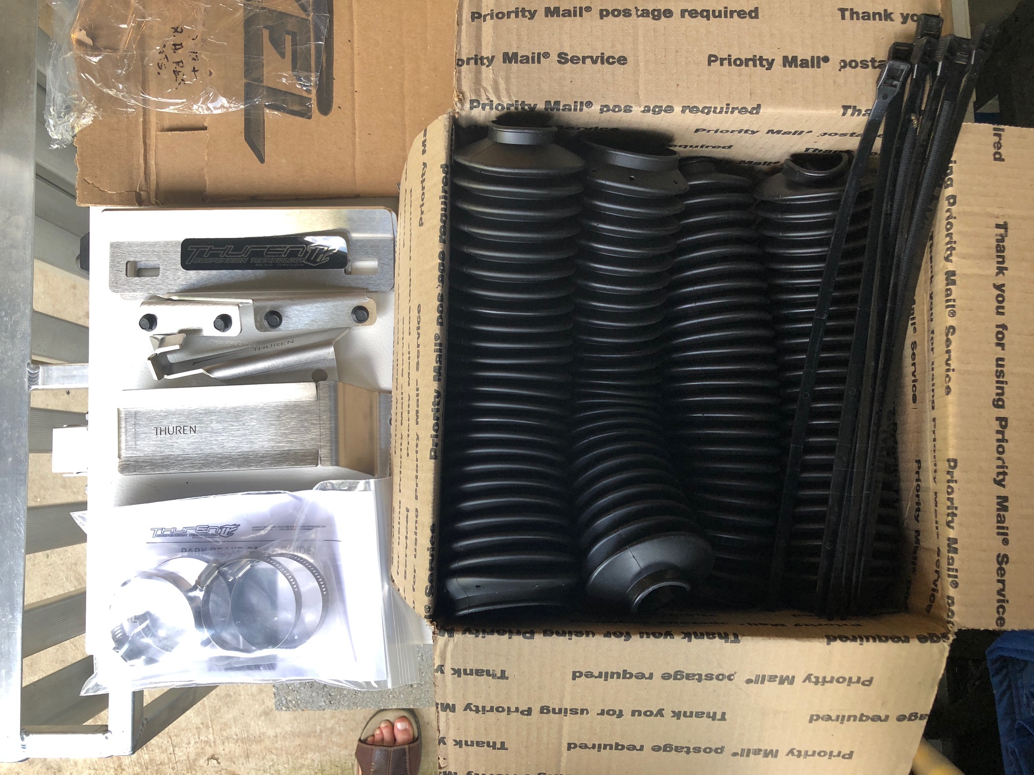

Some pre-installation pictures
Shock boots and resvoir
Steering stabilizer after wrapping with 3M vinyl
Front shock—notice the lean, it’s why they look catawampus in your truck

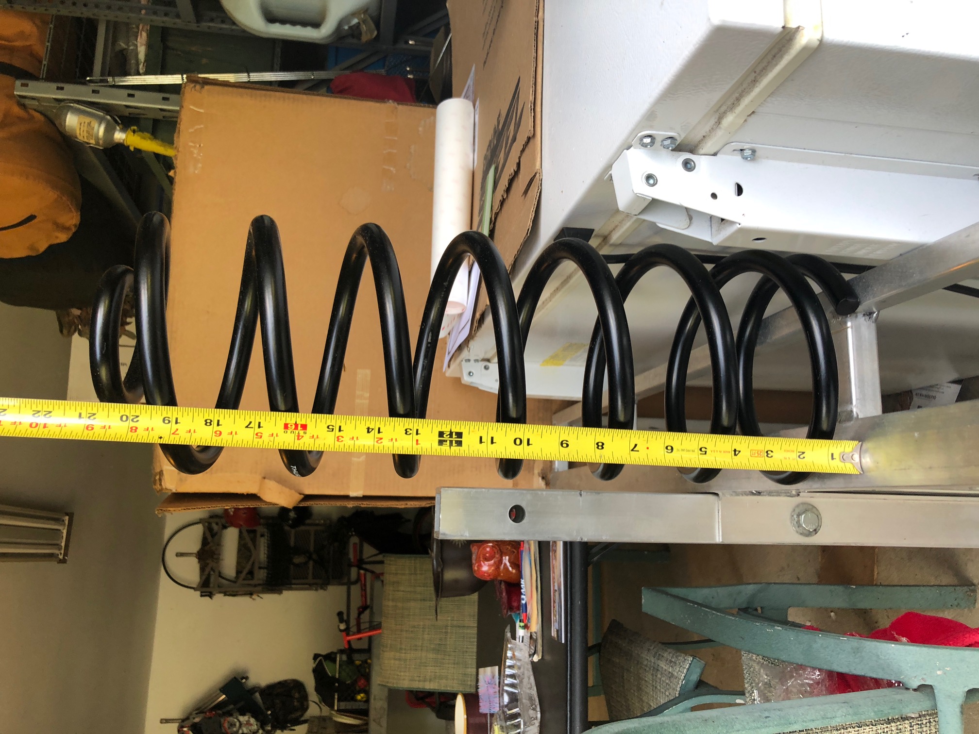

Rear coil, straight, and bigger OD diameter, smaller wire diameter

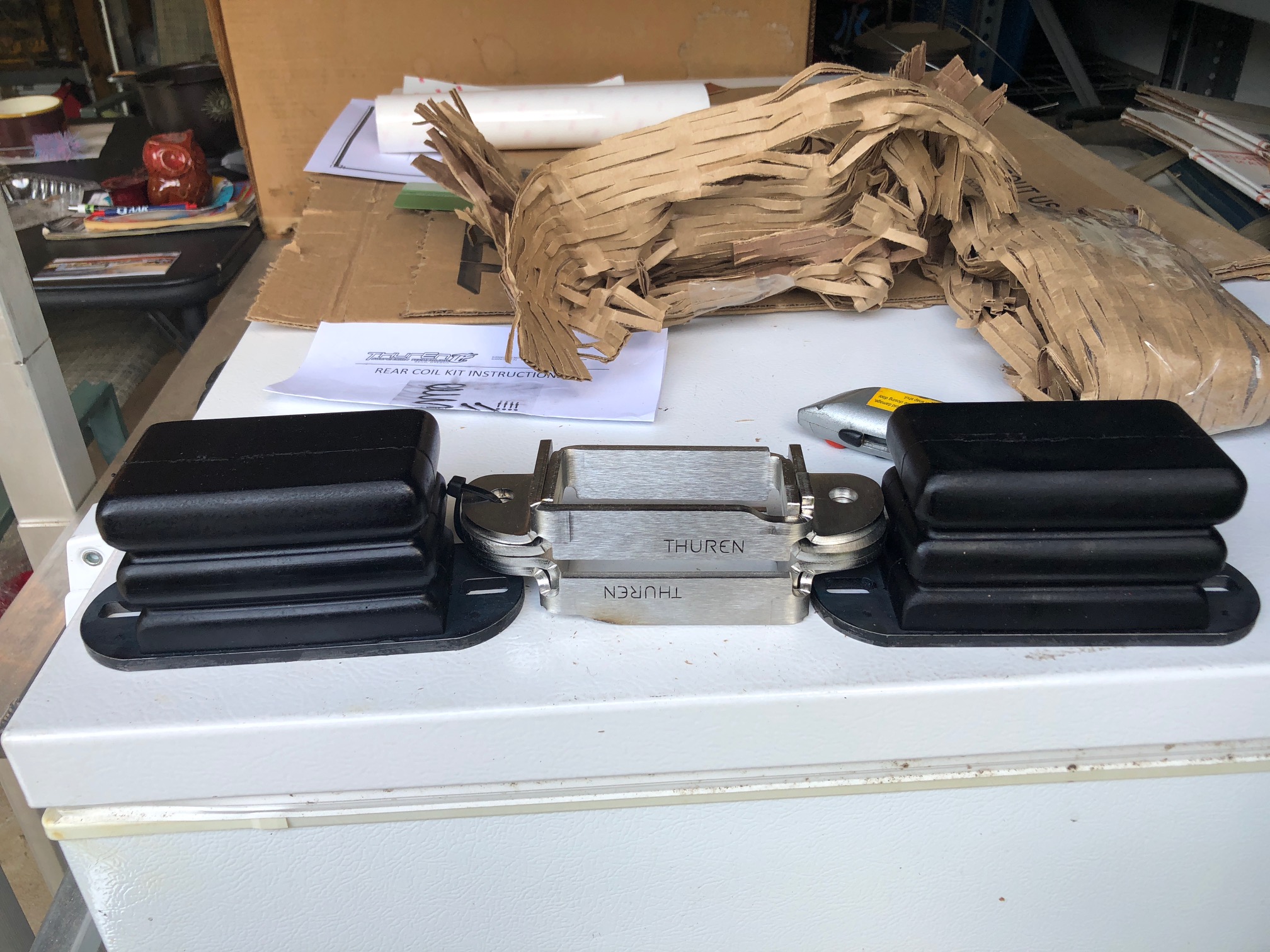

Rear King piggybacks after 3M vinyl wrap

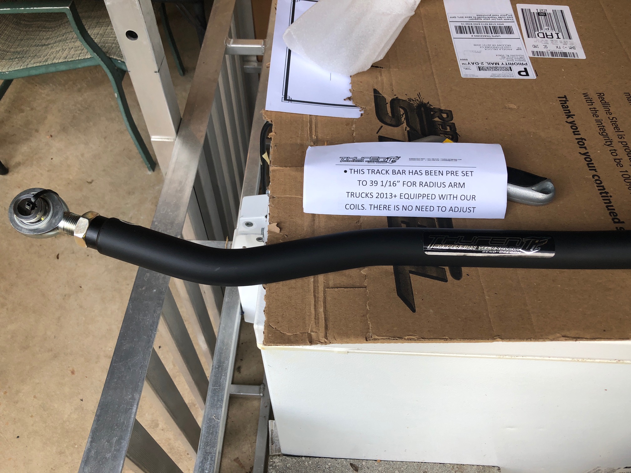

Rear track bar

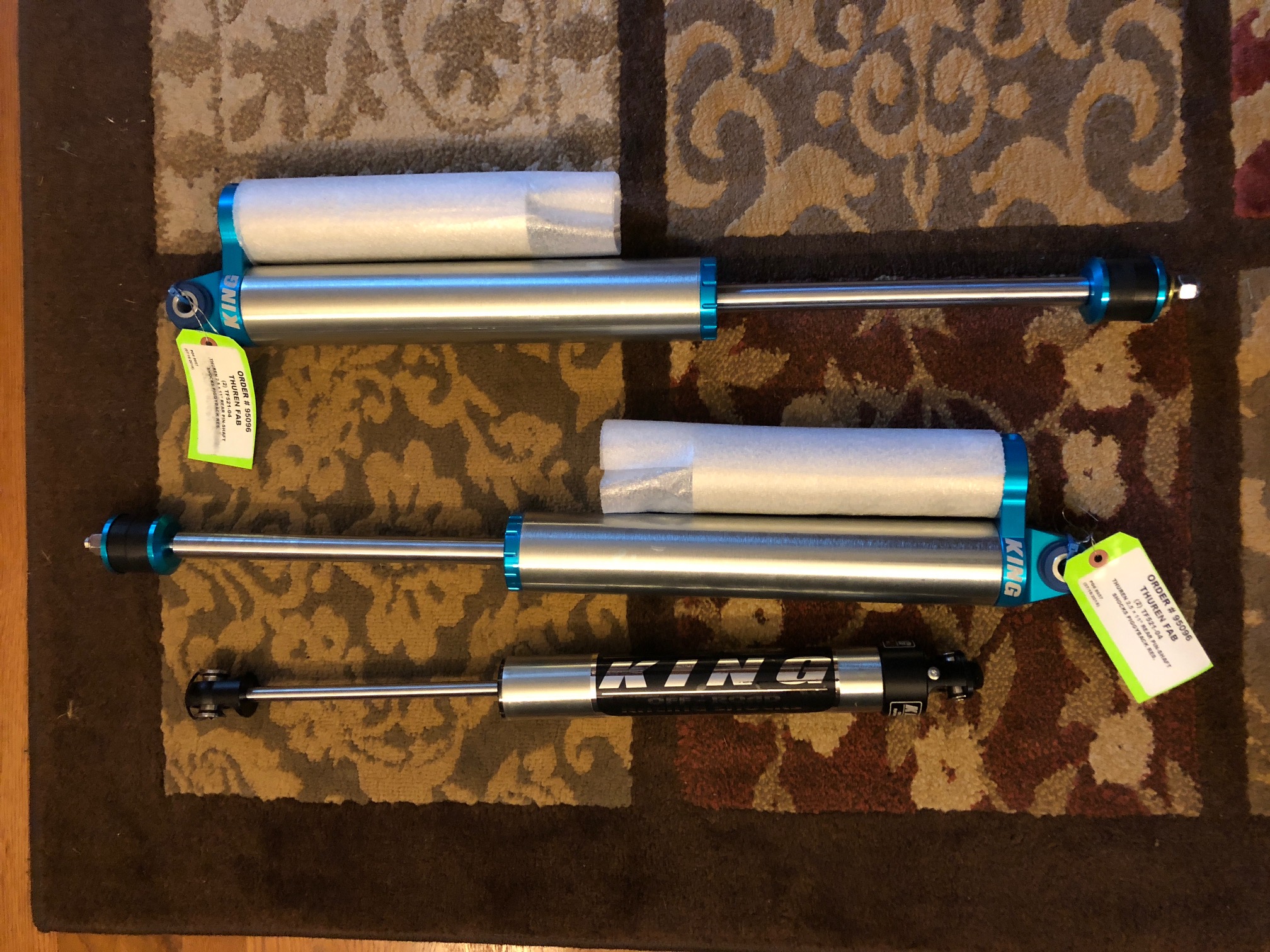

Front Kings

That’s an impressive pile of parts! Going to feel like a whole new truck. What stage valving did you opt for? Apologies if you said already, I looked but didn’t see. You may have issue with driveshaft contact on the rear skid plate crossmember as the rear droops out, something to check for on installation. Can’t wait to hear your impressions!
The new shocks are internally limited so he shouldn't have contact with the cross member. The gas tank skid at the rear corner can be a problem though so watch for clearance.

Hey sir---I ended up going with 3/3--couldn't decide, so went in the middle. At some point, if I get ambitious again and head to Oregon, I'd have Marcus put on the Thuren truss and send the shocks to Don and have then set to 4 and 5. I did not opt for the extra 2" travel in the rear shocks and the corresponding longer links, thus no need to notch my cross member...which is precisely why I didn't opt for the extended travel. Install is going slow, painful, taking longer than expected.

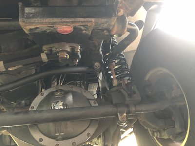

Post by adeluca73 » Sat Sep 08, 2018 1:52 am
Took 14 days to complete a little each night, was not super fun. Pretty straightforward, but it is a pain doing this on your back, in the dark at night. Had passing help from my 11yr old, wife and a neighbor during certain parts. Good thing the PW is not my DD. Took it in for an alignment after, the shop f’d it up, have to bring it back.

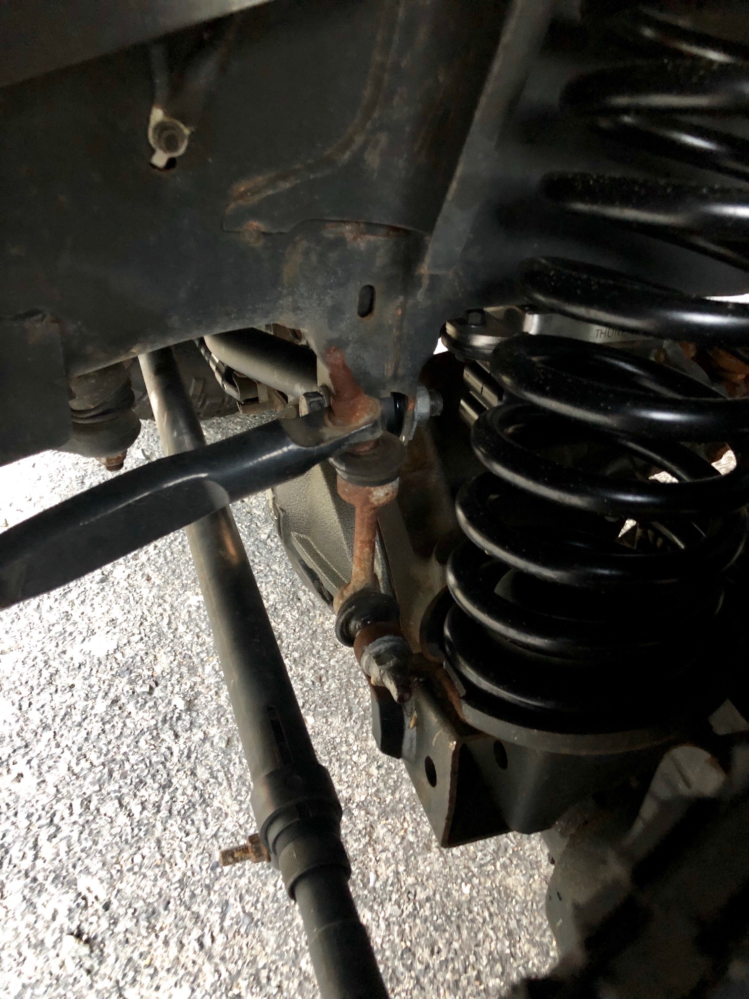

Front shocks
End links shot

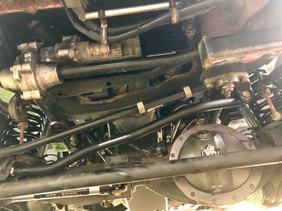

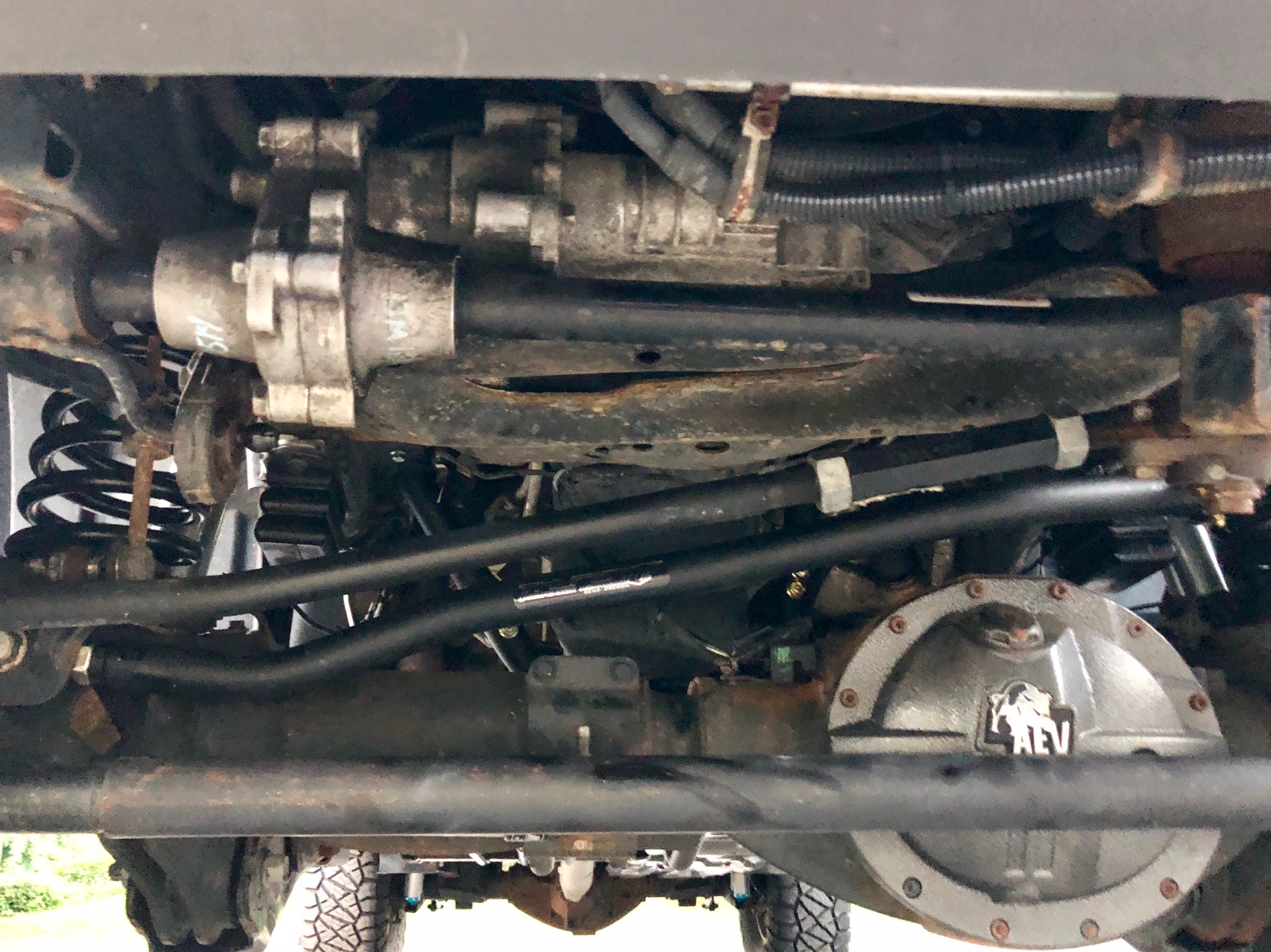

Alignment

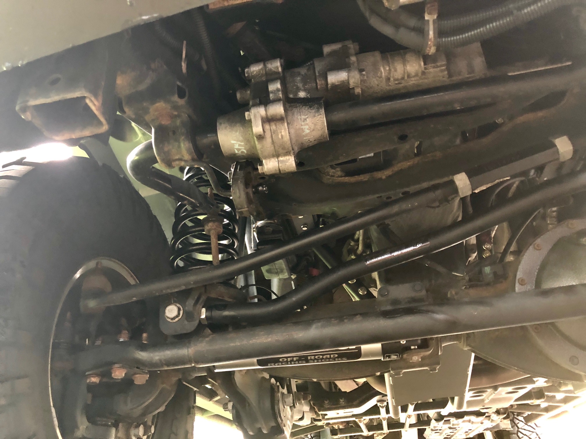

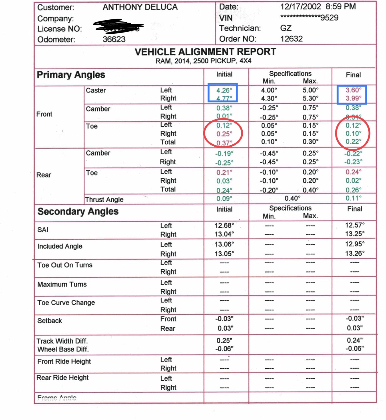

Post by adeluca73 » Fri Sep 14, 2018 2:05 am
Got the alignment #’s, looks like they missed hitting Thuren’s recommended numbers for Toe & Caster, gotta bring it back...thanks to Marcus for catching the cross-caster. He sebt this link to Thuren’s recommendation: https://www.thurenfabrication.com/tech/ ... dling.html
Toe and caster are off

Post by Low_Sky » Fri Sep 14, 2018 1:12 pm
My truck handles great aligned to Don's numbers. Hopefully they get it right on the second try.
