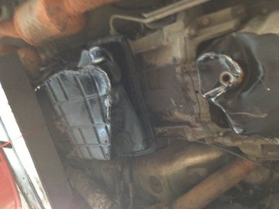

Thanks. Yes. As soon as we get the new parts in the mail (ie: oil pan, Tranny pan) Staying stock as I try to do. I will be building the front half of the skid ... The rear skid is built with 1/4" thick steel and spans the entire back half of the vehicle. It is stout as shit, and has taken a BEATING.... During the build, I was going to build a front skid, but thought to myself "there is no way a rock is going to find its way behind my front axle, and infront of the rear skid, TALL enough to hit my f$%KING oil pan" LOLOLOL
Here is what happened: I was challenged to conquer a rock strewn' hill that is basically vertical and about 200ft long (straight up) with a 2' ledge covered with rocks on the top. I saw 2 rock bouncer buggies hit it, and they both struggled but made it!!!!! I had a few beers in me at this point, and I looked down from the top, and said F it,,, I am doing this. Knowing I was not going to make it, at least I wasnt going to pussy out and not try it. So off I went and believe it or not, this damn truck made it all the way to the top (but not to the top) I was 3 tires on the ground> the passenger side front was up in the air about 4' > the truck was basically vertical> and I just could not make it over the top. I would back up 3ft and go for it>>> back up and hit it with everything she had, even feeling as thought the rig was going to come over and flip backwards>>> But every full throttle assault I did, it seemed as though I was almost there.
The 3rd attempt, I backed up 3ft (like the first 2 atttempts and 3ft was all I could back up before I went rolling down the hill) THis was a situation where once you are commited, you CAN NOT back down without rolling over> SO If you dont make it and give up>> You have to pull cable over the top. I kept saying to myself that if she would just have enough ass to hit 2nd gear and hold it I would have enough wheel speed to launch over the top and beat this hill... But she would only pull 1st, and it took a while for it to hit the rev limiter.
So here goes. I hit the button to open the NOX bottle>> Armed the ZEX system, and purged it.... (Just an FYI, I have not yet done a NOX spray from a lower RPM at WOT, so I didnt know what was going to happen, But I needed everything I could get at the start of the Rev to have it hit 2nd gear to beat the hill) So I hit the throttle and instantly the NOX started blowing through the system, went through 1st gear in about 2 seconds, she hit 2nd gear and instantly redlined and hit the rev limiter.... I WAS AN AMAZING DIFFERENCE IN POWER!!!!!! and the truck reacted VIOLENTLY>>> Launching itself off the top of the ledge, both front tires about 5' in the air.... I let off the throttle> and when the front end came down> i landed on a rock right on its belly>> Perfectly in place, to perfectly crunch my oil pan and tranny pan.LOL GO Figure!!!!! People couldnt believe that the truck made it up "bounty hill" as there was a crowd of Jeeper's watching. I was shocked also!!!!
The best part of the story, is I let the rig, Idle down a bit to cool off at the top of the hill. for about 3 minutes then shut it down.(at this point not realizing I have a trickle of oil pouring from my oil pan) . As I walked away (cracked a beer, and high fiving a few of my buddies) the Hemi BACKFIRES (FAWKING LOAD AS HELL) and a poof of blue smoke rises up from the engine compartment. (put yourself in the moment, as you are about 30ft from your truck when it does this, and the thoughts that go through your mind as you approach the dodge to investigate,) We walk over and pop the hood to find that the power steering top had loosened up and dropped oil on the manifold (Maybe too much pressure from the PSC steering) anyways, I will say this SO FAR!!!!!!!!!! Dodge has made one HELL of an engine!!!!!!! This Hemi (so far) has taken an absolute BEATING!!!!!! and is still running>>> I have taken it upon myself to try to blow this engine up to make room for the Stroker 6.1L engine. But am not going to do it untill this engine folds HAHAHAHAHAHAHAH!!!!!

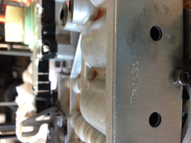

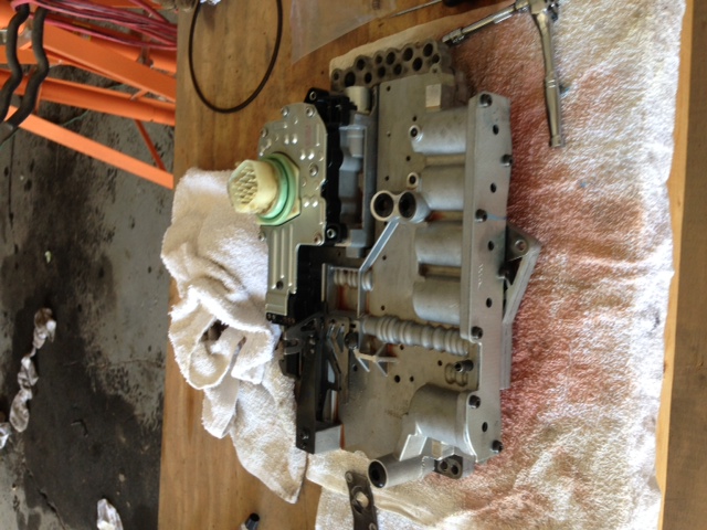

Opinions on the Trans-Go shift kit. Had to pull the valve body and the pistons to get the new parts installed. Messy fawking job, figured since I had to put a new pan on, and new filters and fluid etc.
WOW!!!!!!!! It has completely awaken my transmission!!!!!!! WAY FIRMER LAUNCHES off the light... Firm shifts (but not teeth rattling) NO slow 2nd to 3rd shift, and INSTANT throttle response for downshifting... and NO slow OD shifting, It is a FIRM shift from 5th to Overdrive. DEF WORTH THE $49.00 for the kit!!!!!!!!!!!! Feels like it is a fresh transmission!!!!!!!

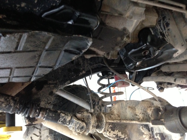

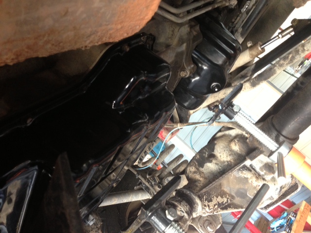

Finished everything today including the Front skid for the transmission and the oil pan. Just didnt take the "final" shots of the "bolted in" to the front crossmember. Made of 1/4" thick steel with supports and holes cut to drain both the Transmission and engine oil pan.

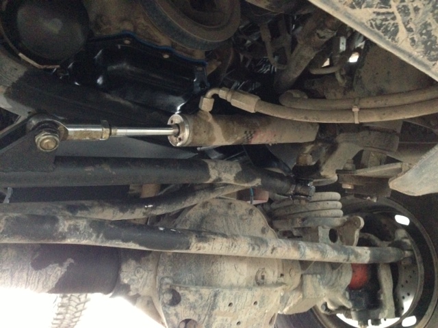

Also, I wanted to include some pics of how we installed our PSC Hydro steering used with the Thuren Steering kit. This was difficult to design and incorporate BUT WAY WORTH THE TIME.. If you install it just like these pictures, you will be golden and get the ram out from being in the dirt.
