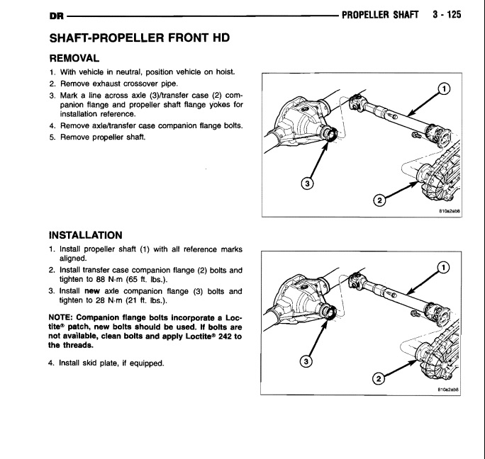

on my G56 the driver side has a black tube like attachment that is bolted to the housing and leads to a metal tube that then goes into what i think is a wiring protective sleeve( black corrugated looking hose that you seem to find protecting the rest of the wires.) i want to know what this does, i suspect it is related to the reveres sensors, but i am seeing a bit of seepage of fluid out of it. no where near what the mess was from the shifter boot but you can see that there is an interesting pattern of dirt and fluid more on the metal tube leaving the black plastic part than around the attachment to the transmission housing. so what i need to know is what that part is called and or if i should be overly concerned about trying to get it fixed any time soon.
Second questions front drive shaft. I want to pull it and inspect it and properly grease the double cardan joint but i cant find the torque specs for the reinstall any place. Also what i have been finding is improper information for what bolt size is on the trans side of the drive shaft. What i have found is it was supposed to be 15mm but that i'm finding is too small i think its 9/16's but have not had a chance to verify. any reference to the info and or gotchas also would be appreciated.

The first component you're describing sounds like the slave cylinder. Here's a picture from the FSM:
The torque specs for the front driveshaft are, 21 ft. lbs. at the front axle end and 65 ft. lbs. at the T-case.
The bolt head size at the T-case is 16mm or 5/8". The bolts at the front axle are a T-40 Torx and are a royal pain to remove. I would replace them with ARP #671-1004 bolts to make life easier.
