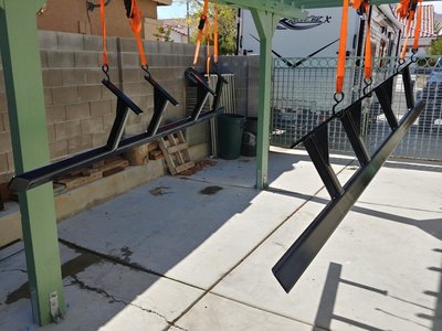

Nice. If you need any dimensions, let me know as most are still fresh in my mind.
All and all it took 2-3 guys about 10 hours to knock out the sliders. Figure another 3 hours for the steps and a good 4hrs to paint (includes dry time in between coating).
I can't stress the importance of a 220v welder. We tacked everything with a 120v Hobart that was rated for 1/4" but it couldn't burn through. When we went to use the 220v Eastwood MP200i it made all the difference.
Will post pics when I get them painted and mounted.

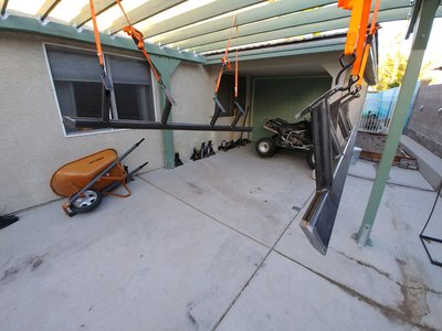

Made a little progress this week with my makeshift paint booth, gotta use what ya have.

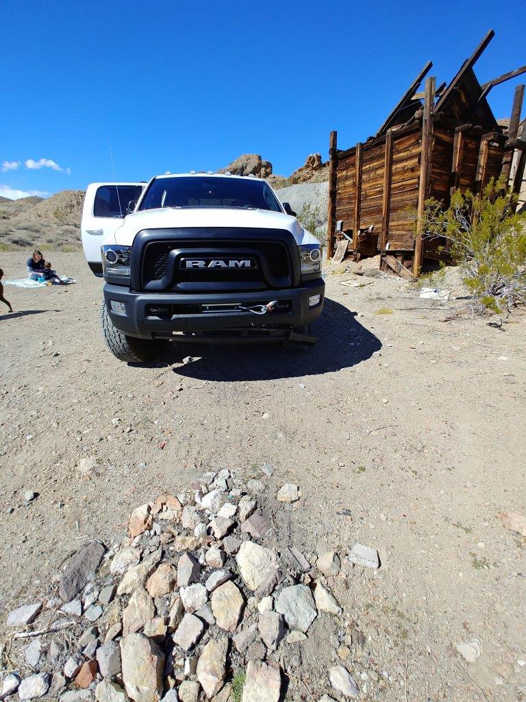

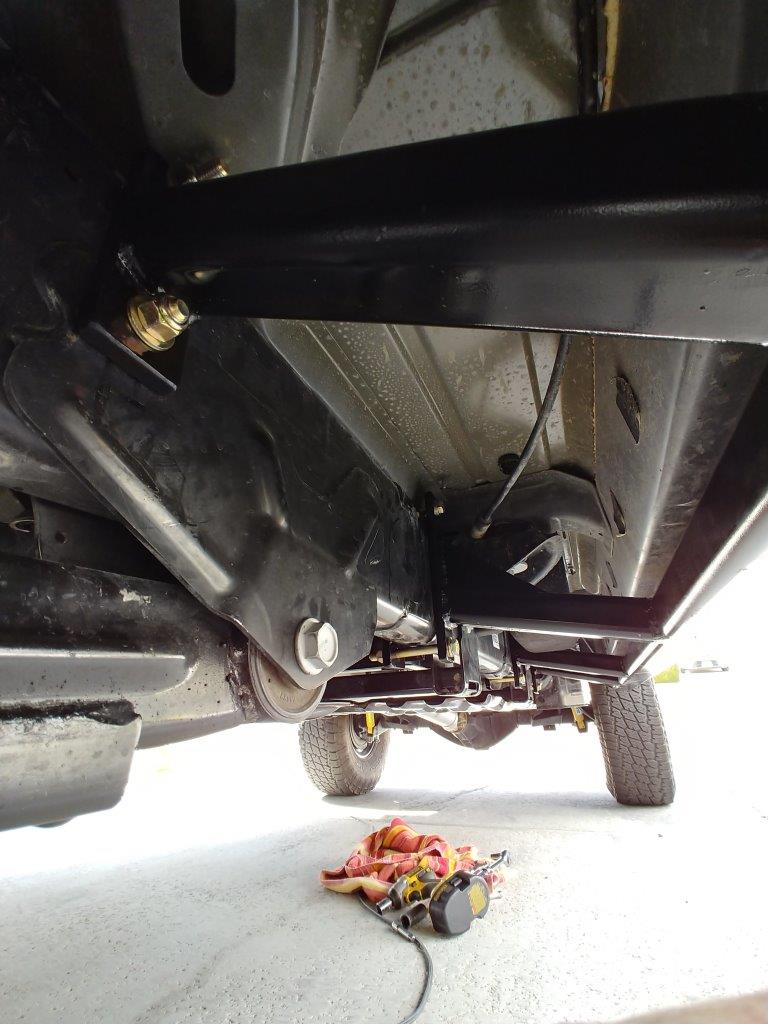

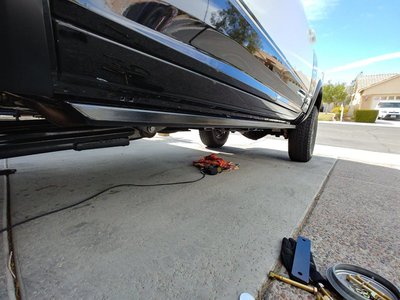

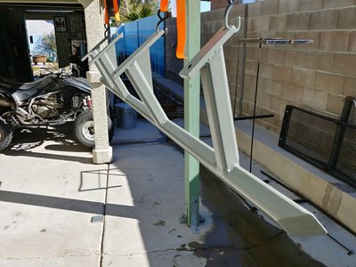

Finished painting and mounting the Rock Sliders
Then tested them out on a very tight old mining trail (Copper Cache)
Ripped off my front bumper valance, dinged up my bumper, and scuffed up my wheels in the process

Sliders came out great! The rock rash is a badge of honor, wear it with pride sir!

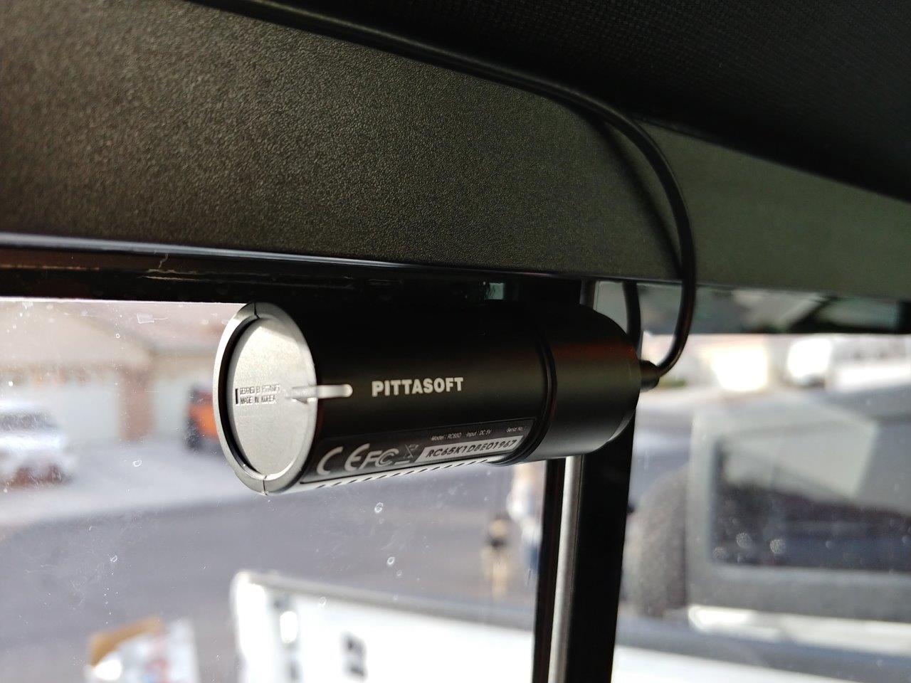

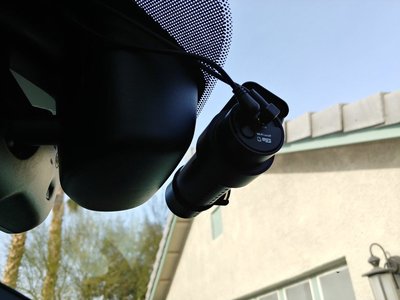

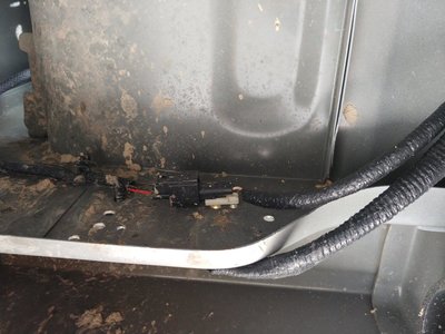

Mounted my BlackVue DR650S-2CH dashcam (front and rear).
Mounted up the 60" Hi Lift in the bed as well.

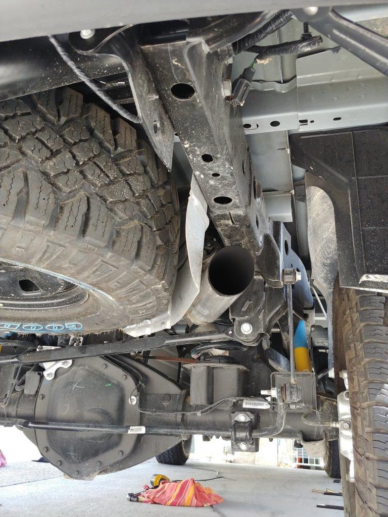

In an effort to reduce the chance of dragging my exhaust, I removed the rear resonator and routed the exhaust to what I thought was a safe place. Turns out your exhaust gets hot, especially when you are towing up a grade and keeping the revs above 4k.
Stupid hurts, and costs. Ended up melting my Park Sensor, Park Sensor Harness, Park Sensor Grommet, Bumper Top Step Cover, a couple wire looms and toasting the paint below the taillight. All in a good $250 in parts if you dont count the paint. Parts are on order and i'll hit the exhaust shop to have them add a dump right behind the axle.
Live and learn!

Re: 2018 Power Wagon, White Rhino
Post by olyelr » Mon Mar 12, 2018 5:16 pm
HOLY SHIT!!!!!
I was gonna do the same exact setup this spring (although "eventually" get a dump installed). Guess I will wait till I do it all at once... thanks for posting that!

Yeah, learn from my mistakes. Shit sucks and I'm hoping it's only the above that needs to be replaced. I'll post up once the parts are installed. I'm getting an error that the Parking Assist needs service and the fronts aren't working either.
The sliders are working out well but the wife keeps asking when the steps will be installed.

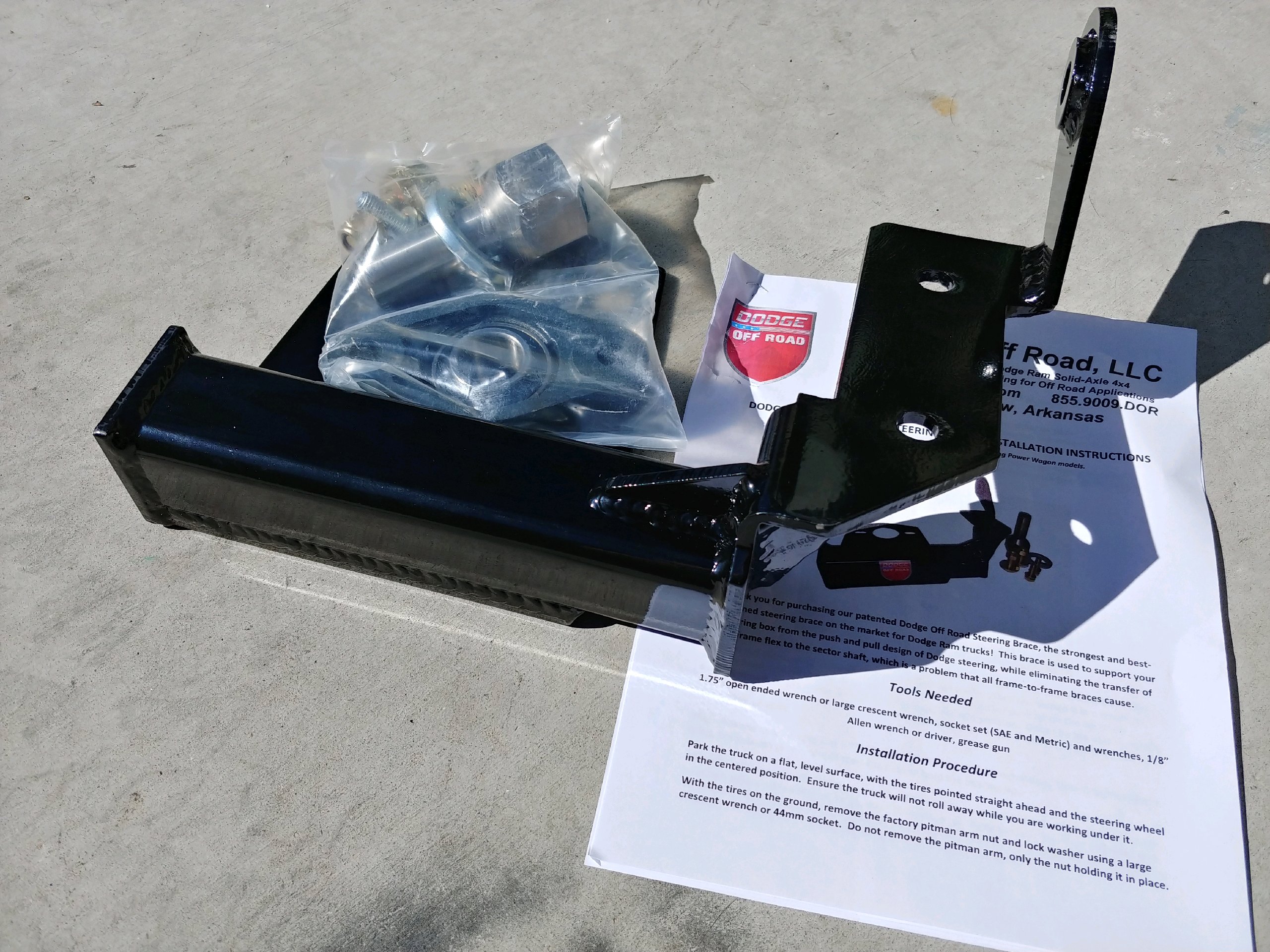

I hear our steering boxes don't like 37s. Hopefully this will help it last more than a couple years.

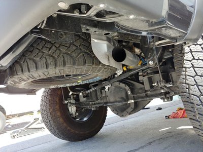

surprised how much you melted the bumper...
that is exactly where i was going to dump mine... you certainly did forget to add a turndown tip. you can turndown and lose clearance. the velocity of the exhaust at 4k would have put that heat directly into the pavement.
you certainly made me more cautious as i look at my exhaust setup. i may tuck the tube and turndown just before the rear bumper.
I think if you add a short tip/extension right where the resonator gets cut off it should be just fine.
I'm with you, thats my plan. Remove the current tip, do a 45 or 90 degree down pipe.
Happy to hear I may have saved a couple guys from a similar fate. I should setup a GoFundMe so you guys can donate to my repair fund. :D

HOT DAMN, literally! My exhaust is chopped just like that, and I've been hauling ass up long hills around Mammoth/Big Bear, etc. loaded with camping gear, no trailer though. I guess I'm going to play it safe and get that re-routed asap LOL.
Looking forward to hearing your thoughts on the steering brace. It's crossed my mind several times when I've been in the rocks or hauling down trails!
It's worth it. It makes a big difference in steering feel.
