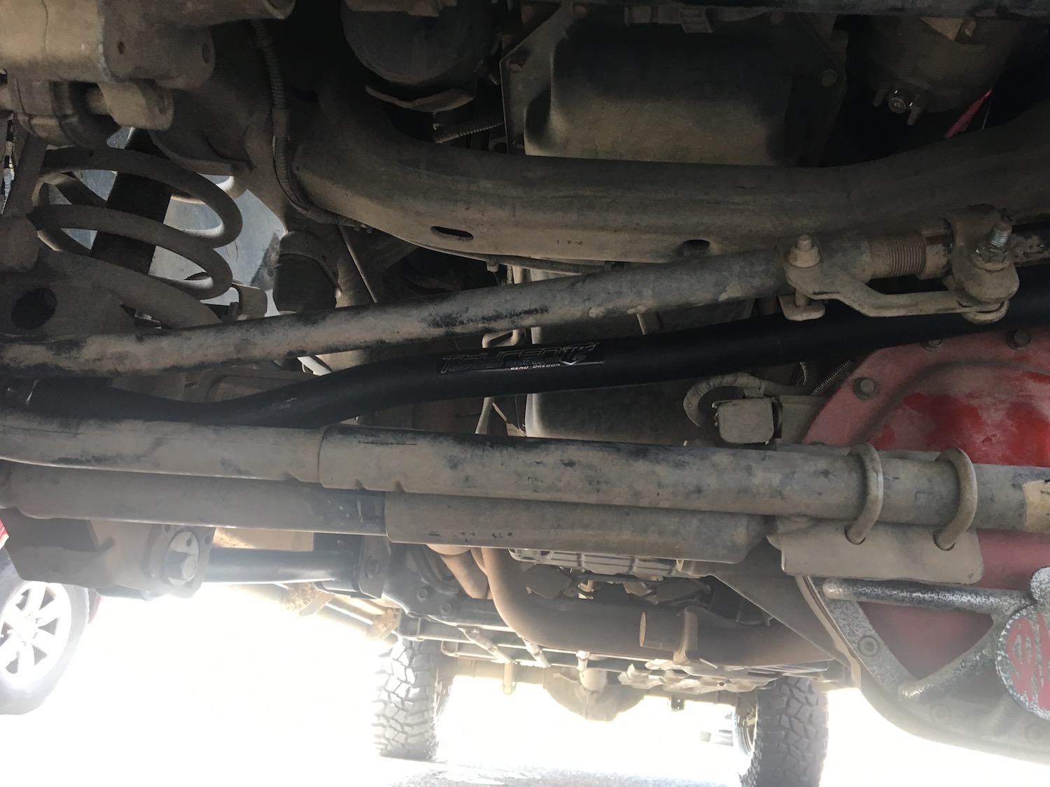

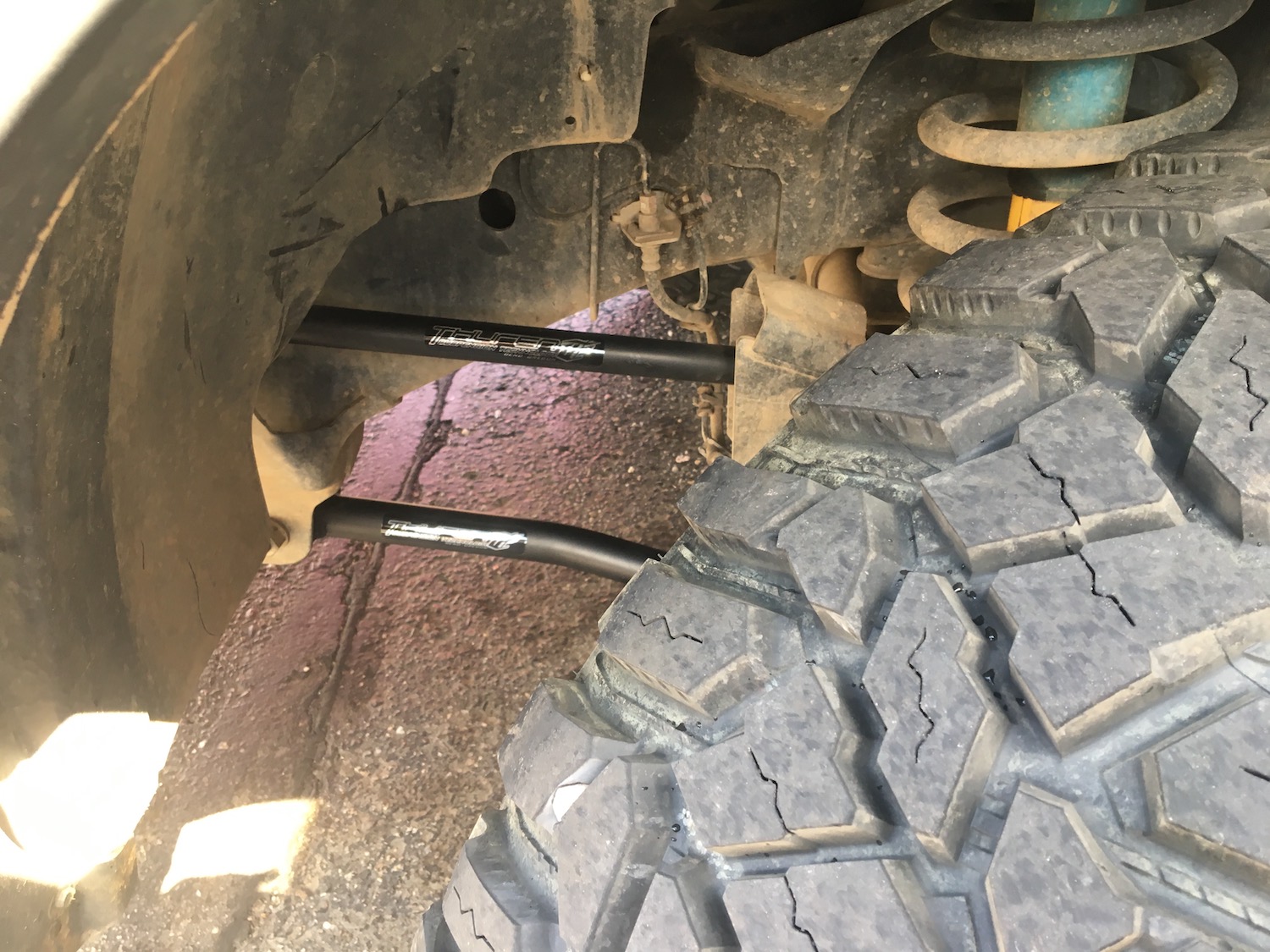

Got the Thuren parts (Track Bar and Short Arms) put on this weekend. Had it aligned to Thuren specs, and the truck is running very nicely. I did not notice much difference in the feel of the suspension, but I have not done any hard driving with it yet. My suspension was not worn out yet either. However, the quality in the parts from the factory to the Thuren stuff is remarkable. These arms and bar are very stout. I think they will be great. No more rubbing, and I can turn as sharp as I want now. Overall, I am very happy with having the bigger tires and the new parts!
Re: 2012 New to Me!
congratulations on the new suspension parts, I think you’ll be pleased with your decision!ghaugo wrote: ↑Sun Aug 26, 2018 10:27 pmGot the Thuren parts (Track Bar and Short Arms) put on this weekend. Had it aligned to Thuren specs, and the truck is running very nicely. I did not notice much difference in the feel of the suspension, but I have not done any hard driving with it yet. My suspension was not worn out yet either. However, the quality in the parts from the factory to the Thuren stuff is remarkable. These arms and bar are very stout. I think they will be great. No more rubbing, and I can turn as sharp as I want now. Overall, I am very happy with having the bigger tires and the new parts!

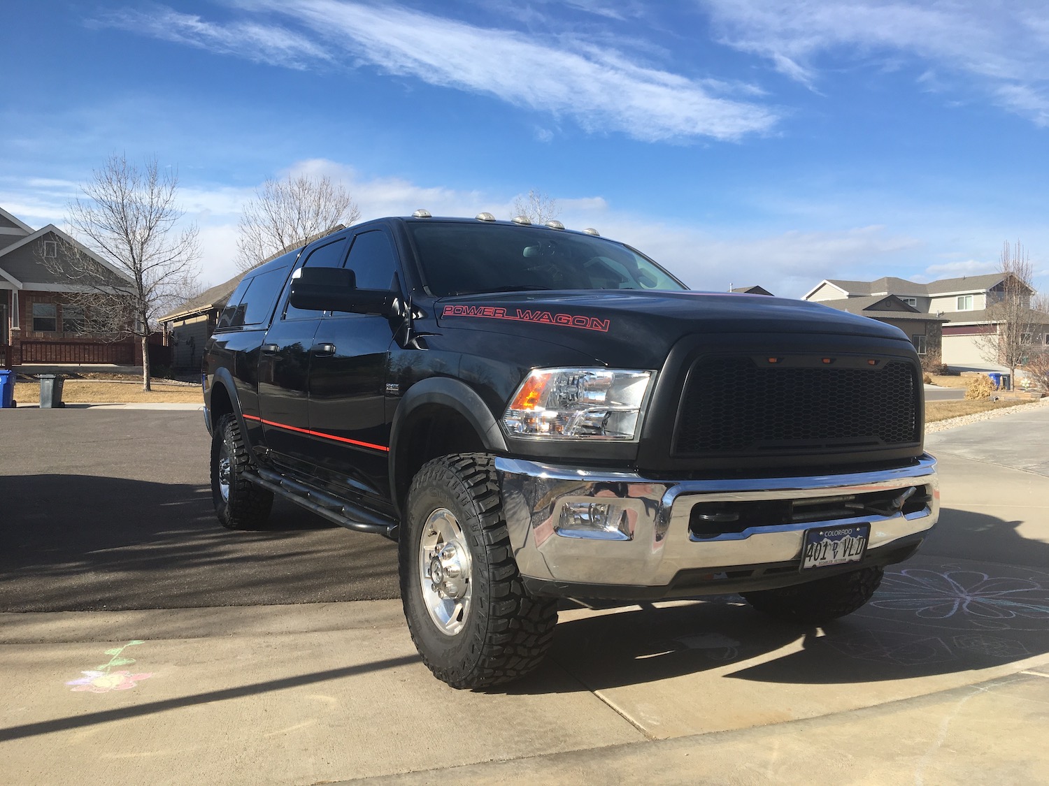

Re: 2012 New to Me!
I noticed the chrome/plastic on my grille started to wrinkle up, so I began looking for a replacement grille. The factory ones were very expensive, so I decided to go a different route. I got it installed and it looks pretty cool....very cool for $149. The LEDs are yellow and they turn on along with the parking and clearance lights. I know it looks a little Raptorish, but I still thought it was a good look and even better price.

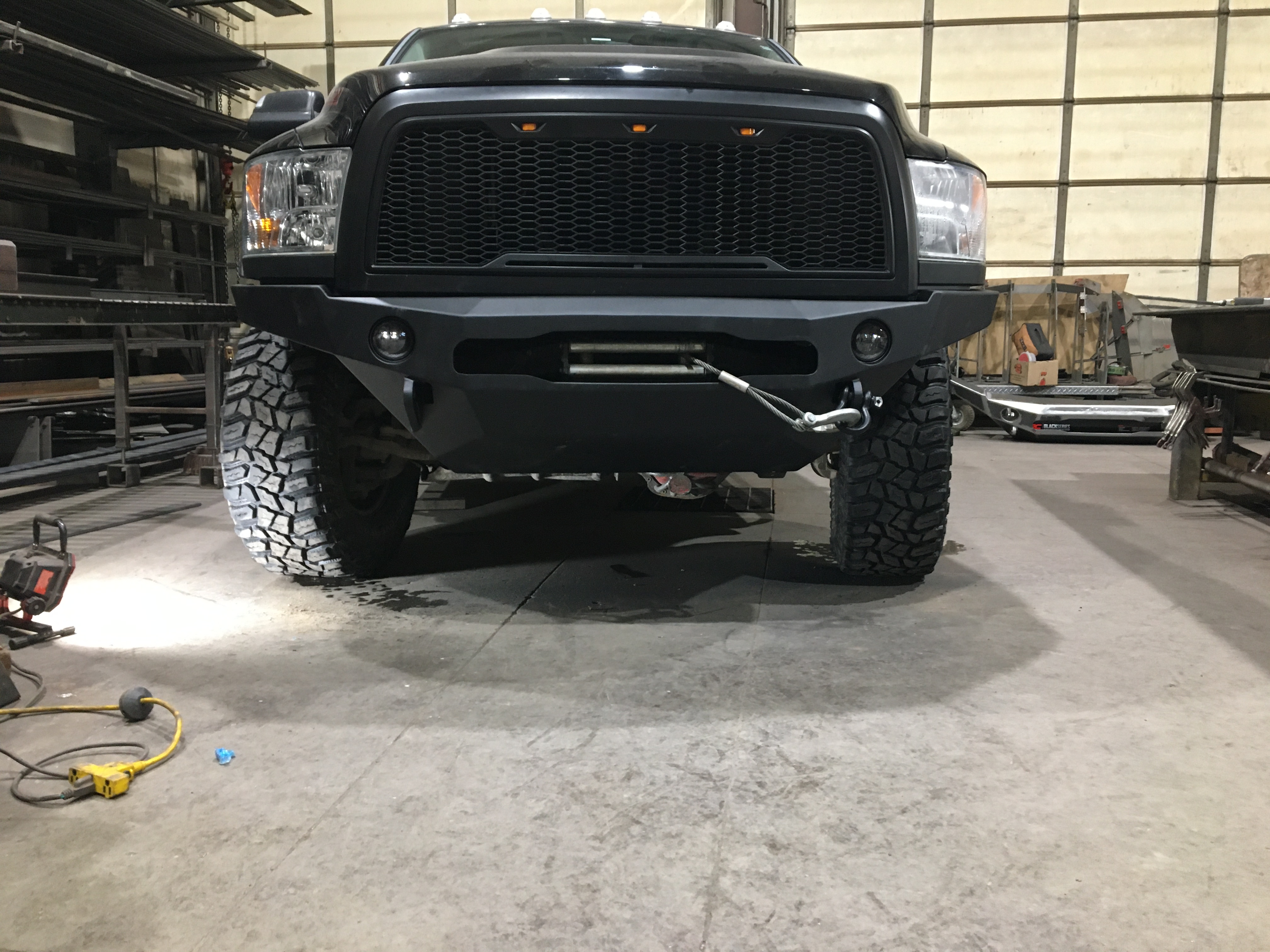

I was able to make a trip to High Country Customs where I met with Ryan (the owner) and one of his employees, Thomas who put on the new bumper. They did a great job and fit me in even though the shop was officially closed for the holidays. I was going to head up last week, but we could not make it work that day. So, I took the 3 hour drive to Gypsum, CO where Ryan was nice enough to get me set up at his shop.

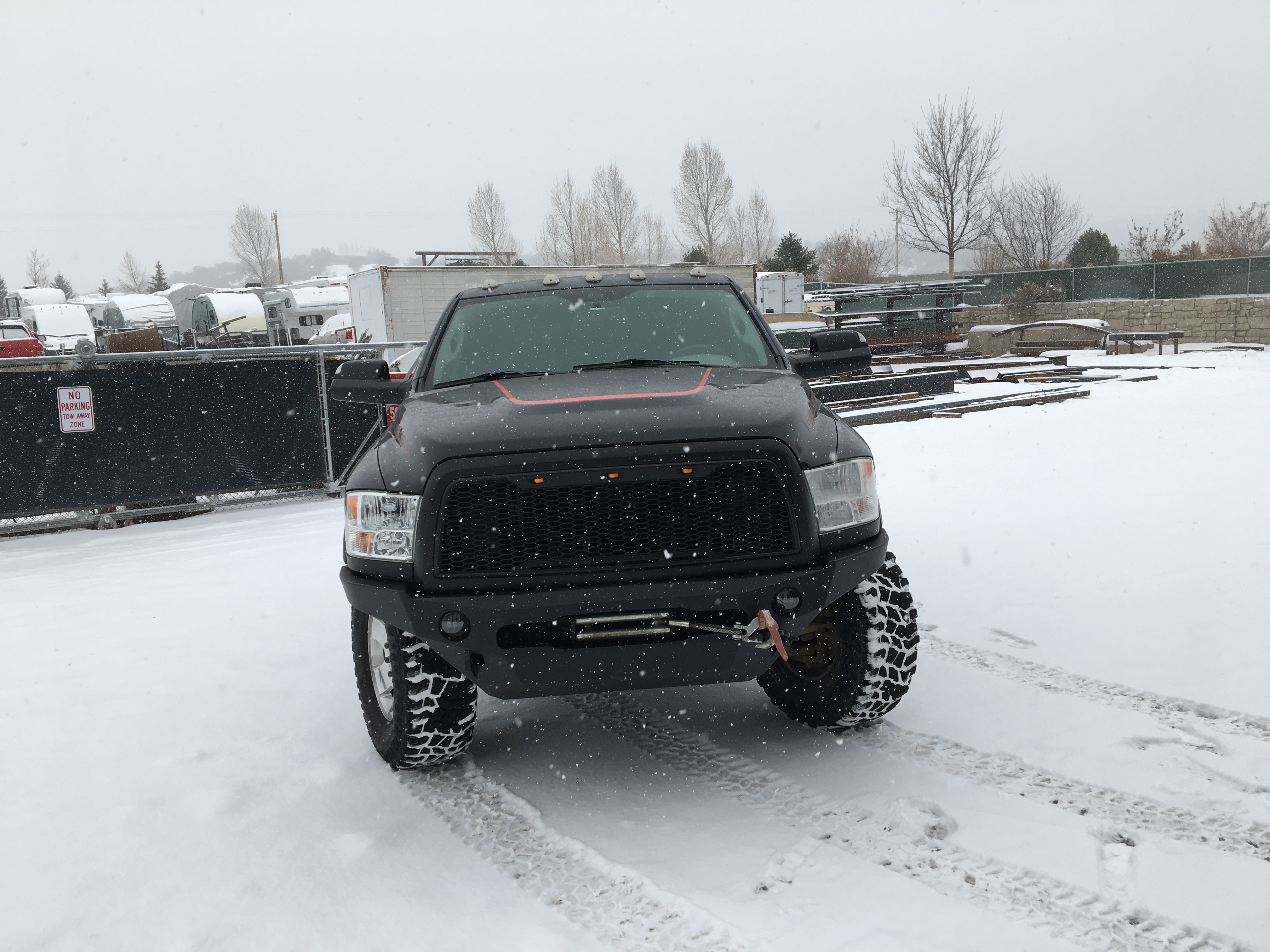

The bumper looks awesome! It is hard to see how nice it actually looks in pictures, kind of like looking at a trail in photos. They just don't do it justice. Ryan has a cool Powerwagon of his own, and he is an off-road buff as well. It was great to see them work, and I tried to stay out of their way. I have a DOR steering brace that needed a small amount of grinding to clear the bottom portion of the bumper, but other than that, it was smooth sailing. The powder coating was very nicely done, and the bumper is very stout! I didn't notice any difference in the front height of the truck. This bumper seems to be built up in the right spots without being overly heavy.
I am very happy with the bumper and the company. Ryan was very accommodating and he worked around my schedule to get me set up! I traded him a set of JW Speaker led lights that he had already mounted into the bumper. They fit the holes perfectly, and they are plug and play which is great.
I am very excited to get a chance to try out my rig with its much improved approach angle.

They started by removing the bumper and taking the bolts out of the winch cradle.
There are 2, shim plates that go inside between the frame and winch cradles. Once they were in, they lined up the holes and traced the outline for the bumper onto the front fender liners. They removed the bumper and trimmed the liners. I would have taken more pictures, but I always forget to get some of each step.
After grinding a bit of the edges on the DOR steering brace, the bumper lined up perfectly. I purchased some JW speaker LED lights which were plug and play for the factory harness. The factory harness was removed from the old bumper and zip tied above the winch once the bumper was tightened down. I was glad to have Ryan and Thomas mount the bumper since I did not have enough hands to do it myself. After watching them, I think I will be able to remove it I ever needed to, but it was nice to be able to see how it goes together.
After we were done, I took it outside and took a drive through the rockies in the snow. I really wanted to take some trails, but my time was running short. I am very happy this bumper is available again. I always liked the ones I saw on this forum, and now I have an opportunity to try it out. Now all I need is more money to spend on my truck that "really doesn't need any modifications."

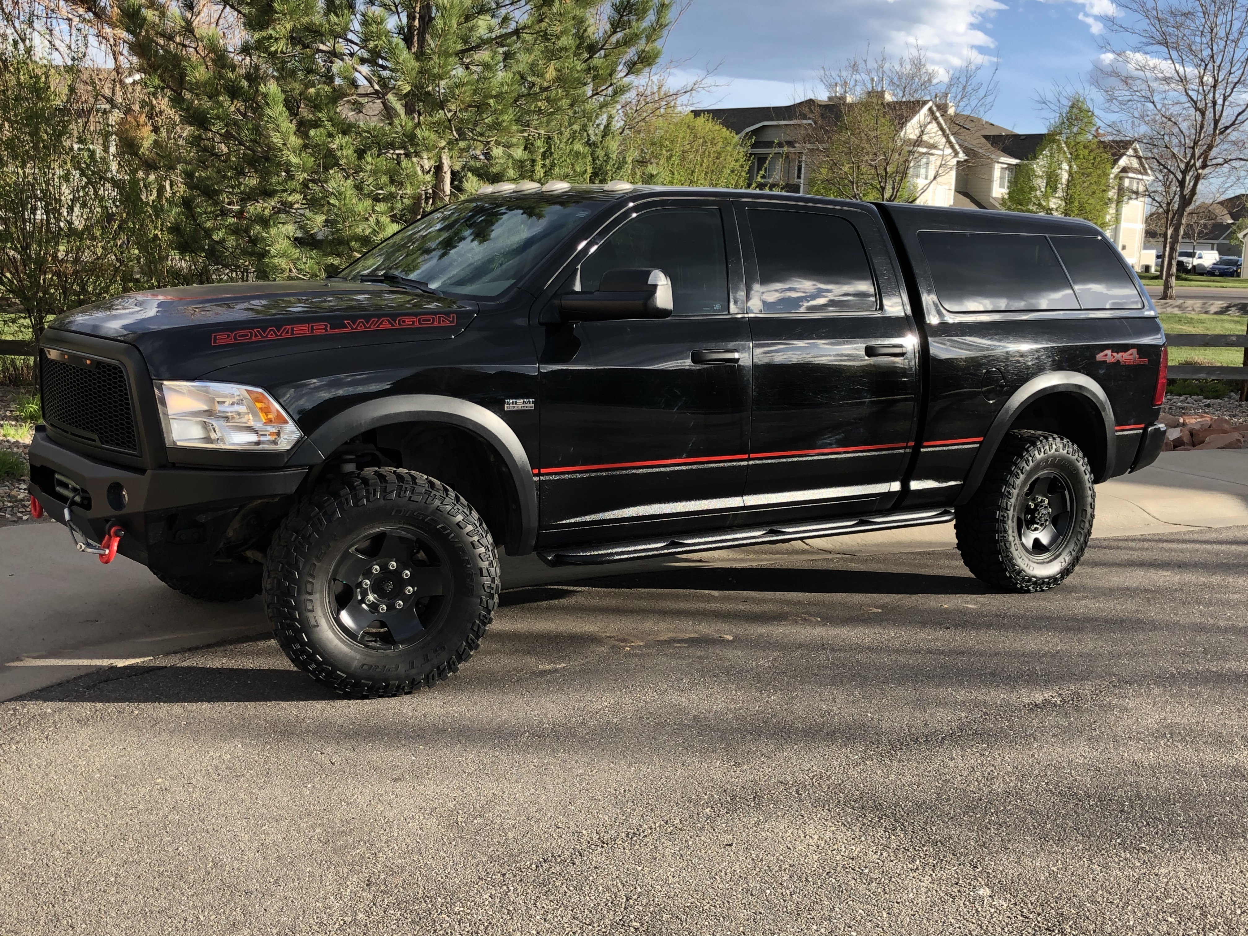

It has been a while since I updated my build sheet, so I figured I would add some of my recent changes. I kept losing the center hubs on my wheels, so I took them off. The aluminum wheels were a bit scratched, and I wanted to switch to black wheels after I switched my front bumper. So....I decided to try some painting projects. I painted my wheels and then my rear bumper. The bumper had some dents and scratches, so I was looking to replace it with a black aftermarket one anyhow. I took a couple days of COVID lockdown to do some home body shop work! I used Duplicolor Ultimate Wheel Coating for the wheels, and they turned out way better than expected.

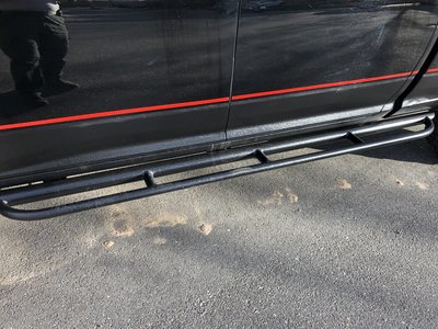

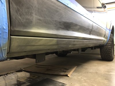

Now I had one project left. The side of my truck slid into a log during hunting season. It dented the bed just in front of the driver, rear wheel. There were some small dents in the corner of the cab and scratches too. I did some amateur body work with a body work hammer kit, and I got most of the softball sized dent out of the bed portion. The problem was the paint was destroyed and it looked like crap. The body shop wanted a ton of money to fix these, and I had a bunch of gravel chips on the lowe portion of the truck and pinch welds. I had been looking at having the lower part of the truck redlined, but they wanted $1200 just to do the bottom. Too rich for my blood, and I was having a blast doing my home bodyshop work. I figured I would give Monstaliner a try. I ordered a gallon kit to do my body and my sliders. I took the sliders off and did some prep work which was a pain in the butt.
It was a little nerve racking when I started sanding the black paint. Here is the pre-lined look.
Re: 2012 New to Me!

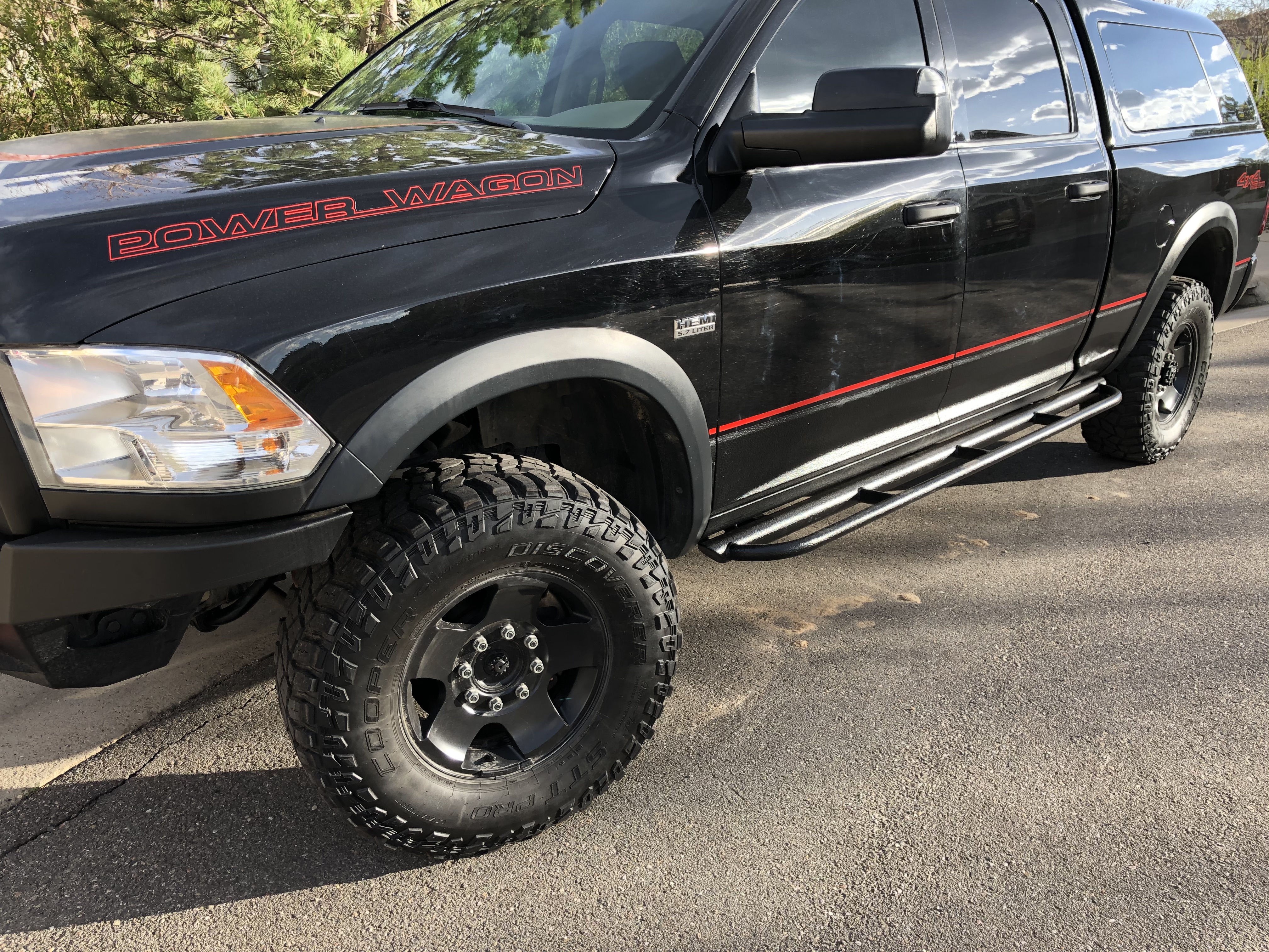

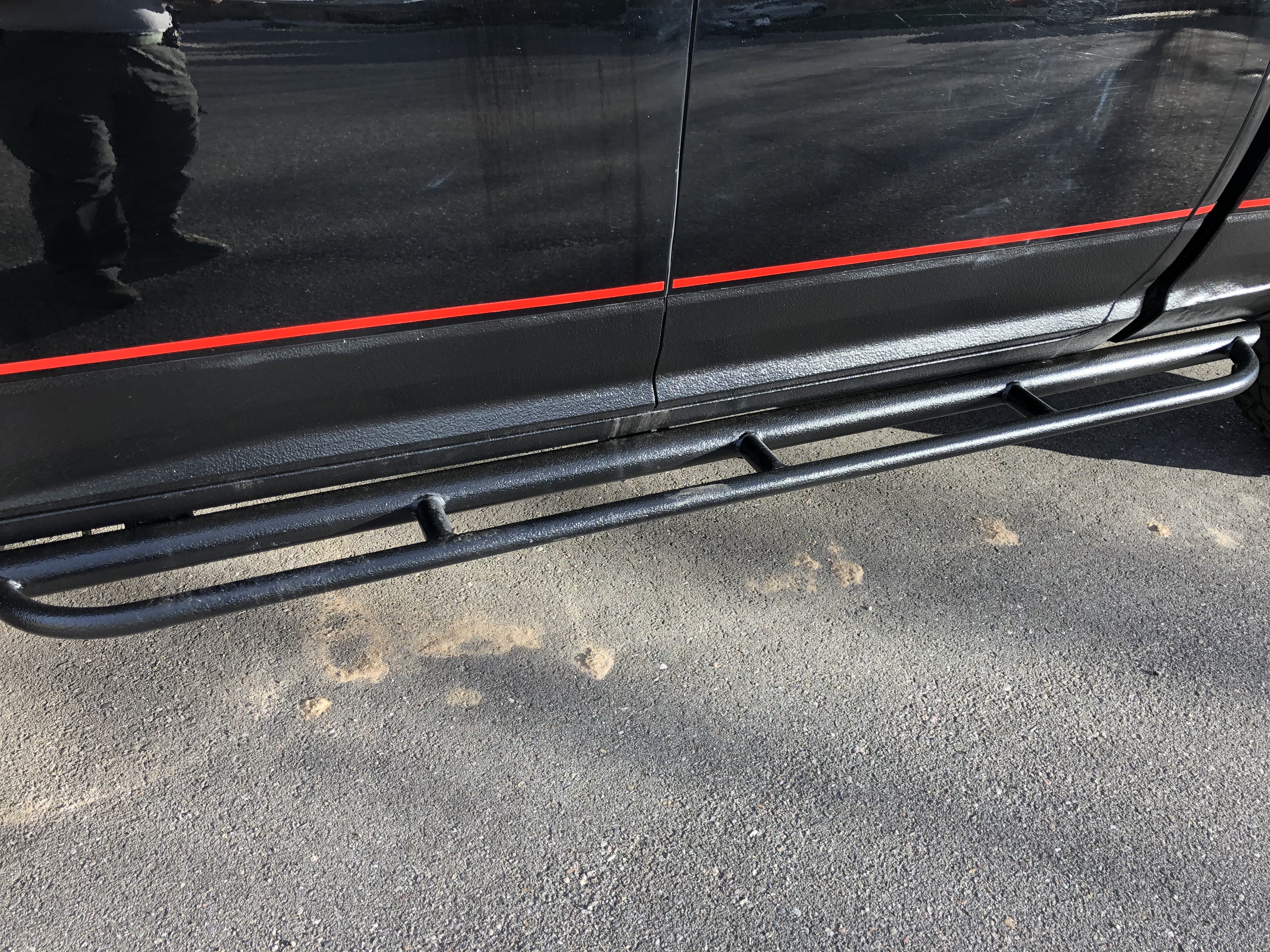

After the prep work and cleaning. I had the wife help me with rolling on the Monstaliner. It was actually a lot of fun. I was unsure what it might look like, but again, I was very surprised. I did the sliders as well and put them back on. Now my truck has a new black textured look.
Re: 2012 New to Me!
Other than having some dust and rain spots on it. I was thrilled! Now all my gravel rash is gone and the dent is harder to see. All total it cost me about $250 for all the mods in total. We are headed to Moab to get out of town in 2 weeks, so now the truck looks like a completely different beast! I am waiting to receive an Airlift Wireless One system and a spacer for my swaybar bushing. Other than that, I am about tapped out for mods. I got the Amsoil changed for the towing season, and I will put the other pieces together when I get some time this weekend.
