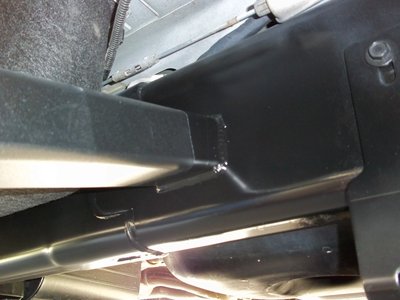

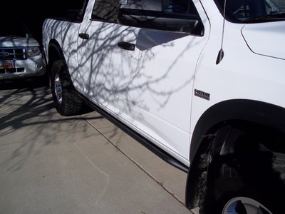

Truck finally went into shop today to get sliders made. Had to put it off a couple months as I've been in process of moving.
Brief details:
Inner/main tube 2" dia. x .120" DOM
Outer tube 1.75" dia. x .120" DOM
Frame mounts: 2" x 3" x .188" square tubing
Welded to frame. Should be stout enough without being too heavy. Estimating about 55 lb. per side.
Will post pics asap....should be done a week from this Friday at latest. Looking forward to finally having them.

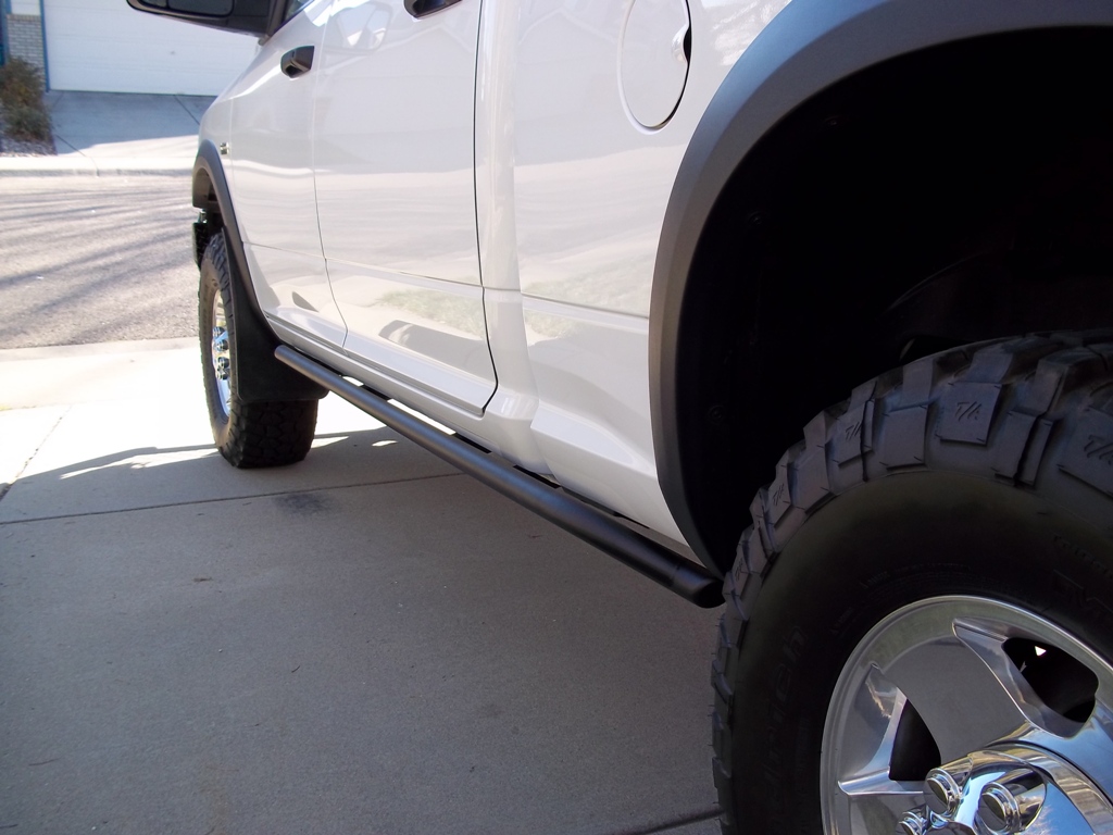

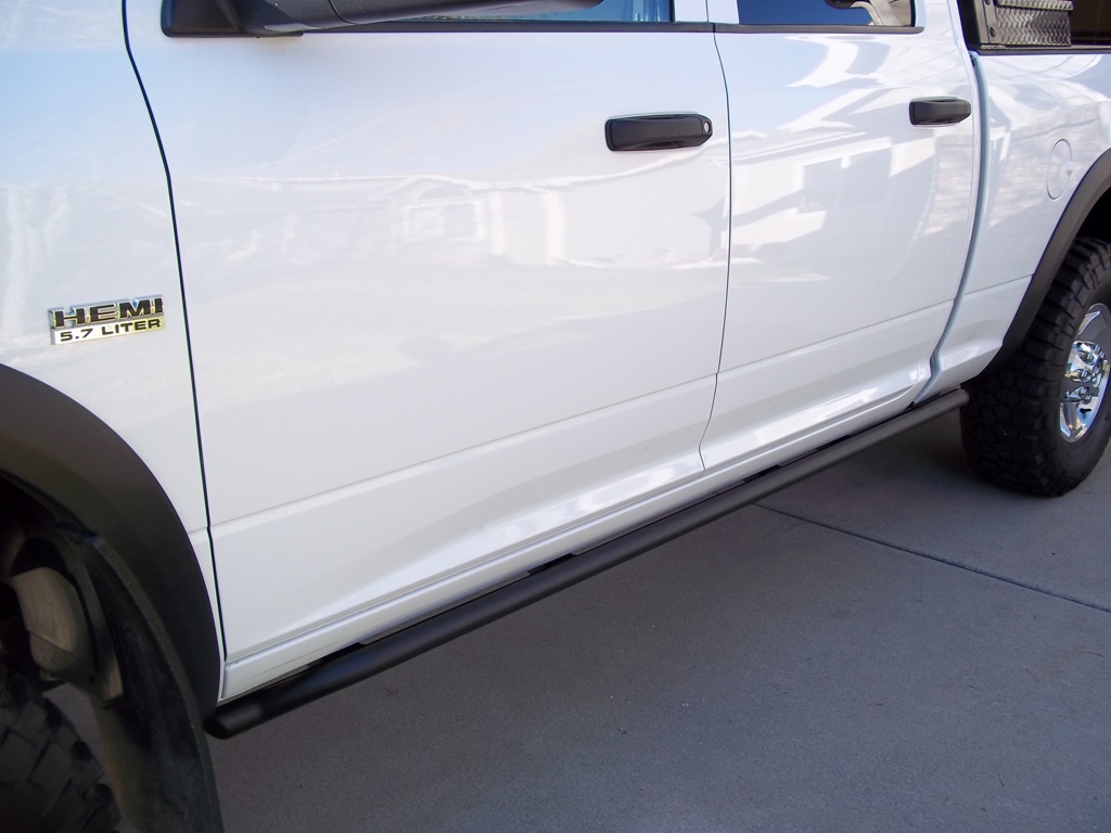

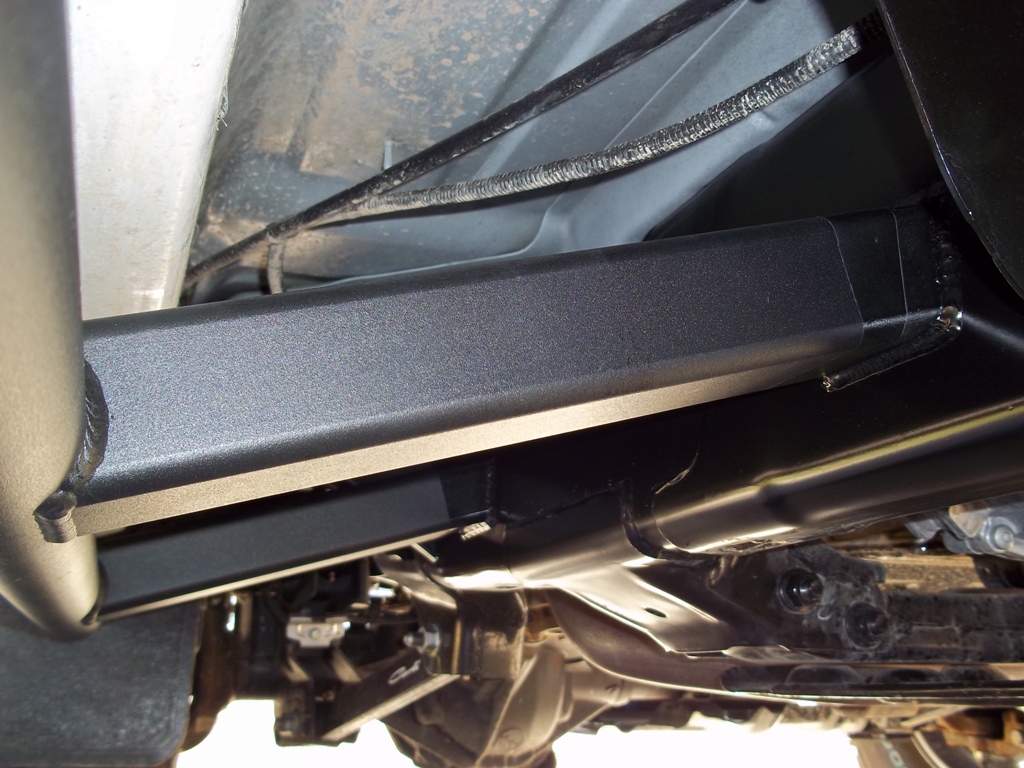

My Armorology sliders are finally on. Very happy with them. Came in at 65 lb per side.
These were extremely difficult to get uniform to the body and side to side. Very labor intensive, but they nailed them. Ended up about a 1/4" tighter to the body than we shot for though.
Powdercoating is a subtle texture...some kind of "cross linked polymer" blend that is very durable & UV resistant. Awesome job by Spectrum Powdercoating in Co. Springs. Pretty much a perfect match to the factory flares too.
