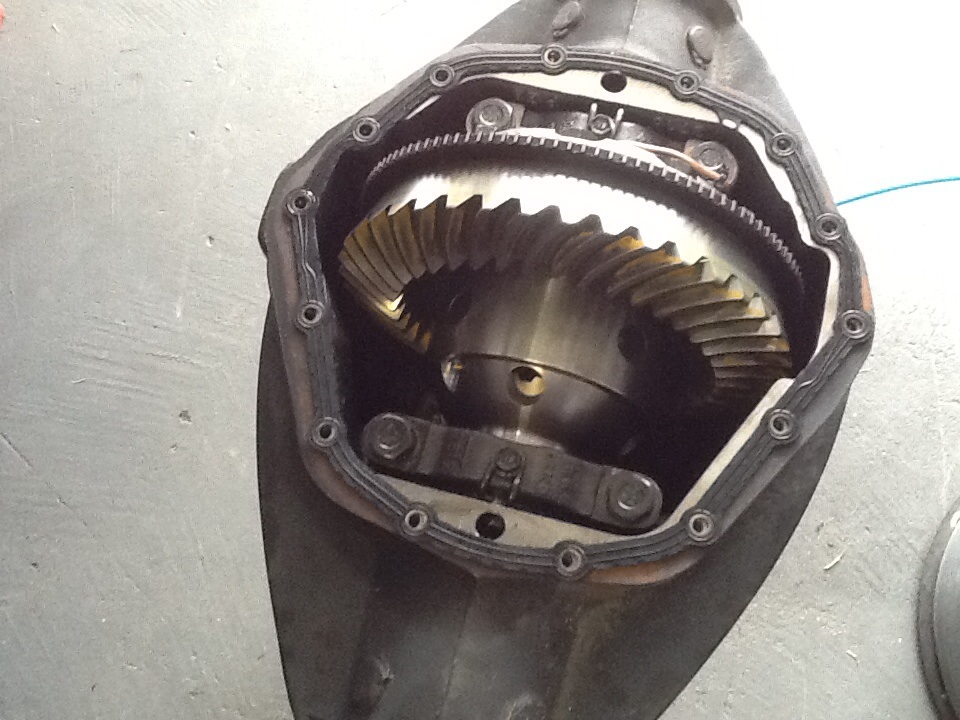

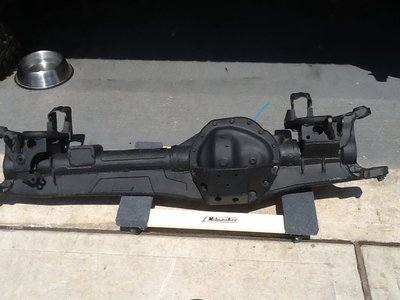

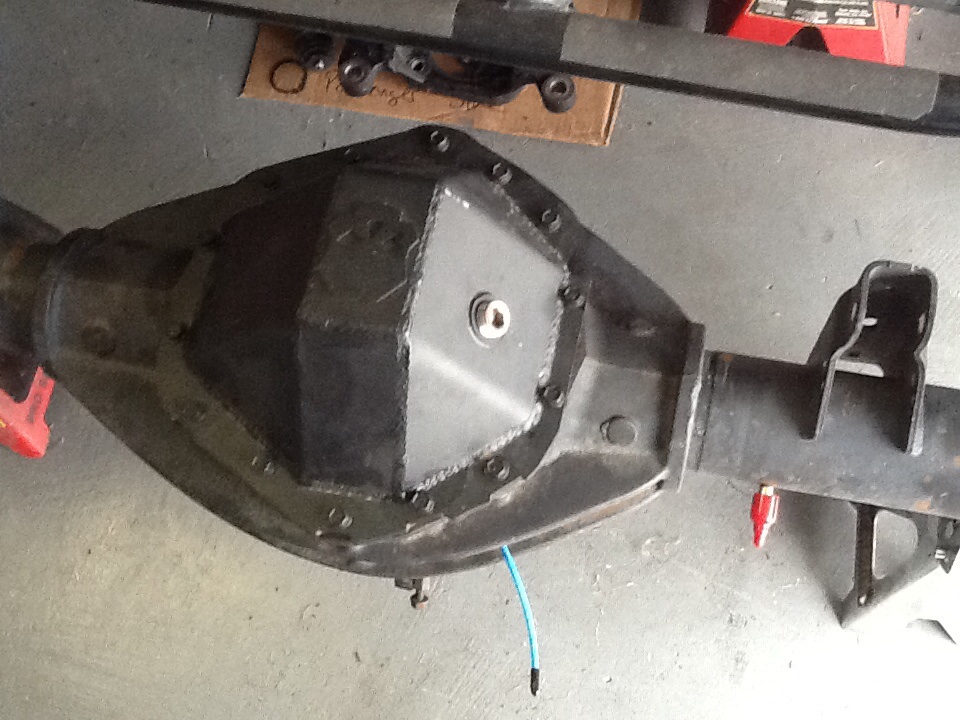

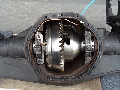

Finally starting to make progress again! Got the axles back, 5.13 gears REM isotropically finished and ARB lockers front and rear. The front is trussed by creative fabworks using a thuren main tube and the rear is an AAM 11.5.

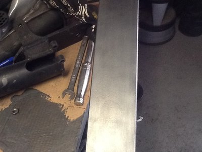

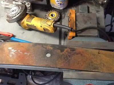

Also rebuilding my deaver leaf packs with new bushings and cleaning the rust from between the leafs. Using slip plate dry film lube on the leaf faces then painting the assembled packs

Nice work on the axle... Your going to love the ARB's... Been beating on mine for years with no issues.... (prob just jinx'ed myself)

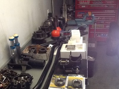

Parts are starting to come in so I can get back to work now, have a bench full of stuff and my new rear shocks finally came in!

Those are beautiful!

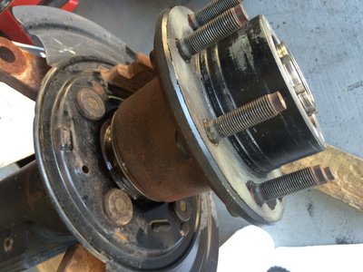

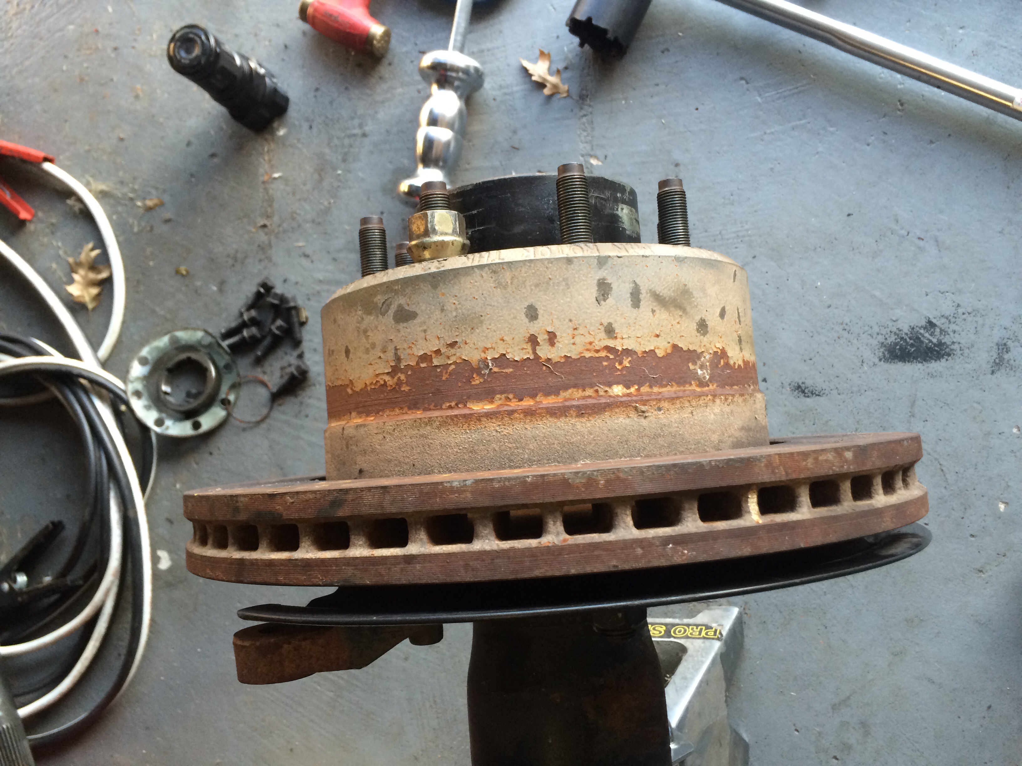

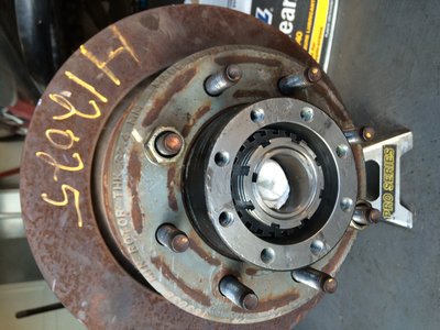

Got the rear hubs done. New races bearings and seals as well as upgraded hardware for the spindle locks. Stage8 DNA-60. Much beefier than the factory setup and far easier to use.
Re: Boogie wagon take 2
That's such a. Good idea. I had a lock ring come loose on my 10.5 last month and it pissed a ton of fluid out all around the front of the rim. Checked it it appears that it just wasn't put on 100% easy to come off either way... Unfortunate design

It'll fit the 10.5 too lee, you're troubles are one of the reasons I made the upgrade lol

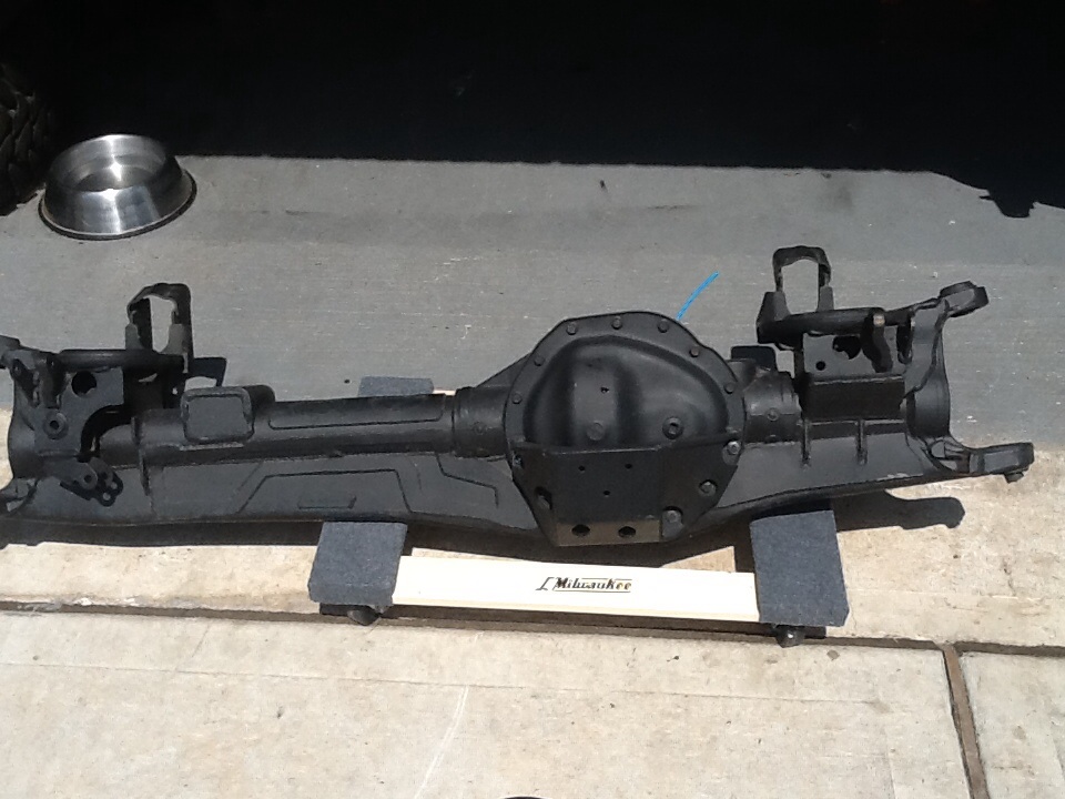

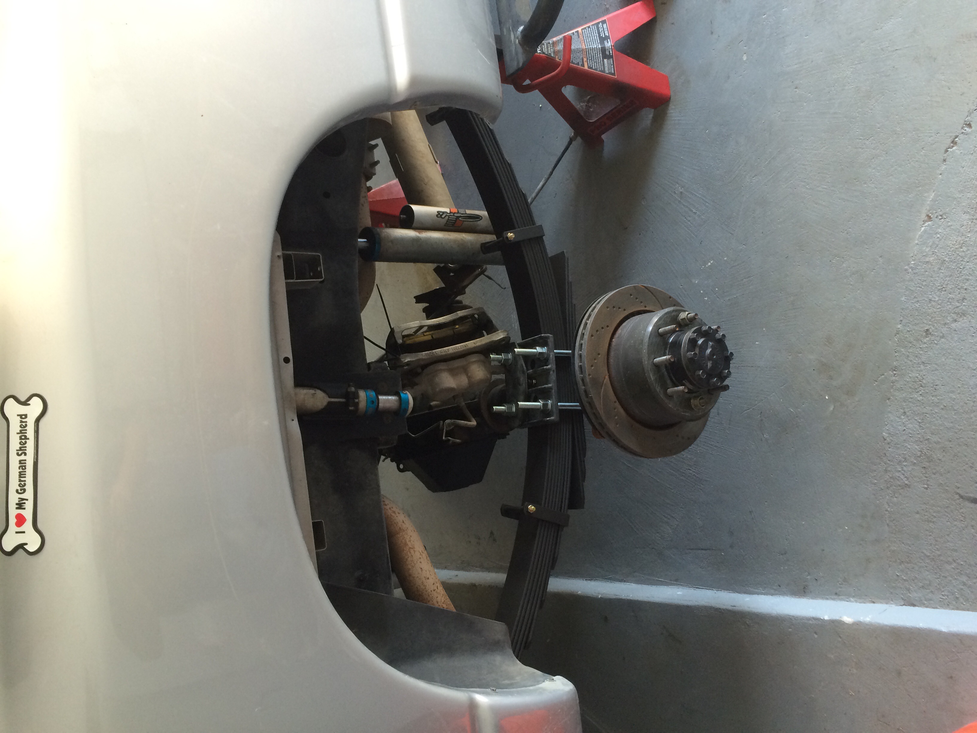

And the rear axle is in its new home! Just have to put new brake shoes and hardware on and I can button up the rear and move on to the front
Damn brake caliper ain't gunna do no good there!
