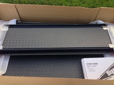

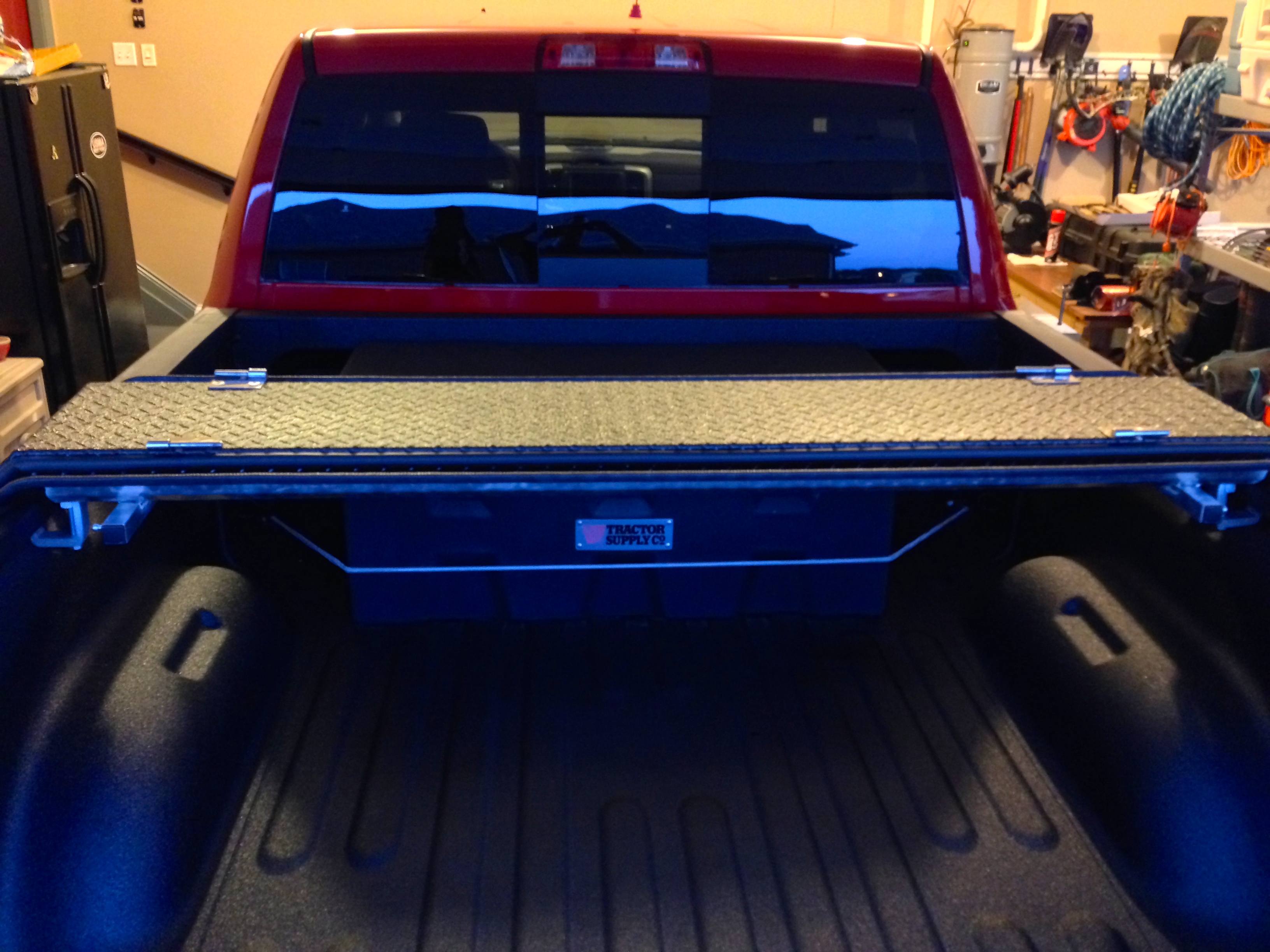

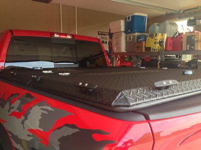

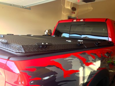

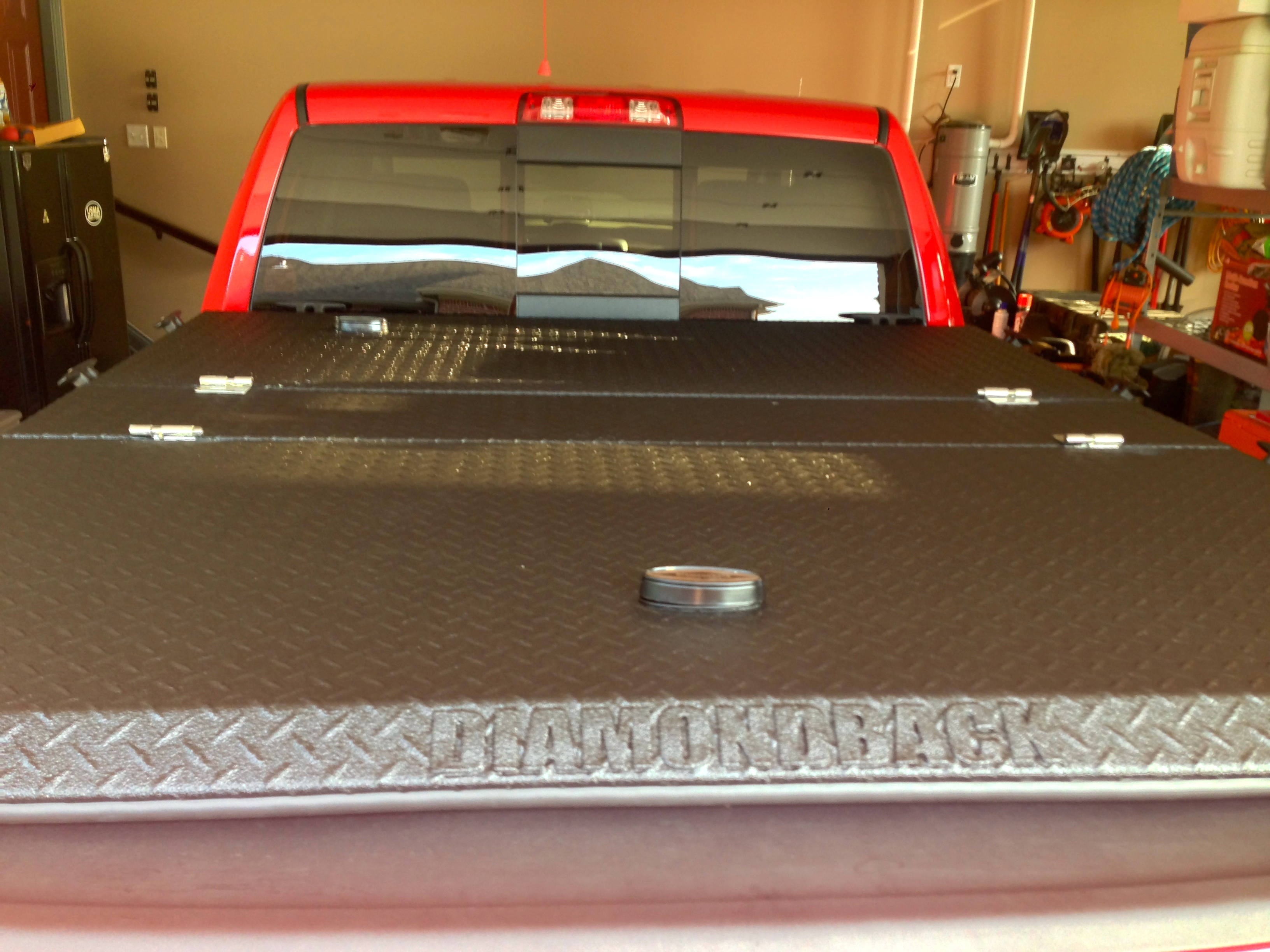

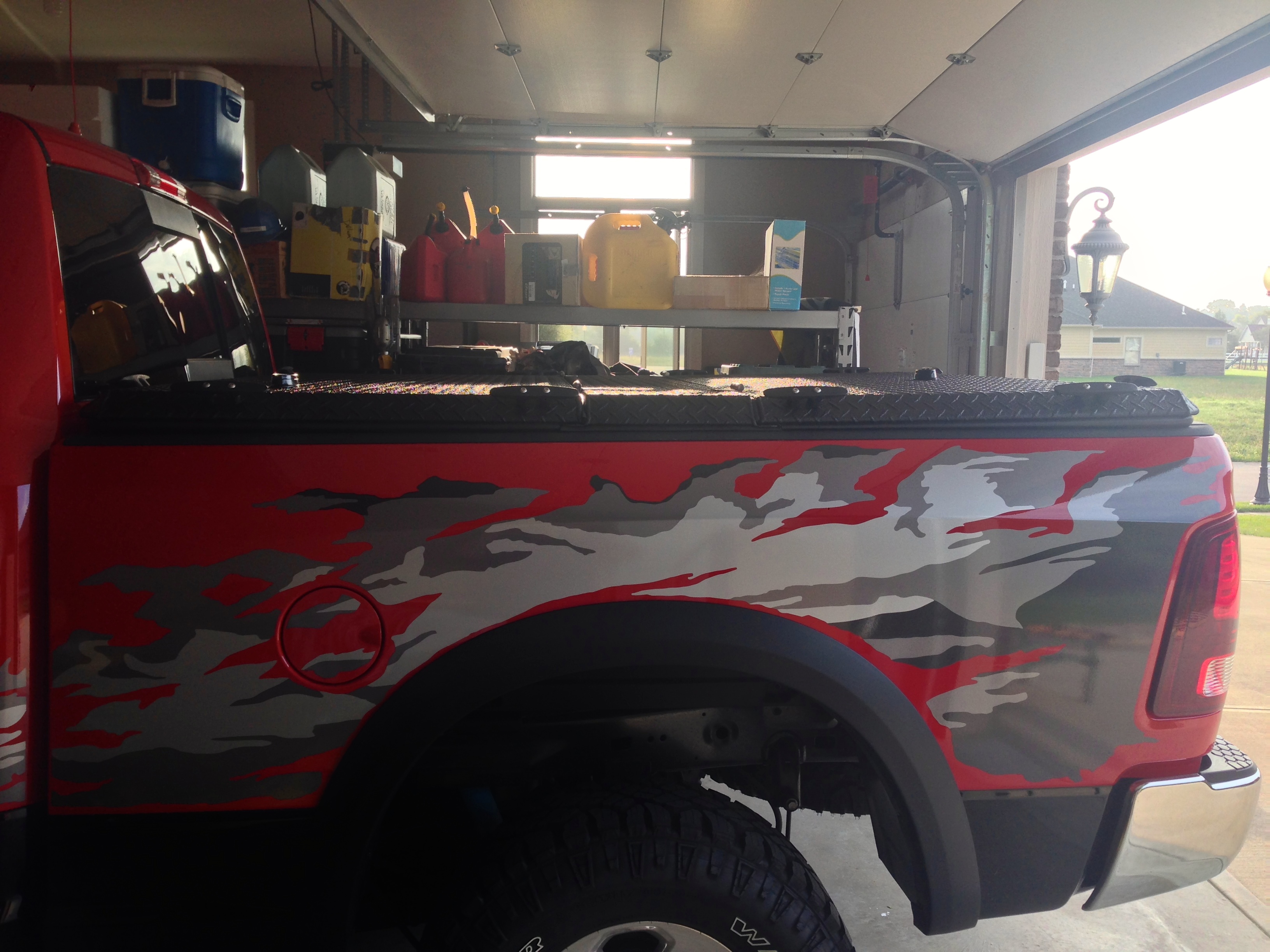

MOD: Install DiamondBack HD w/ Line-X truck cover
PURPOSE: I did not want the RamBoxes, and I didn't want another LEER/ARE topper. I was extremely dissatisfied with the LEER MX topper on my F150. I had a fully decked out LEER with the sliding & removable rear window and sliding windoors with the sliding screens and it was miserable. After the first winter all the locks corroded frozen shut. I even applied petroleum jelly and teflon grease to the all the locks before winter and it still didn't help. Leer replaced all the locking hardware and all the screw fasteners that were also corroded. The same thing happened the next winter.
For the PW I wanted a secure cargo area that I could load on-top of and also still utilize the bed for tall items w/o completely removing the cover. The Diamondback HD answers all of these requirements. I can load 1600lbs on-top of the cover, which is over the max load of the PW. The locking mechanism for the fwd and rear panels are two ¼ " steel locking rods that anchor under the bed rails. The cover is diamond plated covered in Line-X, which is fade resistant and slip resistant. The cover is water tight, equipped with thick weatherstripping around the perimeter, and each seam between the three panels has a designed water gutter that funnels water out the sides of the cover. The fwd and rear panels are equipped with 4 hydraulic shocks that keep the cover panels open. All of the hardware is easily replaceable and DiamondBack carries spares of all the hardware if something needs repaired. It comes equipped with 10 tie-down cleats.
You can add a hi or low cab guard to this cover. THere's also a complete ATV top load kit available to add to this cover. The kit comes with large ATV ramps to drive up the side of your truck on the cover, large wheel retaining bars that you'll have to drill and mount to the cover, and an extension platform to fit two ATVs side by side if you don't have an 8' bed.
PRICE/VENDOR: The 6'-6'5" HD cover runs just over $1300, the Line-X option is about $300, the shipping was about $190. Diamondback HD
INSTALL: Easy-to-Moderate. The directions state the install is 45-60 min with two adults. It took me just over 90 min to install it with my 7yr old son. If I did it over again, I'd ignore the majority of the instructions because they create more work than necessary.
  • Do not attach the clamps on the center section until the very end. Once you attach them, even loosely, the cover is nearly impossible to slide and adjust
  • Oil the hinge rods before installing panels on the center section. The HD panels are heavy and bit awkward, two people really do make it easier. I had a hell of a time with getting them on and aligned.
  • Once both panels are attached, Spend EXTRA time ensuring the cover is square with all four corners.
  • Lift up the tailgate panel and slide under and attach the clamps to the center section. Use a torque wrench. It states tighten to 30ft-lbs. I didn't, and snapped the first screw, and then had to run to the h/w store for a replacement.
  • Adjusting the locking rods to fit inside the bed rails and then aligning their mounting tabs was the biggest pain of all. You have to ensure that when you put the lock into the closed position the rods should be pulling the cover closed tight in tension, and in the open position, the rods should release tension. I had to do it 3 times to get it right. The alignment tabs require a 14mm socket tightened to 10ft-lbs, and I snapped one of those too.
  • Attach the shocks, close the cover, check the open/close function, and re-check the alignment.
Box Arrived
Inside...
Center panel

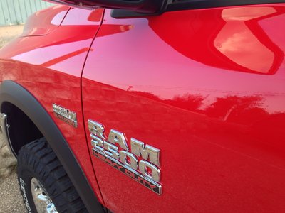

MOD: optimum opti-coat pro
PURPOSE: permanent life-time ceramic clear coat protects PW from
Tree & brush damage in the woods, prevents rock dings, swirls, rain stains, bug etching
COST/DEALER: local certified installer in Cincinnati, TSS detailing. $495 for install & 10 yr warranty
http://opti-coat.net/content/52/opti-co ... ating.html
This is NOT some Car Dealer or Zeibart snake-oil sham wax sealant. This is a permanent ceramic clear coat that is 50-100x thicker than waxes & sealants. It's applied to the paint, chrome, wheels, etc. everything but the glass. Water just sheets off the paint and doesn't spot up. With opti-coat, you don't have to wax your car ever again, but can if you like doing. A polymer based quick detailed sprayed on one panel at a time after you wash it, before drying works best. The application process takes about 8 hours:
- Wash
- PH neutral wash
- paint correction (bugs, swirls, stains) & polish
- Wash
- Alcohol decontamination
- Dry w/ heat & blowers
- apply opti-coat w/ spray gun, even & level
It's quite the process, well worth the $$ & comes w/ warranty.

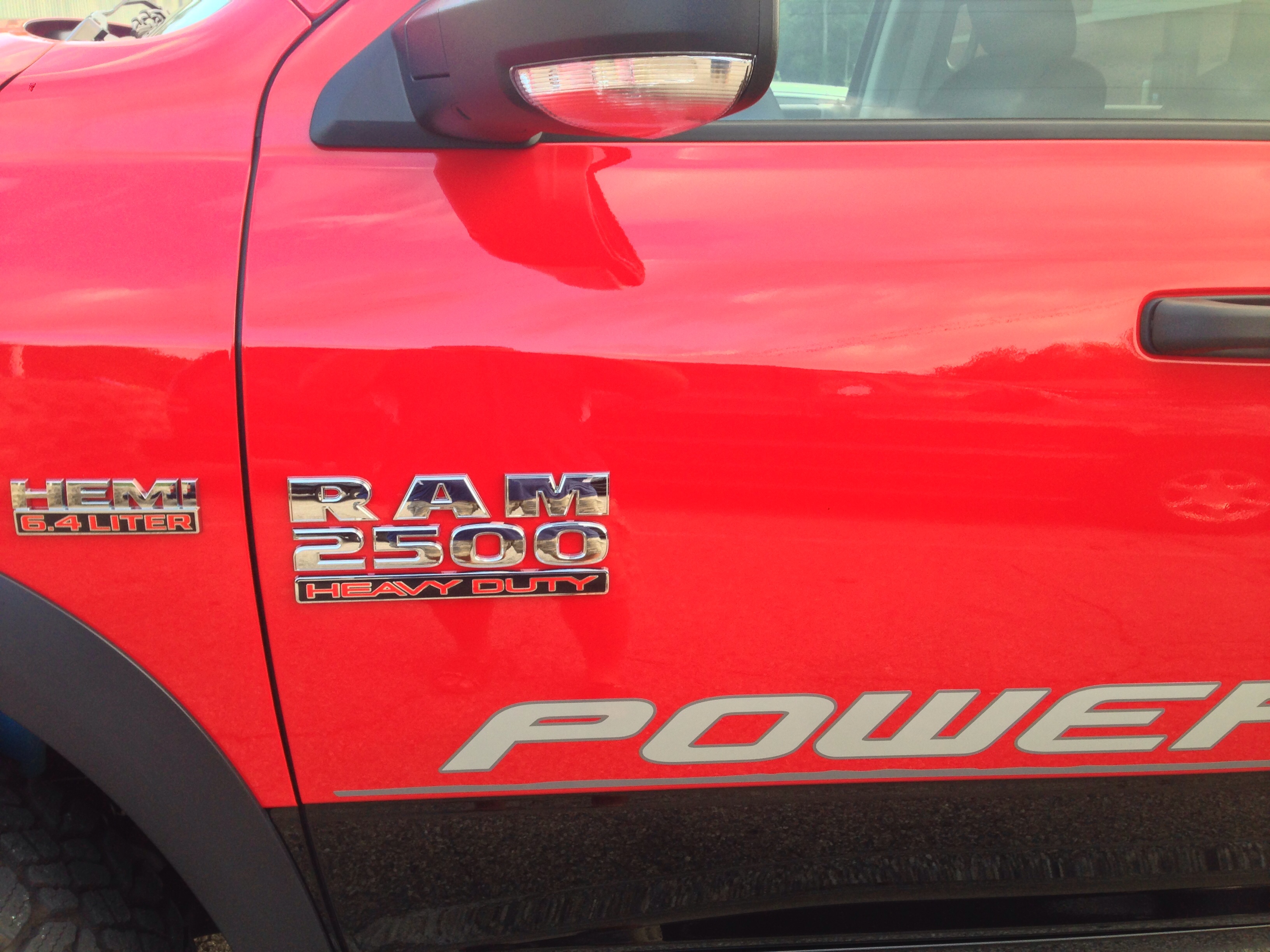

Added a few appearance items this weekend. They don't really serve any purpose so I won't waste time w/ a full write up, but here they are
1) Added the RAM 2500/HEAVY DUTY emblems found on the Tradesman & Laramie. I measured the distances from the door seal on a stock 2500 at the dealer & used a laser level & painter's tape to make a quick jig, and applied as steady & straight as I could.
2) Added 2500 air deflector. It's cheap & flimsy compared to the metal one in the 1500.
