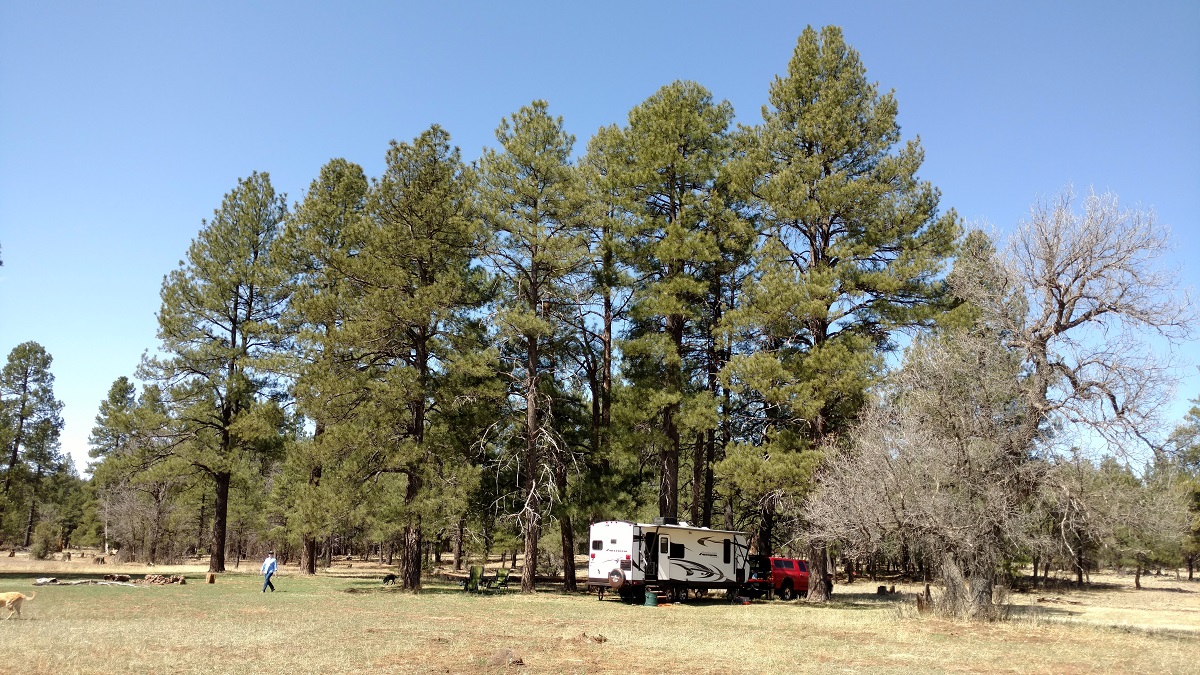

Post by Cactus Red » Thu Apr 12, 2018 11:18 am
Measured trailer tongue weight - it came in at roughly 1400 lbs with tanks empty. So the EazLift Elite 1000 hitch will be for sale shortly, and it's being replaced by a Blue Ox SwayPro 1500. I'll also be trying to move a couple items out of the front storage compartment to lighten it some. Most of the front weight is in the two US Battery 2200 6V batteries and two 30 Lb propane tanks. It's unlikely we'll carry all 90 gallons of water, or have all the black and grey water tanks (120 gallons) full, so I need to figure out a typical loaded tongue weight. Should get an answer to that this weekend.
The Toyo's worked great last weekend. MPG went up from 6.1 to 7.8 on a trip that gains 2700' of elevation in roughly 60 miles, most of it in a 15 mil climb from Ashfork to Williams, AZ. I expect to see 8.5 or better on flat ground.
