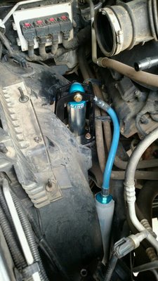

Is the hose supposed to point towards the front or toward the engine?

Seems real tight like that

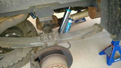

Post by Will » Sun Jan 10, 2016 5:23 pm
All four on installed, back was easy.

Remember mine is a 3G but here is how mine was orientated. Just scroll down a bit to the photos.
I had an issue with the OEM air box and the height of the shock but got around it by using the AirAid and their dry filter.
PS: your going to love your new sports truck handling. just take take it easy until you truss your axle!
Re: 2010 Improvements
Post by Will » Sun Jan 10, 2016 6:40 pm
Hell yeah, I was getting pissed to start with but as soon as I decided to take the powder coat off and got past the front driver, the rest was easy. The towers would only allow me to mount with the hose towards the engine, I might try to turn the 45 a little on the passenger side, the hose is tight on the valve cover. I did have to trim the air box a little. I'll patch it another day or get a different CAI.

Yea I rotated my fitting and had no loss of oil because I used three wrenches and the wife to hold the AN fitting in the shock. While I finessed the rest into place. The drivers side just plain sucks that's for sure LOL.

Will wrote:Seems real tight like that
ya you need to turn it so the resi hose comes directly out front. The way your shock is in this pic it won't cycle without binding cause your shocks facing wrong direction! Should pivot forward and back word!

Post by Will » Sun Jan 10, 2016 7:19 pm
Sent from Canada
I thought that but couldn't get the driver side that way and that was the first one. Dammit, I won't be able to turn them until next weekend. I'll have to stay calm until then.

Post by Will » Sun Jan 10, 2016 7:24 pm
Then again, it has a Jonny joint in the top so why would it matter? I was able to get it in the tower fully extended and I put the tower on the passenger side first, it pivoted fine to bolt up. I don't think that's an issue...

It shouldn't be too hard to turn. Just leave the shock tower attached to the shock and using body weight and a helper you should be able to do it from the top and have someone in the wheel well catch the nuts
Post by Will » Sun Jan 10, 2016 8:10 pm
After I thought about it, I don't see why I need to turn them, the shock has pivot in the joint. With the tower bolted to it, you can swivel the tower 360 degrees.

Post by nts007 » Sun Jan 10, 2016 8:16 pm
I'm not sure it matters too much either. Since that joint pivots in 2 directions anyway as the axle cycles. Forward back and left right. Should be ok
Post by Will » Sun Jan 10, 2016 8:19 pm
They would be a few degrees off if you did turn them, would not be perfectly perpendicular to the axle anyway.

Post by 2wagons1driveway » Sun Jan 10, 2016 11:50 pm
No idea on Thuren shock towers but Carlis go straight ahead and I've seen dons older towers go forward probably right it may not matter.

Flexed it too, shocks are fine mounted this way.
