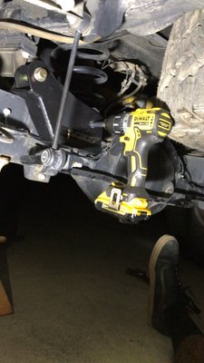

I got home from work a bit early yesterday... I'd had a redbull and was feeling motivated. I got out the jack stands and started tearing down the front suspension. I took my time with tear down and install, cleaned up the frame and coil buckets a bit, and from start to finish it took me about 4hrs and 2 beers working solo in the driveway. The Carli 3" Hemi Coils are in, as are the Carli/King 2.5s, all that's left for the front end is to readjust the track bar and re-center the steering.

Carli 3" springs and shocks installed here, rear is stock springs/shocks in this pic.

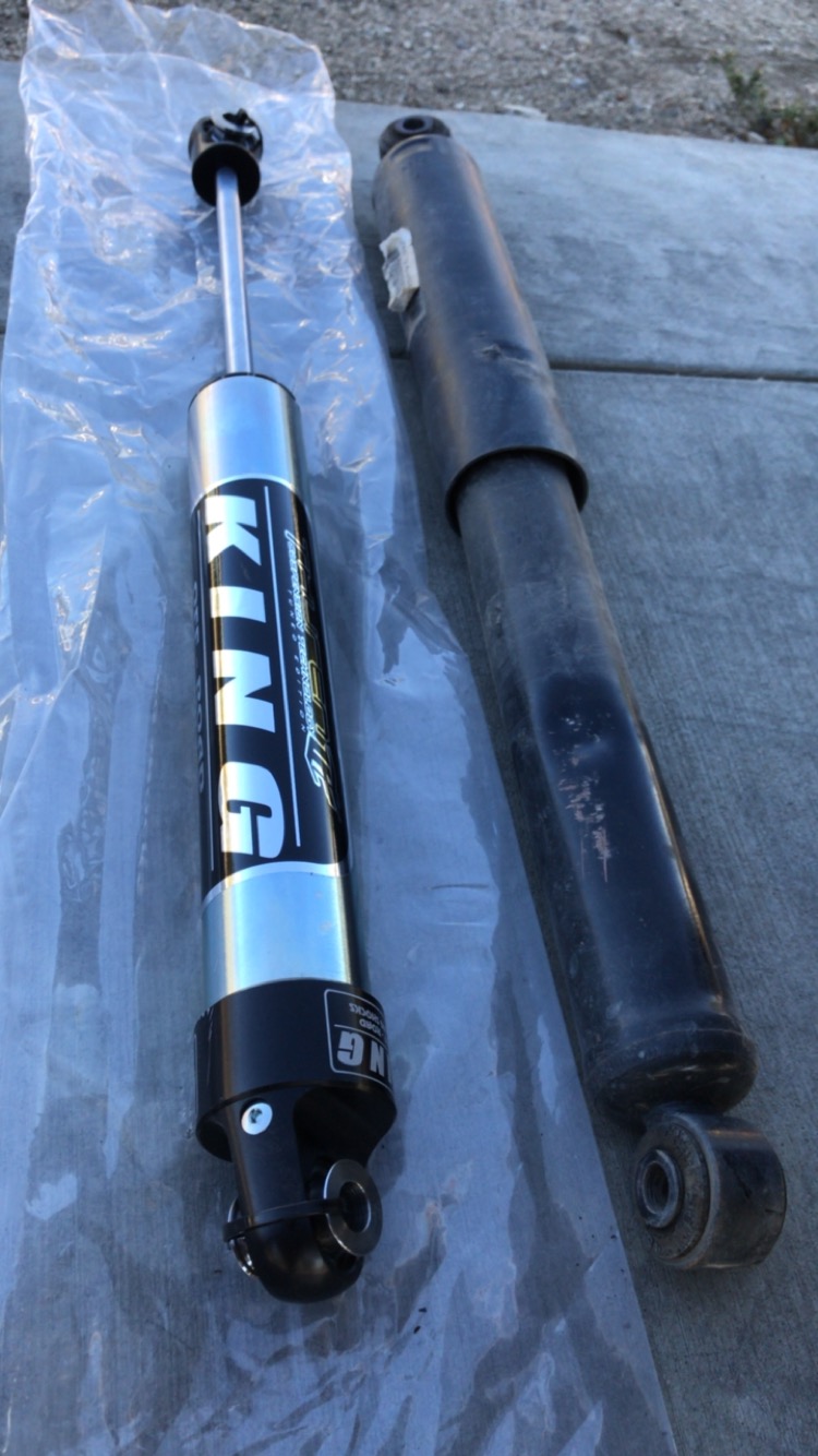

Rear Shocks - I installed these today after work, along with a pair of reservoir guards to protect the compression adjuster knob from rocks and debris thats kicked up by the front tires.
...Don't worry, that bottom bolt was tightened after the pic was taken!

So, drove the truck a bit yesterday after work... Front feels great on road with the Carli valving, similar to stock, but a bit sportier without any harshness over expansion joints, etc... The rear is a different story though. These were not purchased as a complete Carli set, the rear shocks are King OEM series 2.5s, which King sets up for a diesel. As of now the rear adjusters are only turned in 2 clicks on each side, and they are too stiff, not harsh, but it feels more like a standard 2500 in the back. I out some weight in the bed last night, about 700 lbs, and it felt much better. I'm going to re-valve to get a smoother highway ride when empty, then I can turn the adjusters in a few clicks to handle the weight of the RTT and gear in the dirt.
