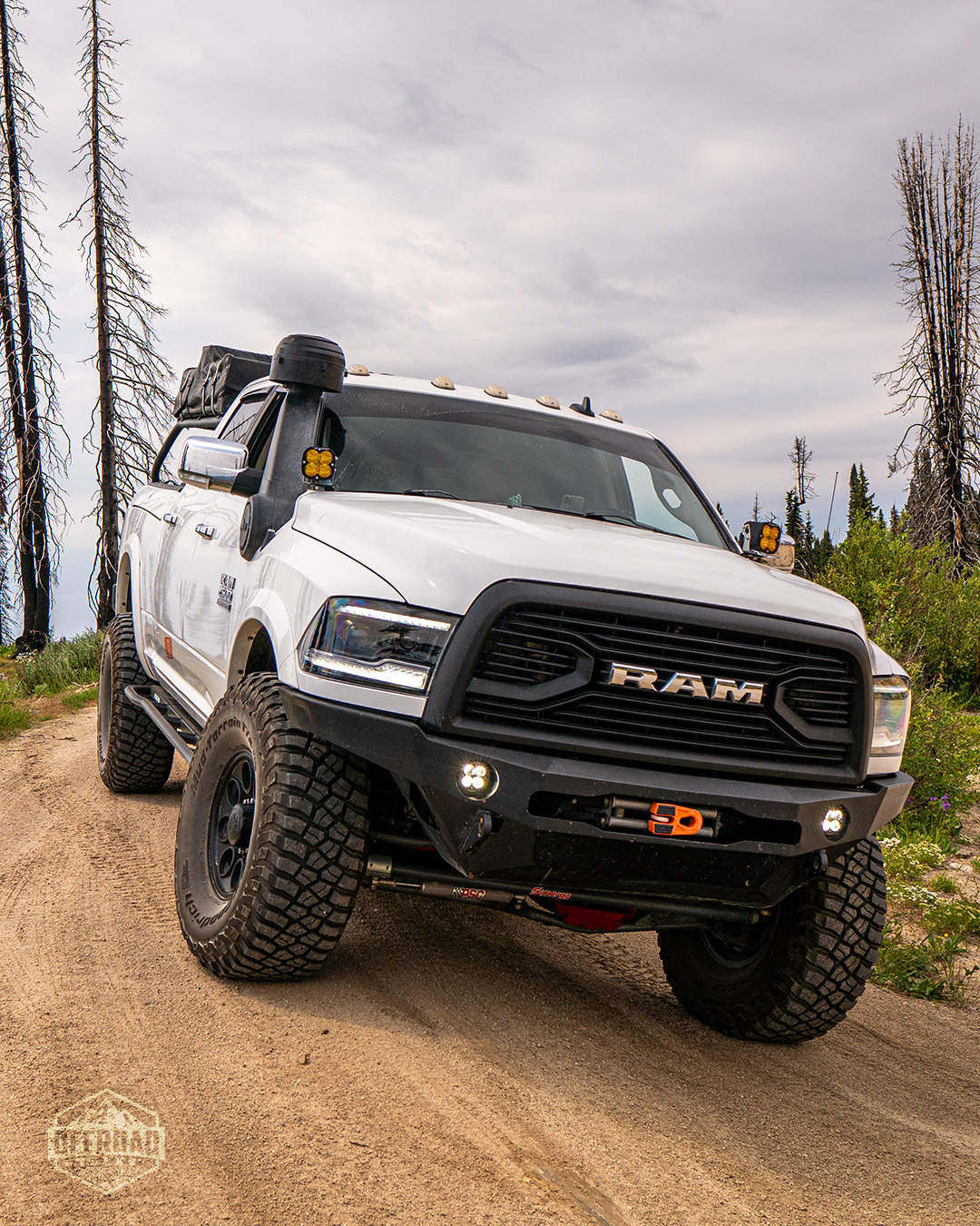

Here's where she's at today, sitting pretty on 39's. A lot of updates.
Swear I will update this build thread one day.

:rockon: :cheers: Good to see you,,been awhile,,,truck is looking good 👍 hope this finds all well w you & yours!
Re: OffroadTreks - 2015 Power Wagon Laramie #RockLander Build
Post by adeluca73 » Thu Apr 03, 2025 12:05 am
Amazing view!
