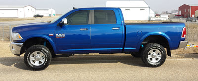

Don revalved the Kings. I'm not sure if what he did lines up with the Stage scheme he uses but the added low and mid compression valving sorted out the lazy feeling the truck had. With Stage 2 Hemi valving and his swaybar, the front would dive in off camber turns and wallow. The small bump compliance at low speed was awesome but the compromise was not worth it. The stiffer valving is still better than stock at low speed and much better at high speed; at 80mph the truck feels more sharp. If you're considering an aftermarket swaybar go up one stage in the front, if you have a truck cap go up one stage in the rear.

Is the new valving still working well with the shims broken in?
You've got a sharp looking truck man! I dig the blue. I hope the skid serves you well!

I removed my smartbar last night. I can't even describe how much better the truck feels. With Stage 5 Kings it's definitely not required unless you're maybe towing a large trailer at max (which I never do) and was the cause of my floaty, bobbing feeling at speed. Removing it corrected every disappointment I've had since installing my suspension. I've been working a lot and put wrenching on the truck on a backburner for awhile but now I'm so happy with it again. I should have immediately done it back on July 22 when you posted the pic. Thank you.

Glad it worked out, with the valving you chose you should have no issues at all. People with lighter valved shocks need to be aware that overloading the rear of the truck can be very dangerous with reduced rate sway bars, specifically heavy loads up high in the bed.
Re: Reloaderguy's Mod Thread
Gol damn it that is a nice looking pickup.
