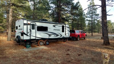

We've joined the heavy towing club. Bought an Outdoors RV Black Rock 24KTS. If you haven't seen one, I'm not surprised. They are a small scale manufacture of truly capable trailers designed for off grid camping. Dry weight is 6900 lbs, but add in the 90 gallons of water, and that alone puts us at 7700 lbs.
So in the two trips we've towed it, my MPG average has been 6.1...
