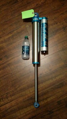

Finally got them now that I'm swamped, hopefully will find the time to get them on this week.
Re: 2010 Improvements
Oooo shit! Those ain't no pussy reservoirs either they look to be over 10"?! I think my Carli ones are like 8"
11-1/2" rear and 12-3/4" front reservoirs
dope!!! Mans mans reservoirs lolWill wrote:11-1/2" rear and 12-3/4" front reservoirs
