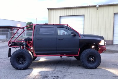

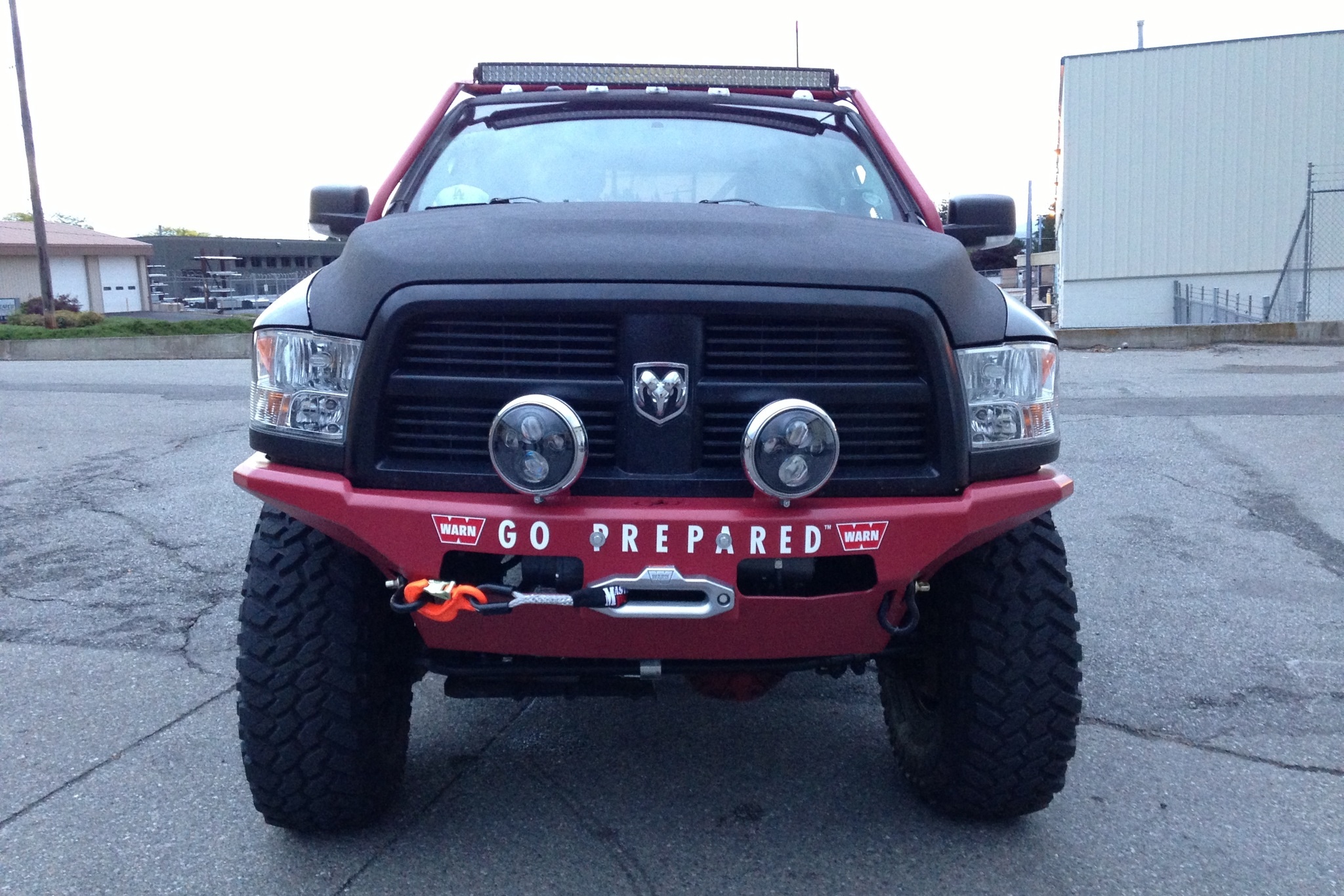

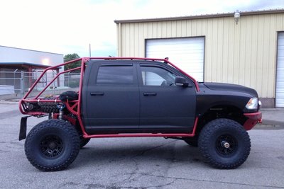

Here it is Ultimate Adventure ready?
2011 Ram Hazzard Wagon
- Stickman
- Posts: 829
- Location: Wayland, MO
Re: Hazzard Wagon
Damn, that sticker on the front is very fitting, lol. Looks like it will definitely go anywhere. The pics almost make it look like the tires are too small, but that is definitely just the picture because those tires are more than enough. Good luck on the trip, be sure to post a link to the vids of the trip, I'd love to watch it. Looking forward to seeing what else you do to it when you have more time.
