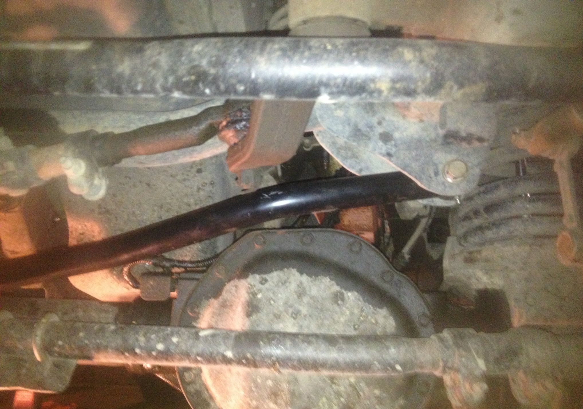

Well I went out to start today hopin to beat the rain. Supposed to be 2-3 inches comin. Well it started. But I got a few pics first.

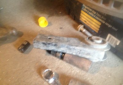

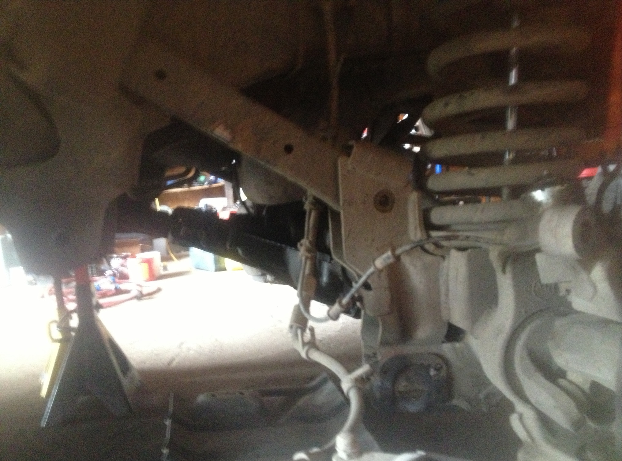

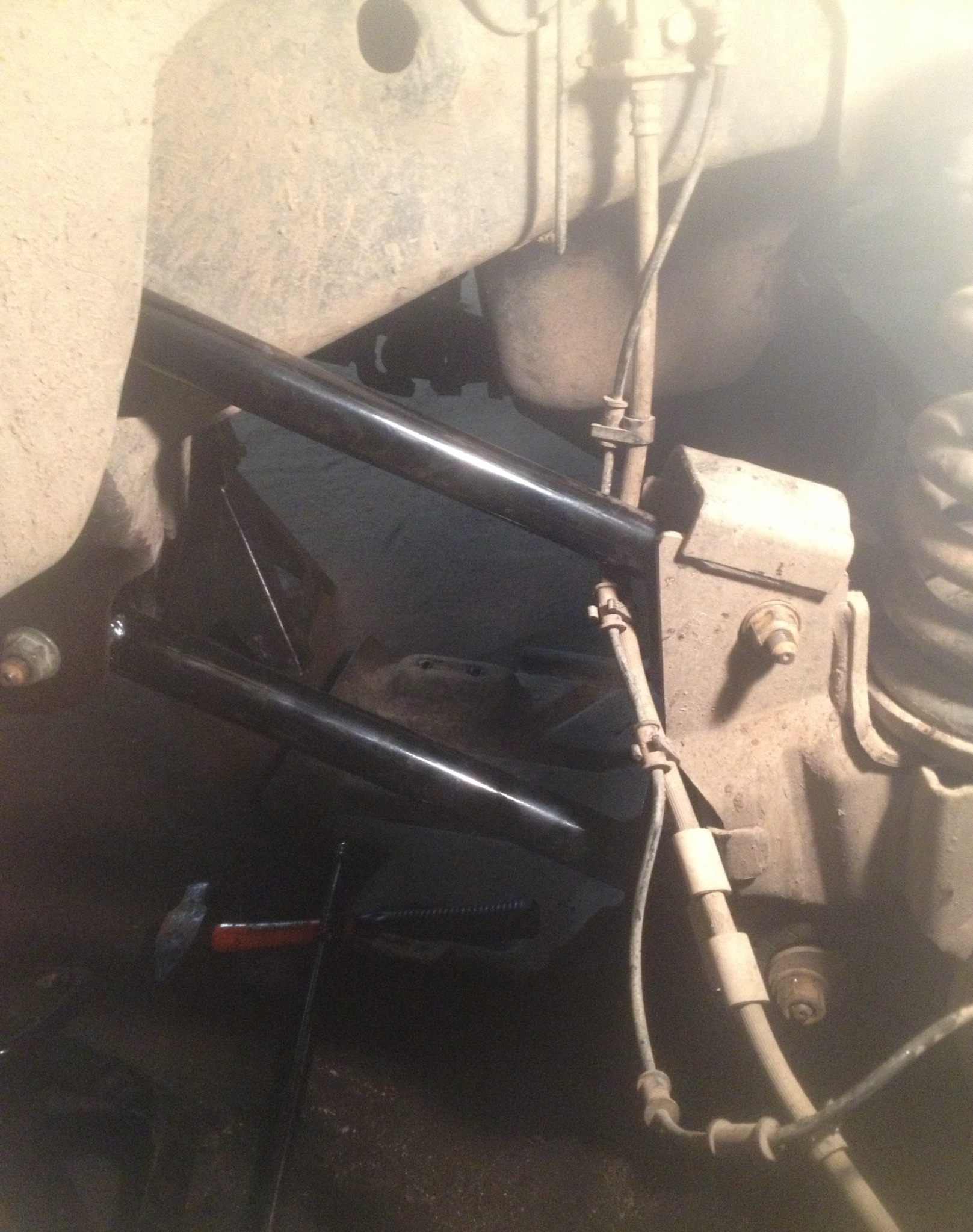

Well after some agonizing pain its in! Had a bunch of issues. Cam bolts wouldn't come out of the bushings. Had to cut them off. Sent a fellow to the city to pick some up a hair before closing time. And they gave him the wrong ones. So had to improvise and make my own. Couldnt get them outta the old axle either. Im glad pure sends a bolt for the top frame. Had to cut that one on the exhaust. Ended up cutting a couple arms in half to make it im easier to get out. But all said and done everything is good. Need to buy the cam bolts but think im goin to get the new ones installed when i get the alignment done on Friday. For now only one cam is installed per side so.... Hoping it will last.
First impressions holy cow are the arms heavy. Very heavy. But solid. Bushings are way thicker and stronger than stock. No binding that i can tell. I won't be pushing the truck too hard untill next week. Carli bar is in too.
Took it for a drive. No more clunk!! It drives solid. The suspension seems to work more than before on the big bumps. So far im happy. I think i got my truck back and its time to move forward. Here some pics
