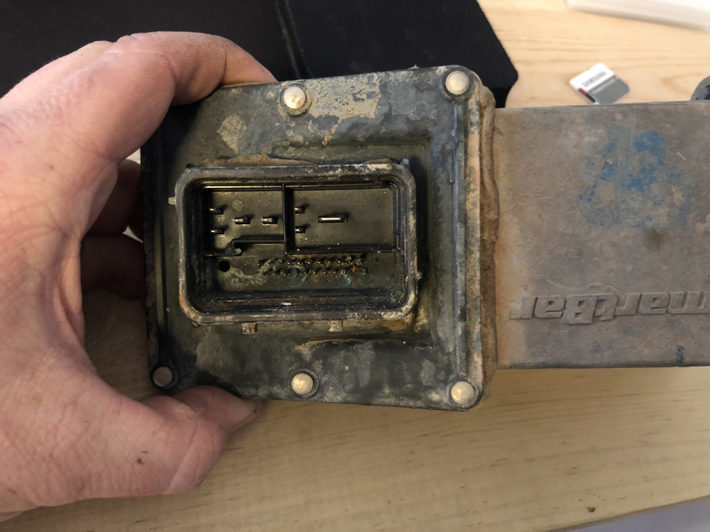

So anyhow, have my first legitimate problem, that is probably my fault from an attempted fix on the trail. Got the old blinking 4WD/Sway Bar selector on a trip out to the Oyhwees on Saturday. Noticed the connector was a big loose and jammed it back in the best I could on the trail, but no luck.
Well, came home and cleaned it, didn't look closely enough, long story short, 3 of the pins on the lower 30 pin (or however many) are damaged. Also some corrosion in the unit.
So right now, I have no sway bar or locker functionality.....
I've got two options really, figure out how to wire this crap and go around the connector. Or, buy a replacement, or hard wire the lockers....
So I might hardwire the lockers, not 100% sure.

Fix the plug and then correctly apply dielectric grease.
Re: BoldAdventures 2015 Power Wagon Build
I'm not sure it is fixable on this end. I have 3 damaged pins. As in broke off.Reloaderguy wrote: ↑Mon Mar 12, 2018 7:31 pmFix the plug and then correctly apply dielectric grease.
In my opinion, fix/replace it correctly, then hardwire. Full control of your lockers is tits. 2wd and 4hi locked make for a more versatile truck. You can pretty easily hardwire without hacking up the oem wiring.
Find a way to fix it. Despite how lame the smart bar is it is central to the whole PW system, regardless if you hard wire or not.MikeKey wrote: ↑Mon Mar 12, 2018 7:38 pmI'm not sure it is fixable on this end. I have 3 damaged pins. As in broke off.Reloaderguy wrote: ↑Mon Mar 12, 2018 7:31 pmFix the plug and then correctly apply dielectric grease.
I can rebuild it. It's not the first time. For me it's a straight forward rebuild. I do the harness as well.

Using this pinout diagram can you identify which pins are broken?
http://connectors.dcctools.com/details. ... 39&print=1
Keep in mind this is the connector side so everything is a mirror image of the SmartBar.
It's hard to tell in your picture which pins are broken, but based on the diagram pin I.D. #A4, A5 & B3 dont connect to anything. Any chance those are the pins you suspect are broken? Maybe they're missing on purpose,
There were at least two actual broken pins that fell out in there.Retired BLM Rig wrote: ↑Mon Mar 12, 2018 11:44 pmUsing this pinout diagram can you identify which pins are broken?
I have a lead on a full assembly spare I can pick up for dirt cheap.
B10 is def broken

From the FSM.
NOTE: When replacing the disconnecting stabilizer
bar with a new bar you must use a scan tool to
program the new stabilizer bar to the vehicle.
God damn it. Why is everything a pain in the ass. I was hoping just to remove the end where the connector was and swap them. That's probably got a printed circuit board behind it.Retired BLM Rig wrote: ↑Tue Mar 13, 2018 1:27 am![]()
From the FSM.
