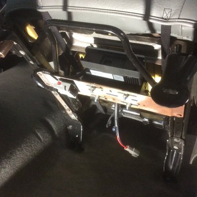

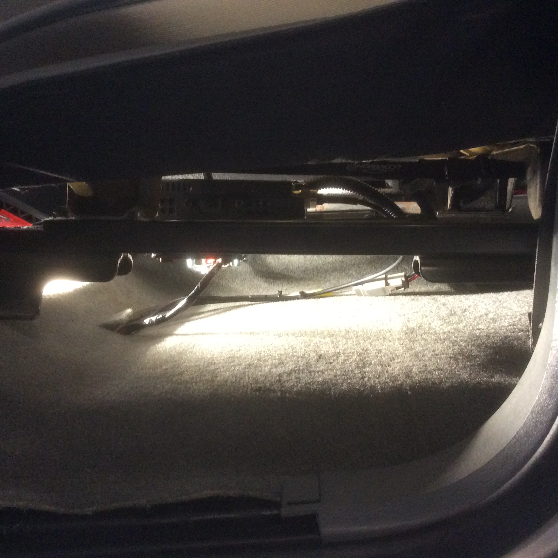

I've been too busy to work on my girl lately but yesterday I got a little time in and was able to install the ham radio under my drivers seat. There's a little crossmember between seat tracks that is perfect for mounting a radio onto. Also got the power feed ran up to the firewall bulkhead.
Re: Boogie wagon take 2
Sweet!!!! What a fuckin cool spot!!!!! Wish I thought of that dammit... I just run mine to cigarette lighter still after all this I realize I should have bought a Spod

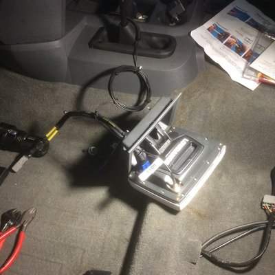

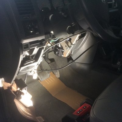

Also got the locker/swaybar switch module relocated under the dash so my air toggles can take their place!

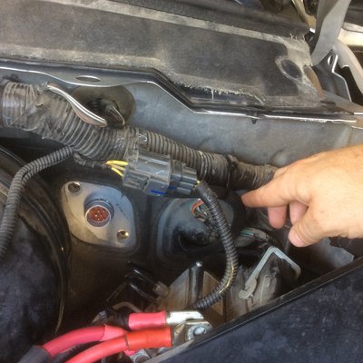

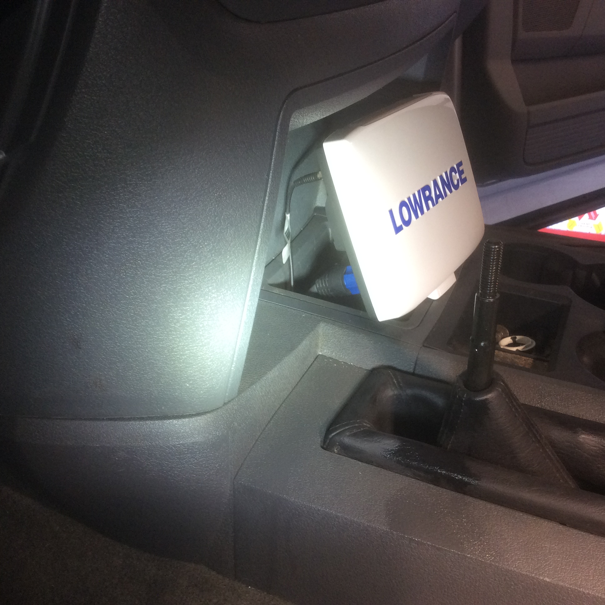

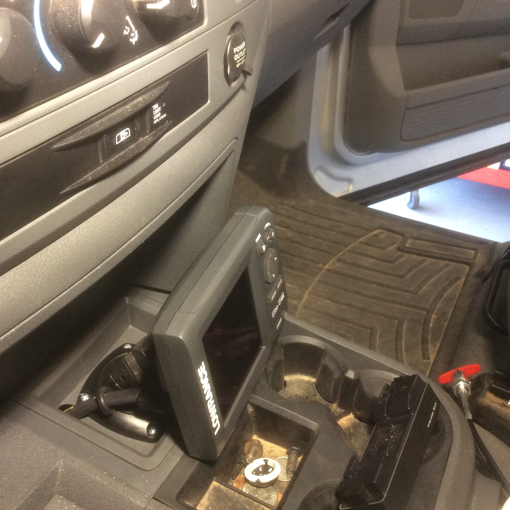

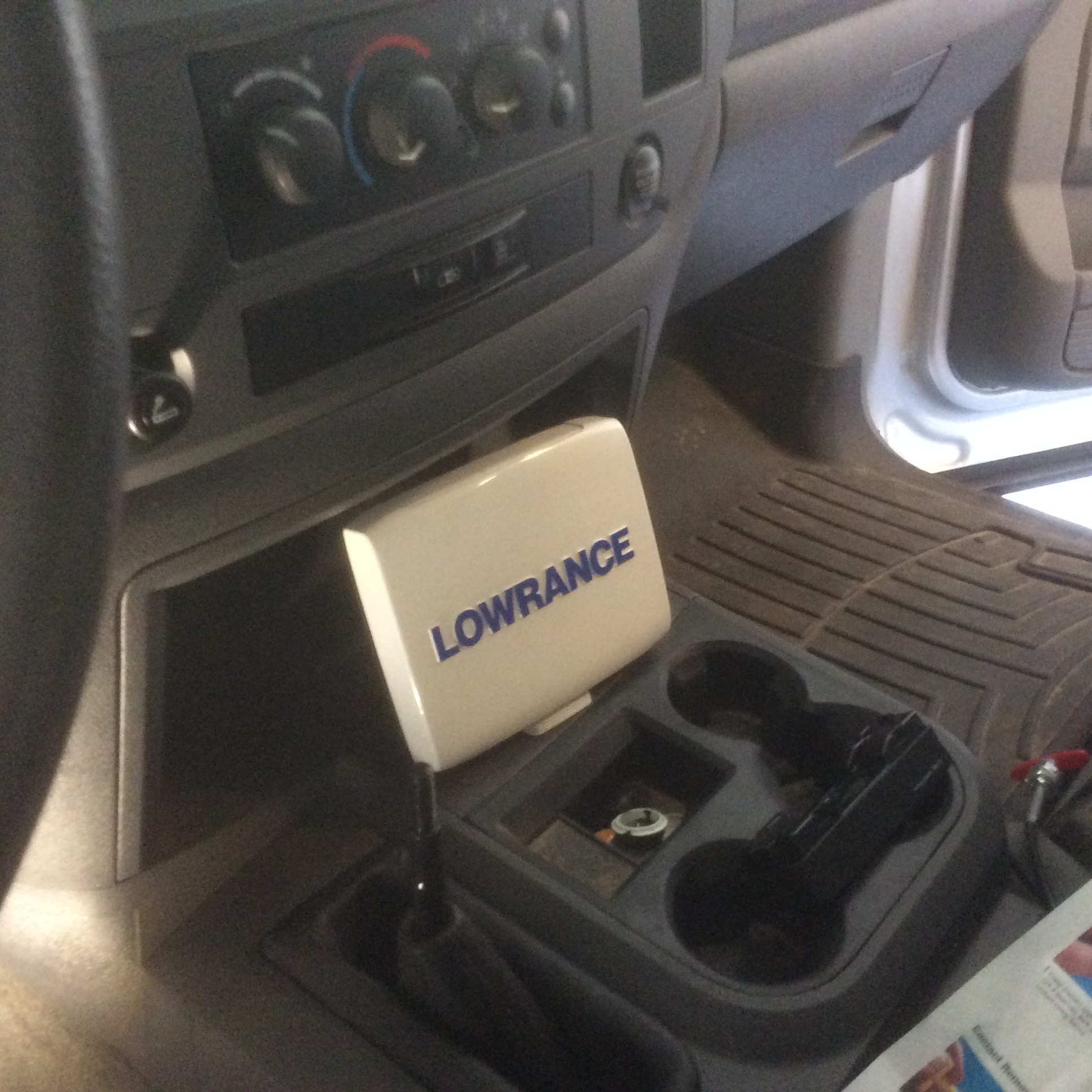

Aside from the gps antenna cable, all the interior wiring is buttoned up! Everything runs through the one firewall bulkhead connector. It's a deutsch hd30 8 pin rated at 25 amps per wire.
Also got the gps mounted permanently in the cubby tray in the center console. Drilled for the mounting screws and a pass through for the cables with a rubber grommet. Fits like it was made for it

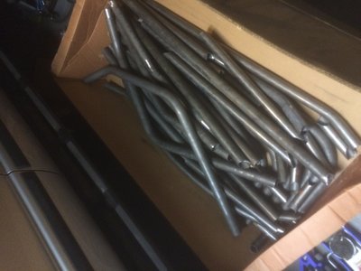

Took delivery of the roll cage, it's very well done, can't wait to get it burned in. I had to take my front end apart to reclock the grease fittings on the lower ball joints. If you put them where Carli recommends the zerk is inaccessible with rcv axles. Put them exactly opposite and alls good. Front ends almost back together. Should be able to measure for driveshafts this week and be off to the fab shop soon.
