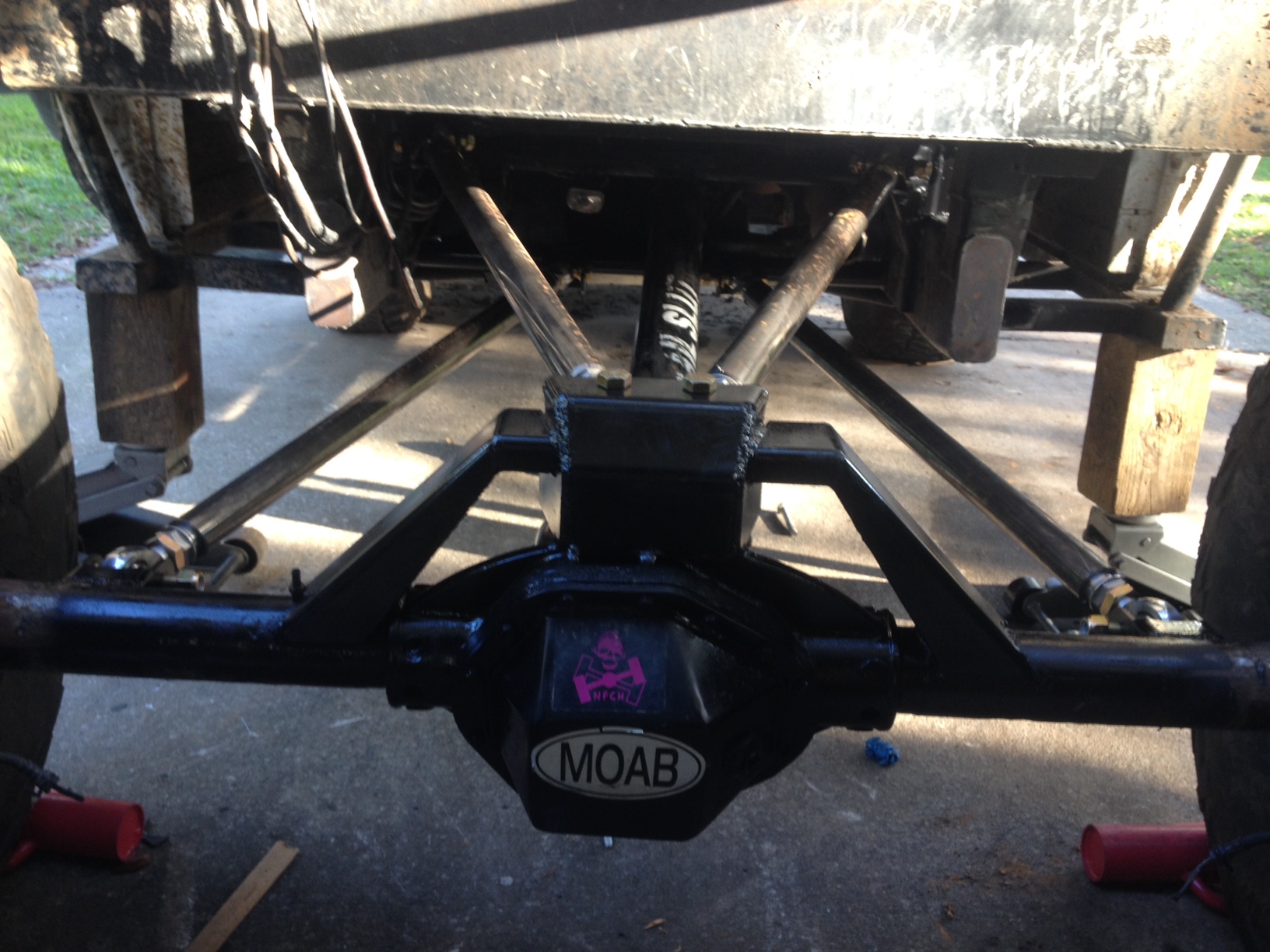

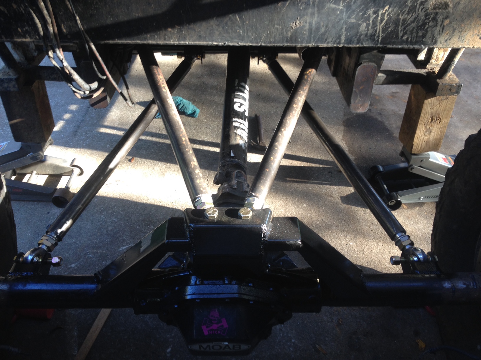

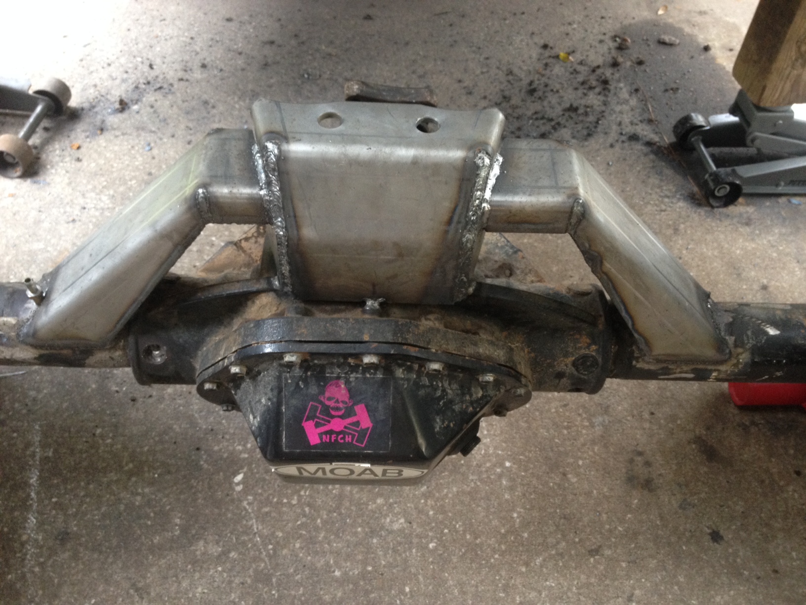

got more shit done today. Cleaned up the frame, cut it further back, added 1/4" plate steel to stiffen it up.. Cleaned up all the old brackets, Cleaned up the rear axle and install the upper brackets etc.etc.
Tom I will install the upper and lower triangulated links and will have them welded in and tested. Setting up the new shocks to run a 60/40 set up with the ability to go 70/30 for hardcore rock crawling AND will have the ability to turn them up to hit a 40/60 for desert running if I choose.

gettin' it done... ALL angles/anti-squat,COG, parallel 80/20, pinion angles etc.etc.etc. DIALED IN!!!!!!!!! Pain in the freaking ass!!!!!!!!! But LOVE the results.... off to bend some tube and get this bitch DONE!!!!!!!!!!!

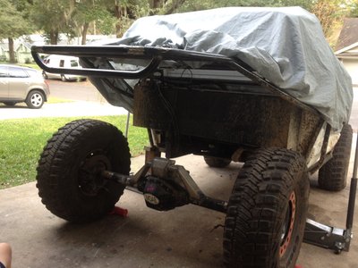

got more done today.. slow going trying to make sure ALL measurements are correct, and with no binding.
Re: boob here with a built Dodge ram Expedition rock cralwer
first pic was an accident of my kids.. sorry.

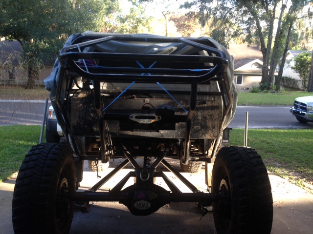

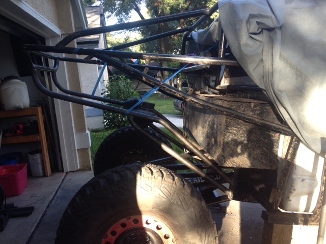

the rear looks tall in the photos, but that is NOT ride height.. It is about 4" too tall, and the rear axle is not in postion, it will slide back about 3".. The truck set at ride height looks PERFECT!!!!!!!!

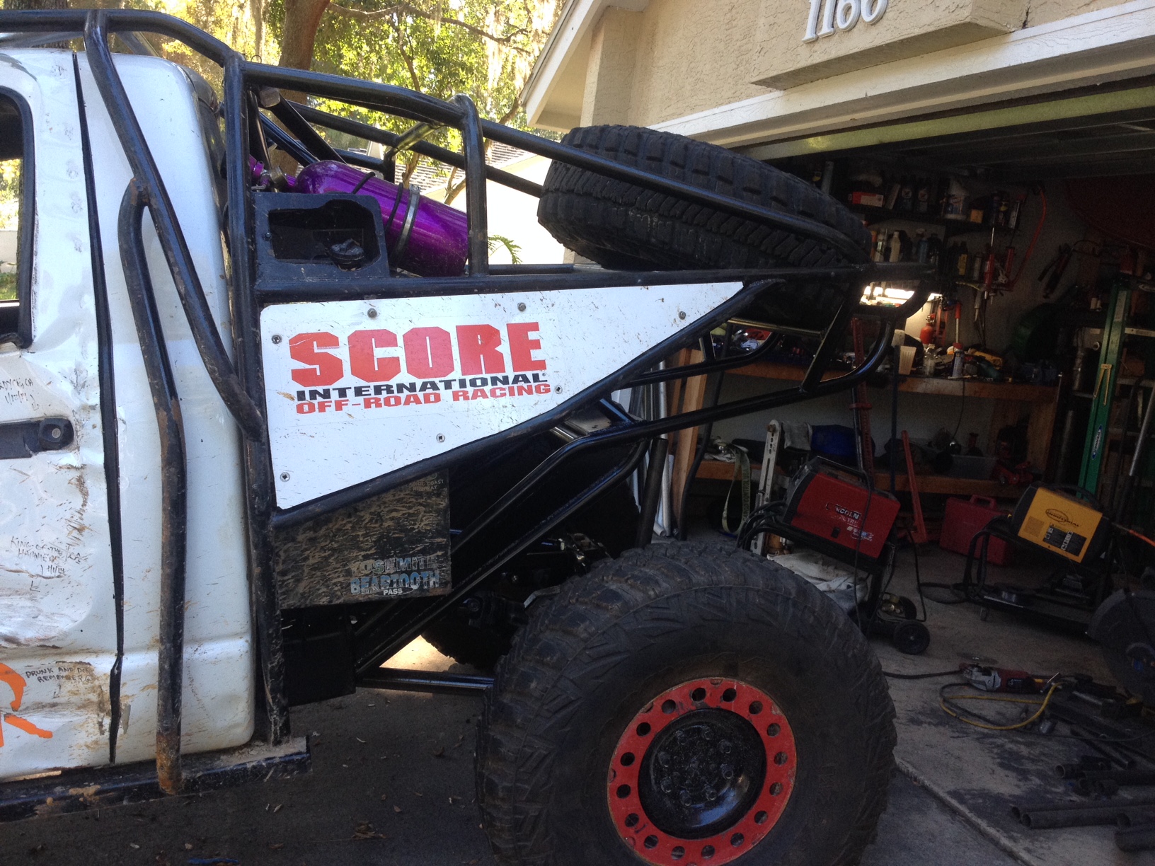

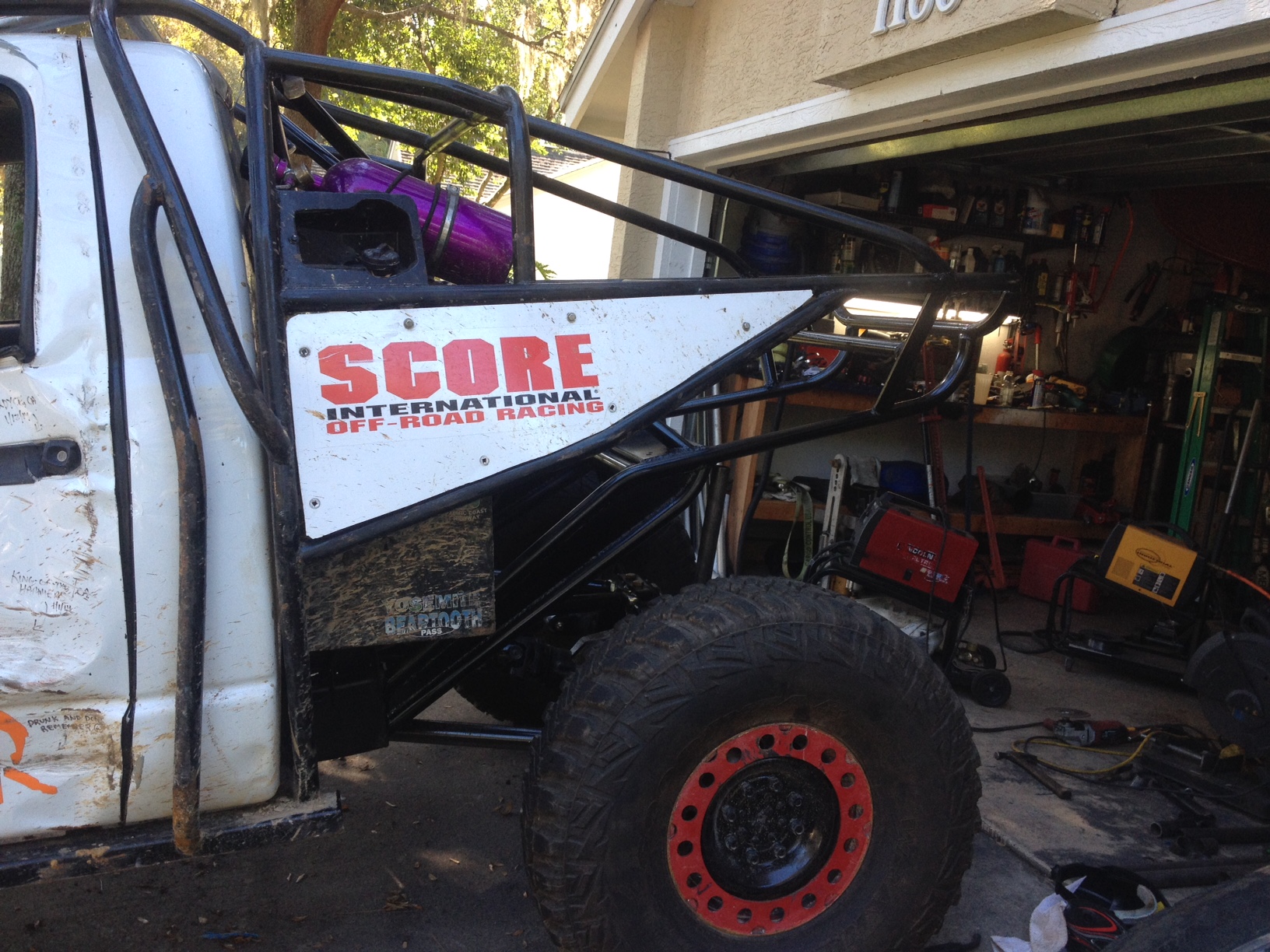

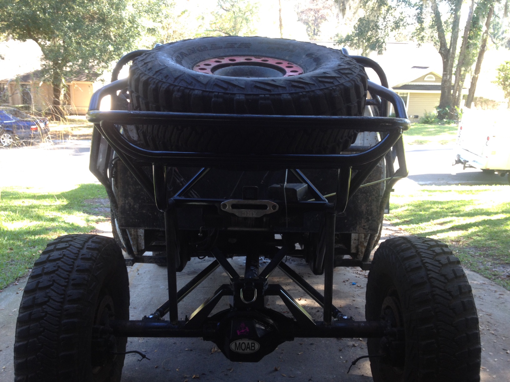

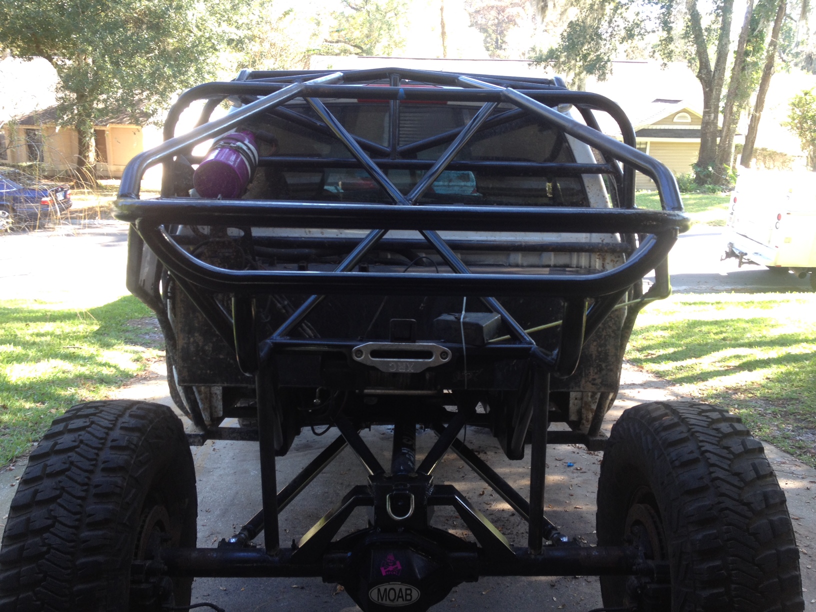

Finished the rear truggy. Plated in the rear Trug off the frame. Completed the V supports and tire carrier cross supports/. Items left:
1) Torch off the factory rear brake caliper brackets and move to the top of the axle/rotor and re-weld
2) Brake lines)
3) Wiring for the rear squat Winch and Rear LED/brake lights
4) Install and Fab up shock mounts???????JUST WAITING ON THE FREAKING SHOCKS!!!!!!!!!!! 3 weeks for KING to build them
THEN ON TO THE FRONT 3 link//full hydro
2) Brake lines)
