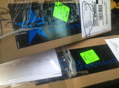

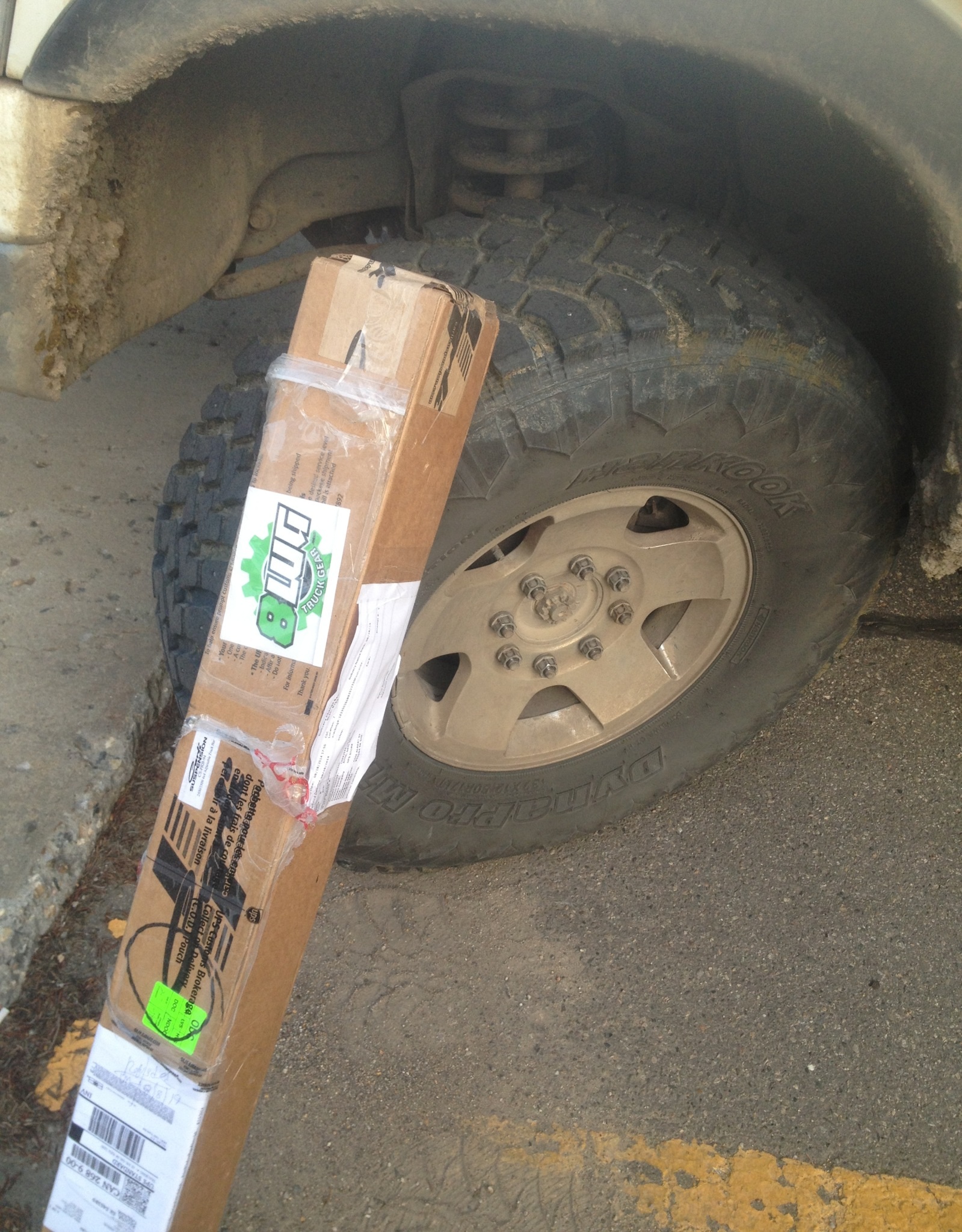

Teaser pic. Box one. Others Gould arrive thurs or Friday. I. Think ill install this one tonight. Supposed to thunderstorm tomorroe
Re: PW Chase Vehicle Build By NEO
Oooooo look at that sticker....o ya track bar is nice too haha
So far I've collected the blue red and now green stickers. Hopefully George sent me a differnt one with the control arms
Haha nice

Well i got two more presents. Gonna try to install this weekend
