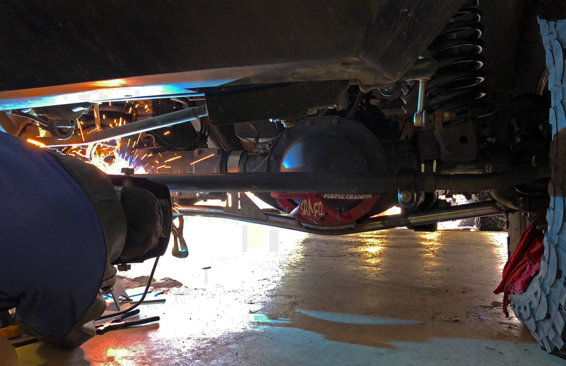

At a secret location in Oregon, I met up with DamageWagon to get a Thuren Axle Truss welded onto the front axle... Now it's time to crash.
Re: BoldAdventures 2015 Power Wagon Build

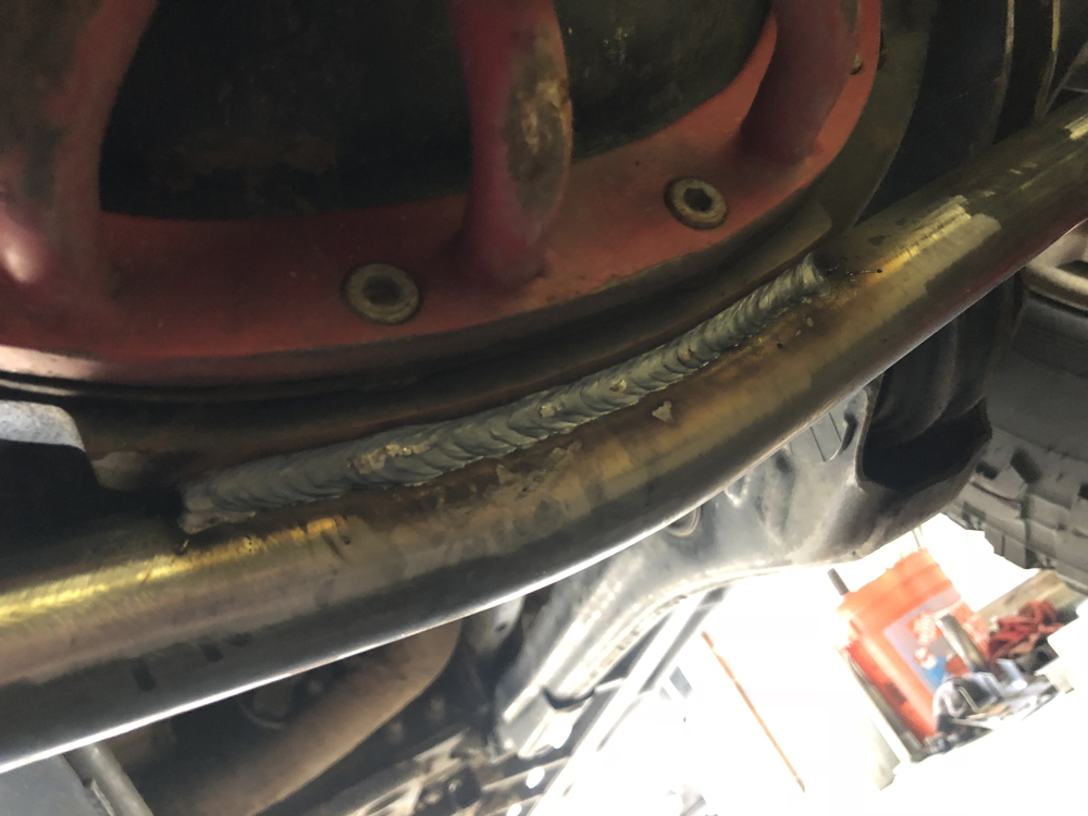

How close is the truss to your diff guard?
About this close...
We ended up not needing to change any diff fluid.

Thanks for the picture.
Good weld!!!!!! You planning on Baja/Desert Racing/jumping your rig?
Did you go ahead and weld up the axle tubes to the Housing?

No, I’m slow. But I don’t want to break stuff or have axle tubes spinning with 40’s.
And, yes. DamageWagon did the work. I’d post more photos but the weather has been crap. 3 inches of snow. As soon as it melts I’ll update the thread.
