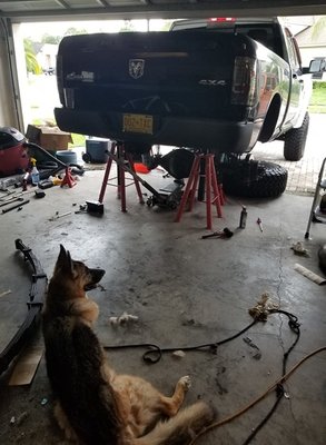

Re: bstefanic's Build - 2013 2500 - "Wanna Be Wagon"
Finally making progress on the truck...new ring and pinion in the rear. Turns out the shop that installed the gears didn't torque down the crush sleeve correctly and as a result allowed the pattern to essentially be fucked. Working now to get the original shop to reimburse me. Dynatrac hubs are on, glass is somewhat fitted, and LT leafs are on. Turns out the 40"s are going to be an epic pain in the ass to completely clear at cycle
