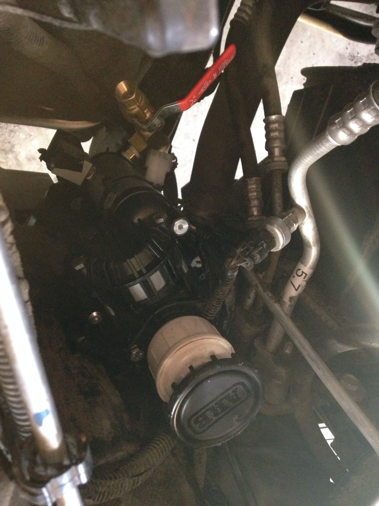

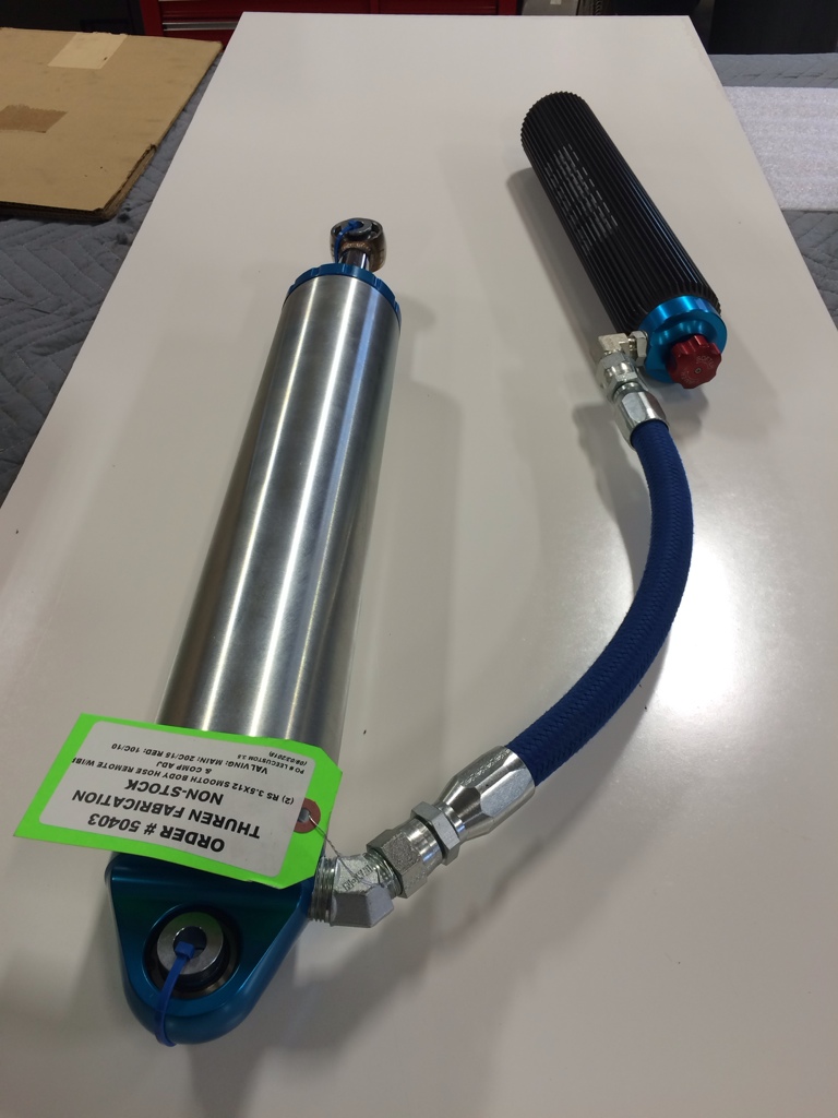

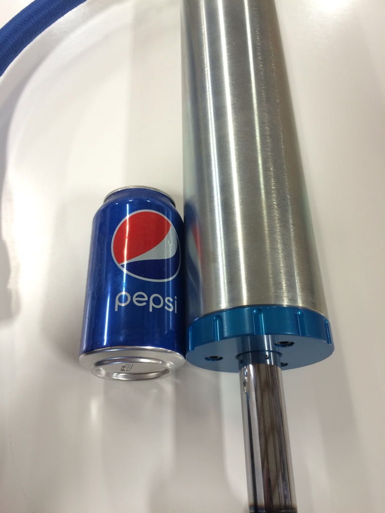

Whoot whoot! Some comparisons for sizes
this is a mini can anyways according to Aaron lol
and I found a spot I'm happy with to mount the air compressor! Obviously alittle higher than where it's sitting but on that pillar rf of the engine bay. Should leave me enough room for snorkels and stuff too if I go that route one day

by nts007 » Tue Jan 12, 2016 10:21 pm
You're not fooling anyone using those new calorie wise mini Pepsi cans there. Sweet though dude. I think you need more truck for those things. Maybe a diesel swap next

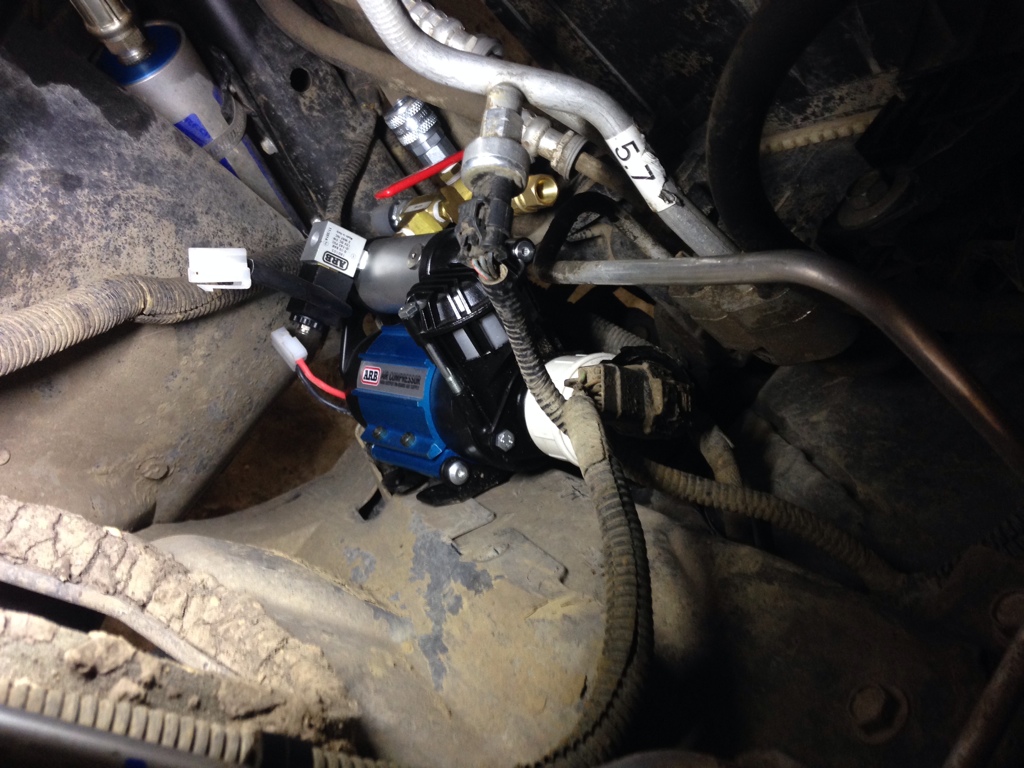

by 2wagons1driveway » Sun Jan 17, 2016 10:21 pm
got the arb in put a desiccant moisture filter on it also. As I'm told exterior compressors are very bad for filling the arb locker with moisture so hopefully this will help. And they were like 1$ I will keep an eye on it and make sure it doesn't plug up.
Sent from Canada
Post
by 2wagons1driveway » Sun Jan 17, 2016 10:26 pm
Just have to plumb the locker and figure out a quick connect area for the soft air locker line above the axle that way if one tears I can replace it quickly and easily! I must say wiring the compressor looked daunting with all the switch plugs and what not but it was way easier then I expected. There's really only three connections at the battery and the IGN. And the dash illumination and everything works nicely!
Also have to rig up my air line from that shut off valve pictured to the 5 gallon tank I have but first I have to chop out the factory spare tire mount...

by 2wagons1driveway » Sun Jan 17, 2016 11:03 pm
The air line that comes from arb is actually unique to them it appears so all the fittings and shit all have to be 5mm.... I thought about big rig brake system line but couldn't find the right sizes
Colibri is sending me some extra stuff and the quick connects are like 20$ at 4 wheel parts

by 2wagons1driveway » Sun Jan 17, 2016 11:19 pm
Totally! I was going to do synflex down the whol frame then just a small union/ quick connect for a blue line section to the axle this way like I said it's easily replaceable with a spare kept in the truck in case ice or something takes it out. I'm going to route it with a hard protective outter layer and mimic the brake lines and and sensors so this way it has a smooth path to follow and less likely to be seperated and cut away.

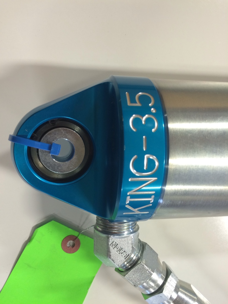

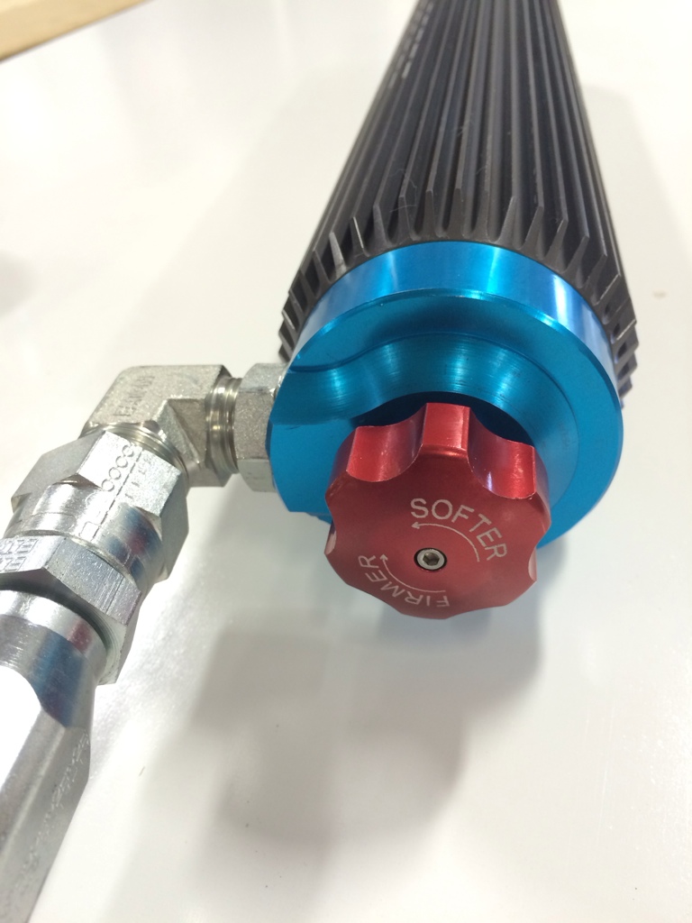

At what point do you consider the c-gusset?
And those 3.5 kings look are very heavy duty.
Just put my order in for some king 2.5s. Think I have shock envy!

Black Pearl wrote:I just trip on how much you guys know about this stuff.
I learn from lots of peoples mistakes and my own lol!
You should consider a truss (c gussets are a secondary truss... Apperantly there's no evidence they are actually required...) if/ when your trucks wheels ever leave the ground even accidently or at slow speeds. If you want to get the most out of those kings look into a Thuren truss. It's a big step but those 2.5's will literally out run your chassis quickly. Everything will feel so smooth the faster you go untill bam! Shit let's go lol
C gussets I think are just to ease some peoples minds
If the main truss is installed properly the knuckles shouldn't ever move-according to don Thuren. The few knuckles he's seen move was actually a truss bent!

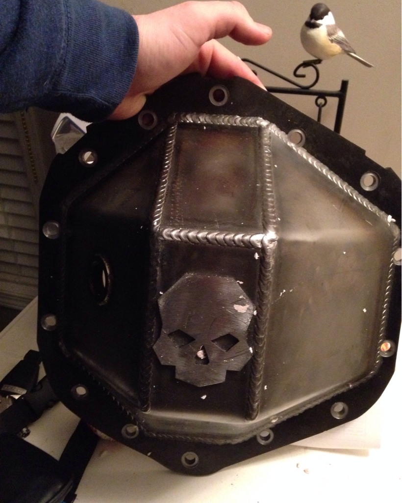

by 2wagons1driveway » Thu Jan 21, 2016 12:23 am
thanks Tim!!!!!!
(Colibri)
Ballistic fab cover for the new rear axle super stout and well made! Extra capacity as well keep them 5.13's happy.
I will install shortly after my 500 mile break in fluid is done
Sent from Canada

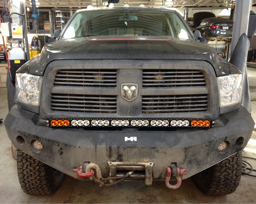

by 2wagons1driveway » Sat Jan 23, 2016 8:55 pm
china bar
