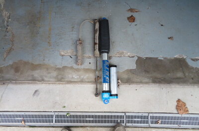

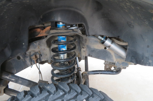

Got the Kings installed. :rockon: They're 2.5 valved. They're softer then what I thought they would be.

Damn it, for some reason I can't see your shock porn pics!

I posted the pic's like I always do.

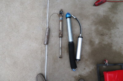

On web view I can see it. Thick shafts...lol. what did you wrap them with?
Cheap clear vinyl from Amazon.

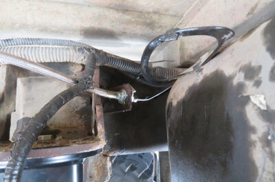

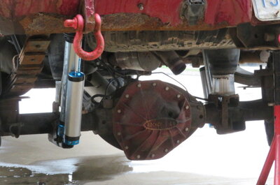

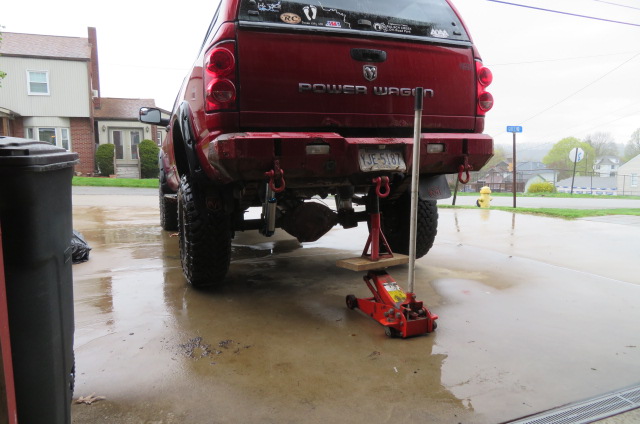

Did more work on the truck today.
1st pic. Got lots of suspension travel in the front.
2nd pic. Measuring for limit straps to keep the front springs from falling out. My 14.5' Carli straps are too short. Need around 16" straps.
3rd pic. Replaced the rear brake line with a 4" longer stainless brake hose. And added spacers to my air bags to keep them from pulling apart. The rear suspension has lots"of suspension travel too. Enough that my rear drive shaft hits the rear cross member.
4th pic. The PITA braKe line to brake hose junction. Sprayed the chit out of it with Blaster. The line wrench started to round off the flare nut. Got my small pipe wrench out, and worried that nut loose. Took me a while, but I got it. Got great brake pedal now.
