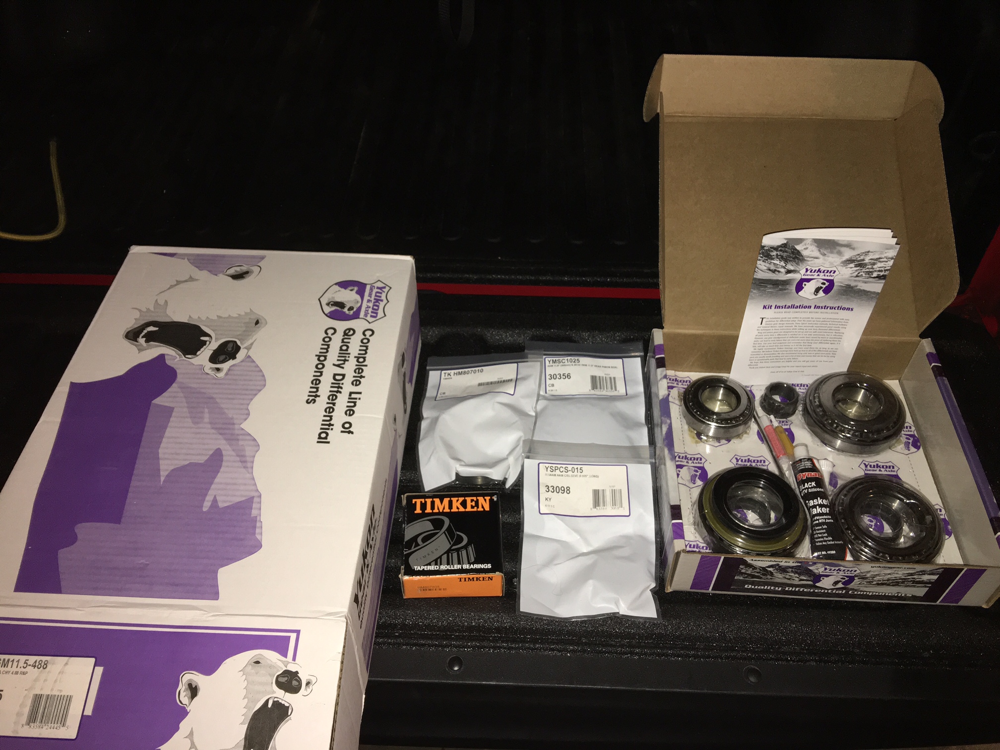

4.88 Gears arrived
It's a FEDEX Christmas
MOD : 4.88 9.25 front & 11.5 rear AAM R&P swap + complete master installation kits
MFGR : Yukon
Vendor : Randy's Gear
COST : $375 Rear R&P/$330 Rear install kit/$245 Front R&P/$215 front install kit/$60 front & rear lifetime warranty
Researched the required parts needed to do complete front/rear gear swap, called EastCoast Gear & Randy's & shopped both for best price. Ordered everything from Randy's last Friday around 1630, everything arrived on Monday morning. The packaging & overall presentation was exceedingly high quality & definitely conveys a sense of pride & inspires confidence. I ordered the total lifetime warranty ($29 ea) which is essentially just prepaying the shipping cost--warranty is no questions asked forever, anything happens to either gear set, Randy's will FedEx out a replacement set & the install kit free of charge & will cover the install cost of the new set. Set up the install at a local heavy truck rebuild shop down the road for Wednesday, 4 May.
MFGR : Yukon

Got the rear Yukon 4.88 swapped for the AAM OEM--maybe not as strong, but I think an overall better choice.

Gear Headaches
I have all the correct bearings, install kits, and gears (swapped out the Yukon 11.5" 4.88 for the OEM AAM 4.88--Randy's was awesome to deal with). Now I just need to find a shop willing to install it. The diff shop near me called today and said they'd rather not work on my truck because they aren't confident they can do it correctly with the tools they have on hand....I've been looking on line for nearly 2 hrs now, and I can't find a single shop within 3 hrs drive that even remotely sounded confident they could tackle the install...
edit: Ok, I did find a shop in Columbus, Oh, Babbitt Gear & Bearing Co (1.5 hrs away), that was closed, but the owner's wife sounded very confident they could do it no problem, pending confirmation with tech tomorrow--but I'm tentatively scheduled for next Friday the 13th.

Strange, these axles are relatively easier to work on than Dana Spicer equivalents. Guess people just aren't as familiar with them? Good luck with Babbitt! Should have some more pep in your step soon!
