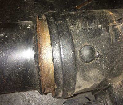

Find a talented welder and full circle weld the tubes to the pumpkin as a stop gap measure for when you order and have installed Dons new low profile truss kit. You need to do this welding of the tubes ASAP! Both front and rear axles! My preference is TIG welding.

Do you need to remove the axles and bearings to do this or just drain the oil pay attention to where the ground is located?

Congratulations on the shocks! You won't be disappointed. When it comes to welding the tubes to the center sections, the rear is relatively easier, the front has seals inside right where you're welding and if you put too much heat into the axle you'll need to replace them which requires pulling the carrier. The most correct way to weld to cast requires you to pre and post heat the weld effected area and wrap it in a welding blanket to cool slowly. It should also be impeccably clean (which is difficult on porous cast) and done with rod that has high nickel content. Either tig or stick are preferable. You could just mig it on there and cross your fingers but cast becomes brittle in the weld zone done that way and if you take a hard hit the weld bead will simply snap off from the cast. My first trussed axle was with the Carli truss and was mig'd by a professional who owns an off-road fabrication shop (builds ultra4 buggies) and when my axle bent the tube seperated from the center section pulling the weld bead clean off the cast. Some weld is probably better than no weld for all but the worst oops moments though, but if not done correctly its just false security in my opinion. Long story short circle welding the tubes is a great idea but don't bother unless you can do it correctly

Understood, I'm familiar with welding and know cast can be tricky, I'll call around and see if I can find someone relatively close that is more familiar with the cast.

Colibri wrote:Congratulations on the shocks! You won't be disappointed. When it comes to welding the tubes to the center sections, the rear is relatively easier, the front has seals inside right where you're welding and if you put too much heat into the axle you'll need to replace them which requires pulling the carrier. The most correct way to weld to cast requires you to pre and post heat the weld effected area and wrap it in a welding blanket to cool slowly. It should also be impeccably clean (which is difficult on porous cast) and done with rod that has high nickel content. Either tig or stick are preferable. You could just mig it on there and cross your fingers but cast becomes brittle in the weld zone done that way and if you take a hard hit the weld bead will simply snap off from the cast. My first trussed axle was with the Carli truss and was mig'd by a professional who owns an off-road fabrication shop (builds ultra4 buggies) and when my axle bent the tube seperated from the center section pulling the weld bead clean off the cast. Some weld is probably better than no weld for all but the worst oops moments though, but if not done correctly its just false security in my opinion. Long story short circle welding the tubes is a great idea but don't bother unless you can do it correctly
X2 and a very good explanation!

the whole reason we weld the tubes is to not allow the tube to "push" into the diff after it's trussed.
Picture the truss and picture the weak point as we all know now being the long tube it still wants to push up but instead it breaks the plug welds and pushes inwards a bit. FYI congrats on the new kings they will take awhile to build! But well worth it! Control is addicting
