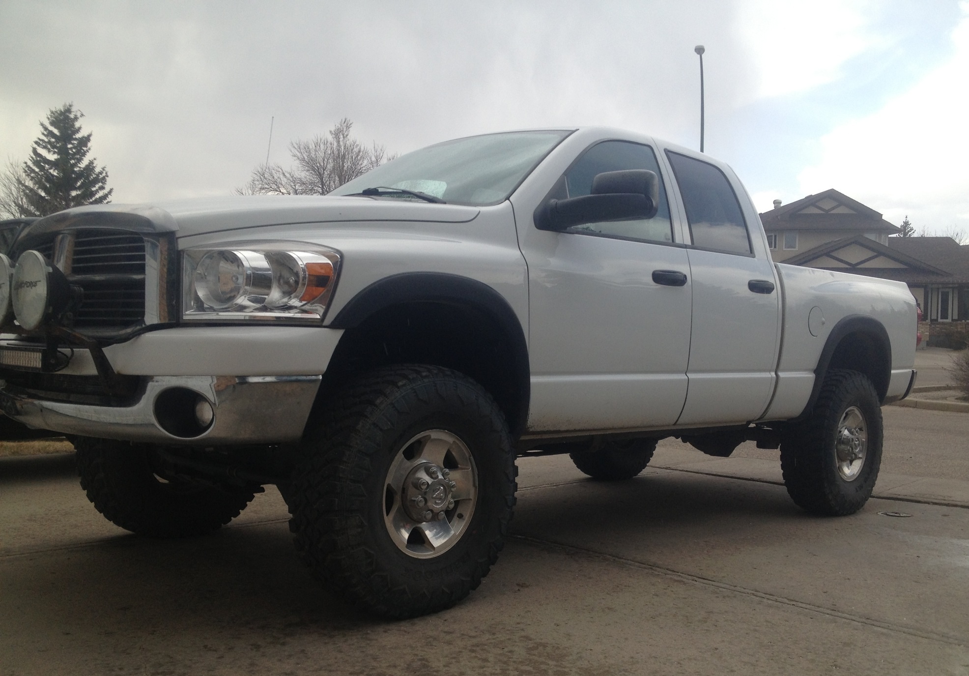

Any tire-body contact when you fully flex the entire truck? It looks real close the way it sits, so I'm currious what the tires do when they're stuffed into the wheel wells? I'm thinking the next set of tires will be 37's for my 2009...
Re: PW Chase Vehicle Build By NEO
Post by nts007 » Mon Mar 31, 2014 1:35 pm
Nothing so far. Flexed the rear doesn't rub but drop a yard of gravel in and they will rub on bumps. That's what happened in my 06. The curbs and snow banks haven't caused any issues yet and nothing while driving. It's usually just plastic that gets in the way

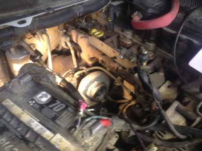

Well swapped the turbo. Factory one was toast.
Out with the old
Big and bad
So empty
There it is!!

So got a couple thousand km on the setup now. Everything's awesome. Rpms are higher but mileage is still awesome. Sitting between 19-21mpg. With 37's. No complaints. Now need to hook up lockers and sway bar disconnect. Then winch mount planning. Had some nasty weather blow in. Really icy and heavy snow. Very glad i got these tires studded. Made a huge difference.

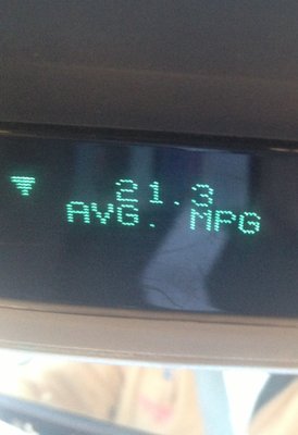

I feel a little bad for posting this. The advantage of the diesel. But the difference in front end weight is noticeable.
This is today's 445km average

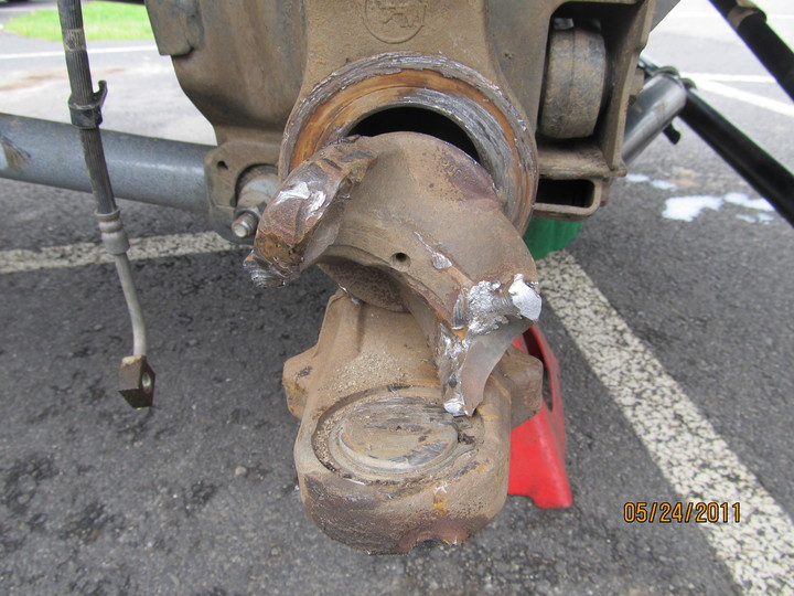

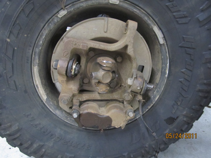

This is what happened to the front end of my Dodge diesel with the added weight on the front end. Granted I bounced all over a creek crossing among other things. Still it takes some weight to break a 1-ton knuckle. Hence why I now own a Power Wagon with 5.7 Hemi!

Damn that looks painful. I know i won't be pushing this truck like i used to push my pw. But like you said it takes a lot to break em

Just installed a set of bilstein 7100s from carli. Upgraded from 5100s. Just did fronts for now. I was expecting an improvement. Not a total mind f@#k!!! They are a thousand times better. My truck has been really harsh in washboard and small bumps. Now the front is unbelievable. And now its apparent how bad the rear is by comparison. So now gotta order up the rears. But seriously. WOW!! What a difference. Couple pics
