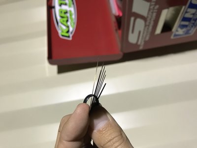

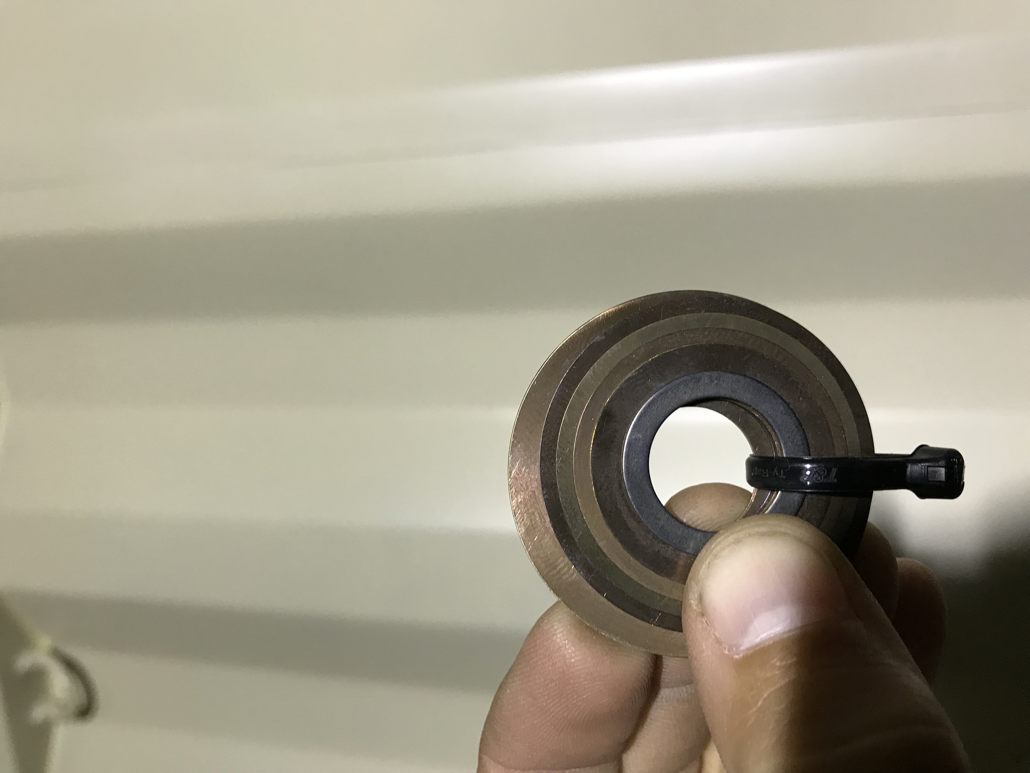

Here’s what the shims (valving) from a king 2.5 look like. This is the compression stack from my other truck.
