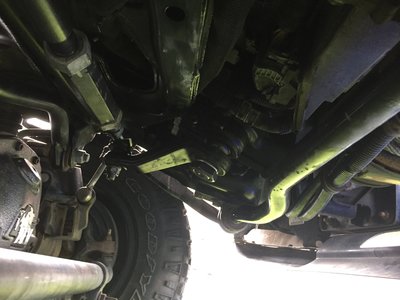

Post by AlterEgo » Sat Jun 24, 2017 9:16 am
It has been awhile since I have posted on here. I know have the AEV lift for 40" tires installed. I am not running 40's, but I needed the axle pushed forward because of the rims I am running. I also have the AEV diff covers front and rear. Most recently the PSC Hydro assist steering kit.

Re: My 2014 build
Post by Colibri » Sat Jun 24, 2017 10:02 am
Looking good! How do you like the steering ram thus far?
AlterEgo
Posts: 40
Joined: Sun Oct 26, 2014 8:35 am
My 2014 build
Post by AlterEgo » Sat Jun 24, 2017 11:28 am
Colibri wrote:Looking good! How do you like the steering ram thus far?
I really like it, not as light a steering feeling as I thought it would be.
What fluid did you use. I had to experiment and go really thin. I'm currently using mopar hydraulic power steering fluid p/n 68234631aa. It also the one spec for the 01-04 jeep grand Cherokee as it had a hydraulic cooling fan. Not electric. This fluid is nice and thin and works well in the cold weather and the psc ram seems to like it

Post by AlterEgo » Sat Jun 24, 2017 8:10 pm
ATF +4 is what is in it right now
Re: My 2014 build
Post by nts007 » Sat Jun 24, 2017 8:15 pm
Psc clearly states not to use atf. In every single piece of paper they have writing pertaining to power steering fluid it flat out says not to use atf. You now have a hydraulic ram. You need a proper power steering fluid/hydraulic fluid

Post by Colibri » Sat Jun 24, 2017 8:46 pm
Swepco 715 is what I use, and is recommended by both PSC and Howe. I don't know about northern climes but it works great down here in tejas

Post by AlterEgo » Sat Jun 24, 2017 9:41 pm
I had this installed at a shop, I will look at swapping the fluid out for a synthetic power steering fluid.
Thanks
Re: My 2014 build
Post by nts007 » Sat Jun 24, 2017 9:50 pm
I'd get mad at the shop. If you gave them the kit or they ordered the kit the instructions that come with it are very clear on what fluid to NOT use and what they reccommend. I hate it when others touch my truck. They always f it up.

Post by AlterEgo » Sat Jun 24, 2017 9:54 pm
nts007 wrote:I'd get mad at the shop. If you gave them the kit or they ordered the kit the instructions that come with it are very clear on what fluid to NOT use and what they reccommend. I hate it when others touch my truck. They always f it up.
I like your air tank mount. Looks solid!
They said that it is a re-geared factory steering box so to use factory fluid.
The mount was not that secure at the top so I used a hose clamp to connect it to the C clamp holding the tonneau rail. Nice and tight now.

Post by nts007 » Sat Jun 24, 2017 10:02 pm
Haha those hose clamps come in handy all the time.
Truthfully the only reason the factory used atf in the steering system is to save cost. One fluid for the majority of the units. Is it the best fluid for keeping the chain lubed in the t case? No. But it works well enough to last past warranty. It's what Chrysler does. Changing the fluid to what psc recommends will improve your assist power and make it that much easier

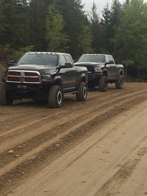

Post by AlterEgo » Sun Aug 20, 2017 6:30 am
I did a little cutting to stock bumper
AlterEgo
Posts: 40
Re: My 2014 build
Post by AlterEgo » Sun Aug 20, 2017 6:32 am
Got my 37's on finally
Re: My 2014 build
Post by Will » Sun Aug 20, 2017 2:36 pm
It looks good but looks low to me due to the offset.
AlterEgo
Posts: 40
My 2014 build
Post by AlterEgo » Sun Aug 20, 2017 11:43 pm
Will wrote:It looks good but looks low to me due to the offset.
I like it low, clears the 37"s with no rubbing. No extra height required for my taste. The offset is pretty crazy but I love those wheels.
NickPic83
Posts: 109
Joined: Thu Nov 24, 2016 11:32 am
Re: My 2014 build
Post by NickPic83 » Mon Aug 21, 2017 6:37 am
Looking good. I really like what you did with the front bumper
AlterEgo
Posts: 40
My 2014 build
Post by AlterEgo » Mon Aug 21, 2017 7:35 am
[quote="NickPic83"]Looking good. I really like what you did with the front bumper
Thanks, it really did not take all that long to do.
