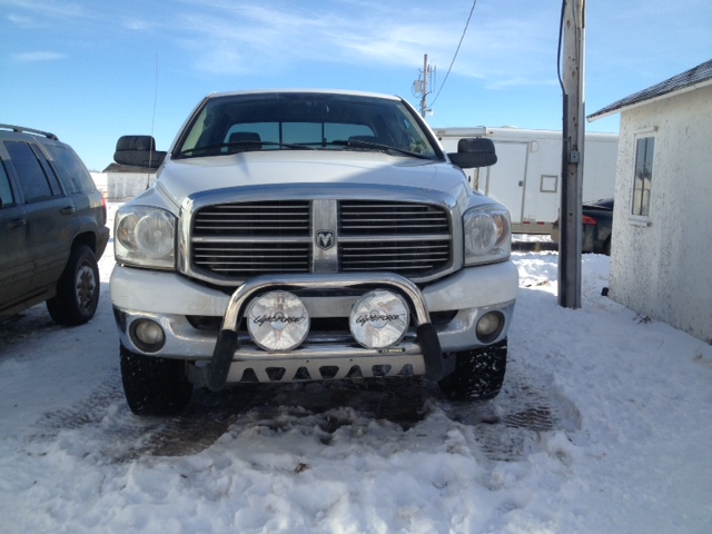

All right. Its not a PW. But it will one day play with them in the same sand box with the big rocks. Over time I will be building this up to be a Multi purpose Vehicle like the PW but keep it fully usable and reliable as my DD Work Truck. Here is a pic of the truck as it sits right now. I will post new upgrades as I get them On. For now it will be bolt on but soon som fab work will happen.
For Example.... I have a Winch, winch cradle, and a smart bar from a power wagon. ( I also have the POWERWAGON Embroiderd floor mats) Not a bad start. Now these will be installed in time. For now here is a picture of my Oil burner

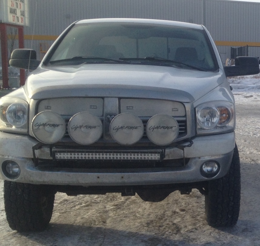

Finally Got the Lightforce on. This is on like this for now until spring when I get started on the Winch. Then they will be off and relocated.I have a 22" visionx led bar that I may tie in too but I have to convince my wife to let me take it off her jeep

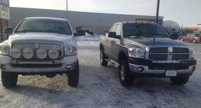

Here are some teaser pics. You will notice that the front bumper has been moved forward a bit.

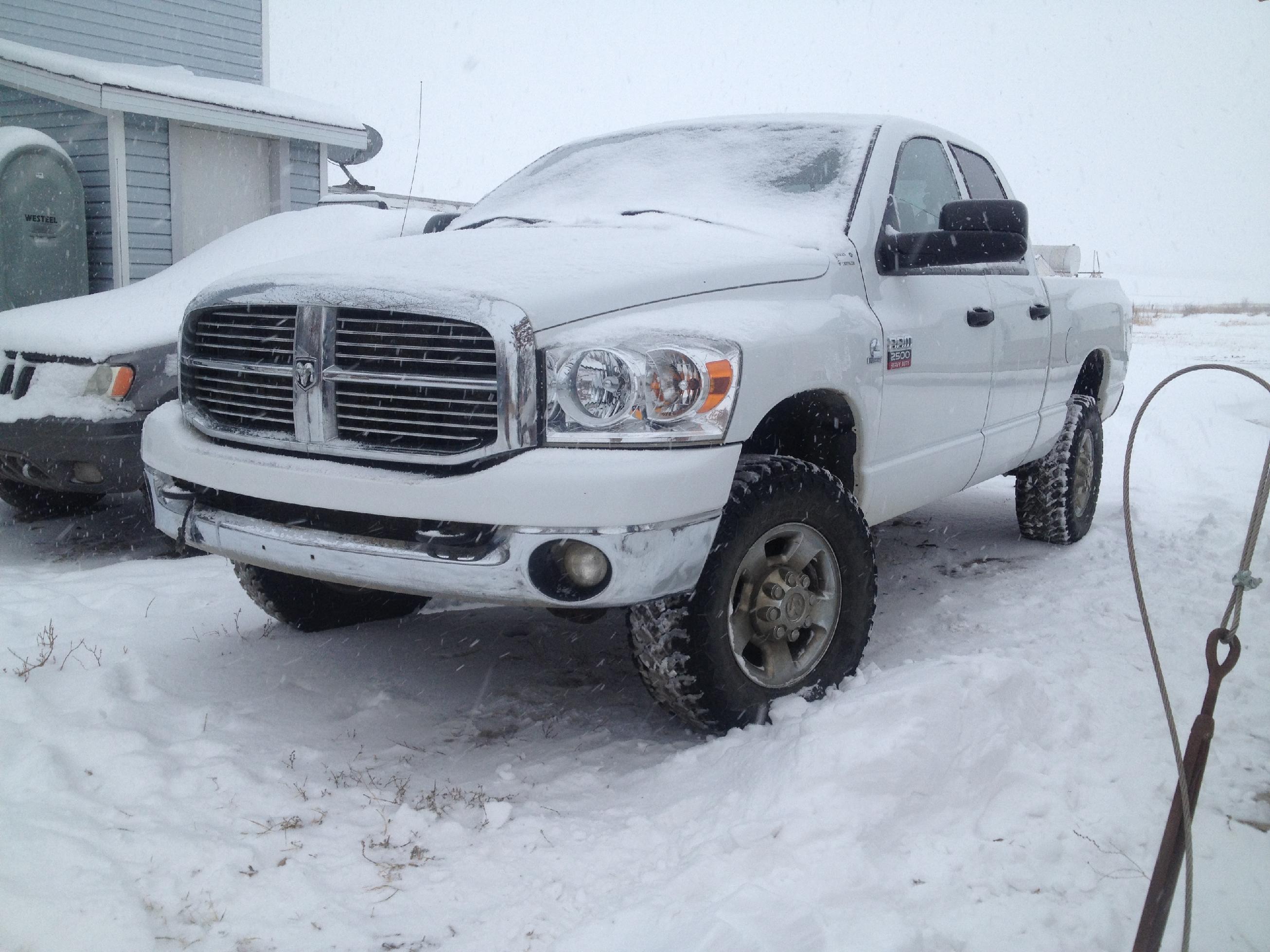

Been awhile since I posted here. Time to start again. I'm picking up a rollover pw next sat. Then debating if worth fixing or salvage. If salvage the axles and lots of the good stuff will end up on this truck.
Since I started this thread the ctd has gone through a few different lives. The hankook mt were replaced by bfg at's for last winter. Then come summer i picked up some general grabber mt's. Best tire I've had on a truck. Sad that I can only get them in the 35's and not bigger. For this winter i picked up toyo at2 extremes in 35. Well then the fun started.
Programmer wise i was running a smarty jr for the summer. Fall I picked up a h&s mini max tuner system. Full afe intake as well.
Well I decided that I wanted the height back. So I picked up a set of carli coils and rear leaf pack. I'm not impressed with either for street driving although when pushing really hard they improve. My plan is to replace the rear leaves with the pw's
This is actually finally getting off the ground guys. It was a rough year till the end so everything was on hold till now. Will keep you posted and start posting pictures again

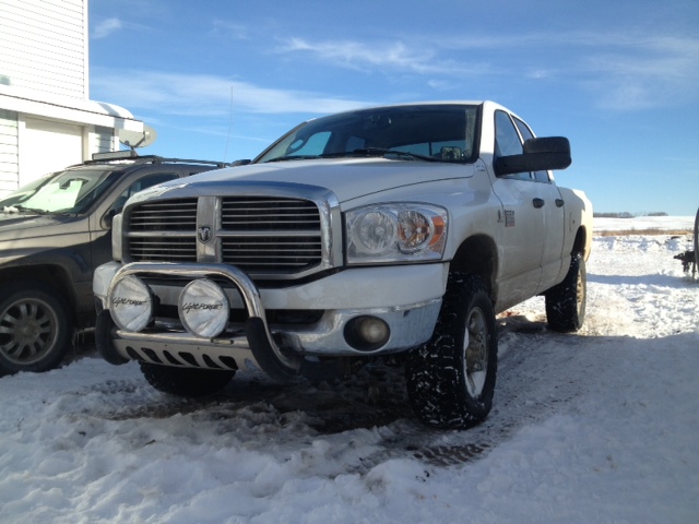

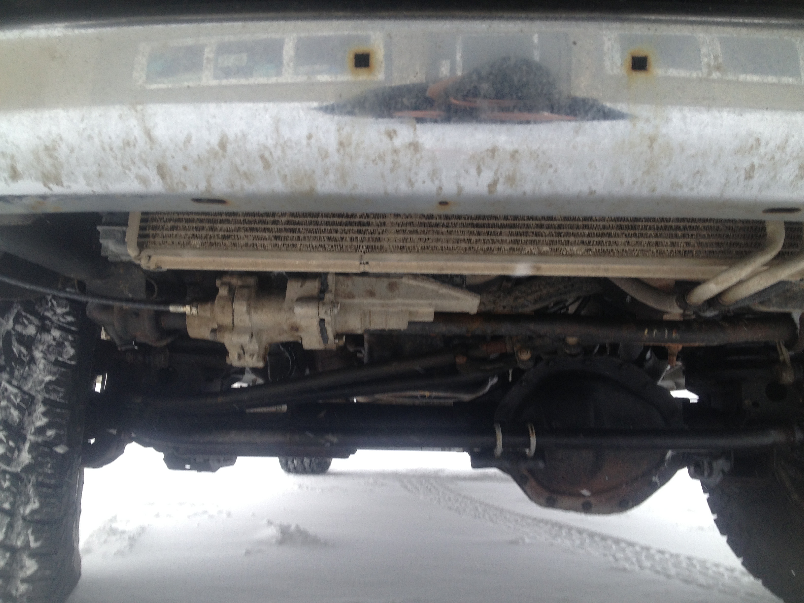

Here is a couple. I was parked next to a pw and was pleasantly suprised to see im on my way

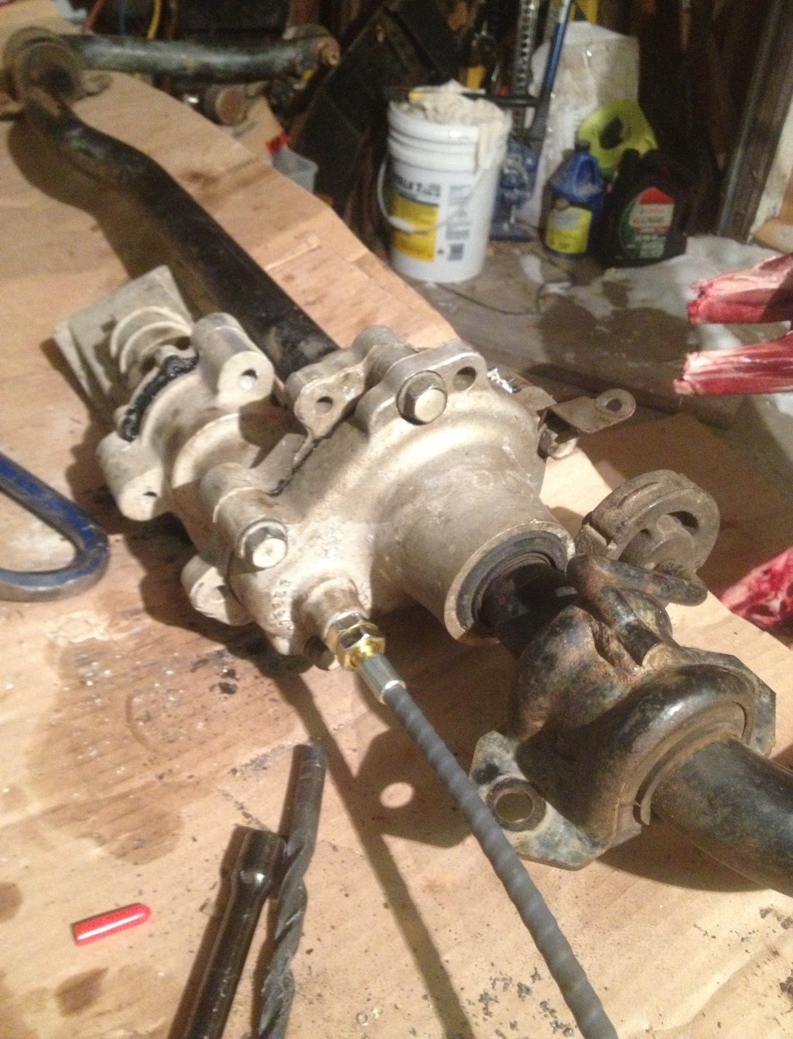

Currently the smart bar is installed on the truck and is cable operated.
As far as winch mounting I'm still considering options
Thanks for looking
Thanks for looking
Re: PW Chase Vehicle Build By NEO
Pic of the smarter bar
Nice work!nts007 wrote:Pic of the smarter bar
Thanks coder. Was something i had been trying to figure out for some time. I couldn't get the electronics to work so i went old school
