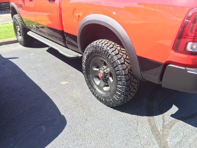

Tires, it happened, and they're 37's...
Post by adeluca73 » Thu Aug 11, 2016 6:36 pm

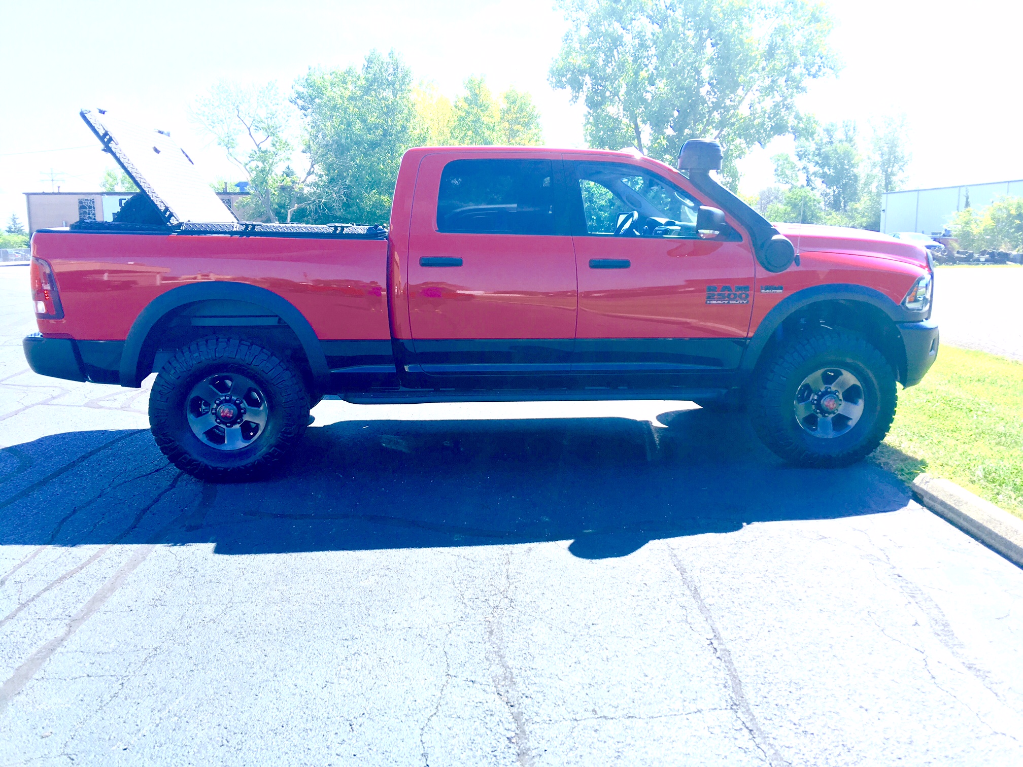

Ok, was able to drop the truck off before the movers showed up this morning. 37" Nitto Ridge Grapplers installed on stock PW wheels w/ 1.5" Truxx level, took less than an hr, had them air to -10% max (50psi Max) so about 45psi all around, measured height is right at 36.66", at 50psi they measured around 36.85", EVIC is freaking out of course, no correction available till AEV sells the ProCal or you buy a spendy programmer/tuner, speedo is off by 5mph according to the speedometer app I installed on my iPhone (PW: 35/Ip: 39, PW: 40/Ip: 45, PW: 45/Ip: 50, PW: 50/Ip: 56), tires ride great, way softer than the Duratracs (still had 12/32" left, so weren't as bad as I thought), and they are definitely quieter, did some full lock turns in the parking lot & no rubbing so far, didn't notice much breaking difference, but I drive like a granny, acceleration took a hit even with 4.88's, MPGs down about .5-1mpg, 1oz,1.5oz, 2.5oz, 4oz were the balance weights, they said the stock tires had over 20ozs glued all around the inside wheel. $1179 OTD installed & balanced, no hazard warranty, After 10 miles, couldn't be happier. Oh and bonus, sold my Duratracs in one day on CL for $125 ea :rockon:
No protruding
No protruding
Fills it up nicely
Good stance on 1.5" level, still ½" rake
EVIC freaking out

Looking goooood!
You got $500 for a set of stock duratracs with 27k miles on them?! You done did good! Were they spent or did they have some usable miles left in them?!

Off topic, but whats with the trailers with solar panels in the parking lot in front of you? Portable solar power?

quite a transformation for your truck. Great build so far

Yeah, I let them go for $400. They were actually at 11-12/32", so more than ½ life I guess, more than I thought at nearly 30K miles, and a little chunking on the side lugs from off roading up North, nothing too bad I think.
The solar panel trailers were mobile portable power stations for sale or rent.
