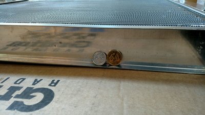

Post by Pit Slave » Mon Mar 23, 2015 2:48 pm
Pit Slave wrote:
gun45boat wrote:LOL I have been there many times... lol
PIT,,,, Do you have pictures of it installed? I need to get off my ass and get a larger radiator, especially since I plan on flogging the F$%K out of my rig in Moab... WOuld enjoy knowing that everything bolts together etc.etc. before ordering.. Thanks man,,,
No pics of it yet, I just ordered it so it will be about 2 weeks before I see it.
[attachment=-1]uploadfromtaptalk1427136313193.jpg[/attachment][attachment=-1]uploadfromtaptalk1427136379333.jpg[/attachment][attachment=-1]uploadfromtaptalk1427136484150.jpg[/attachment]

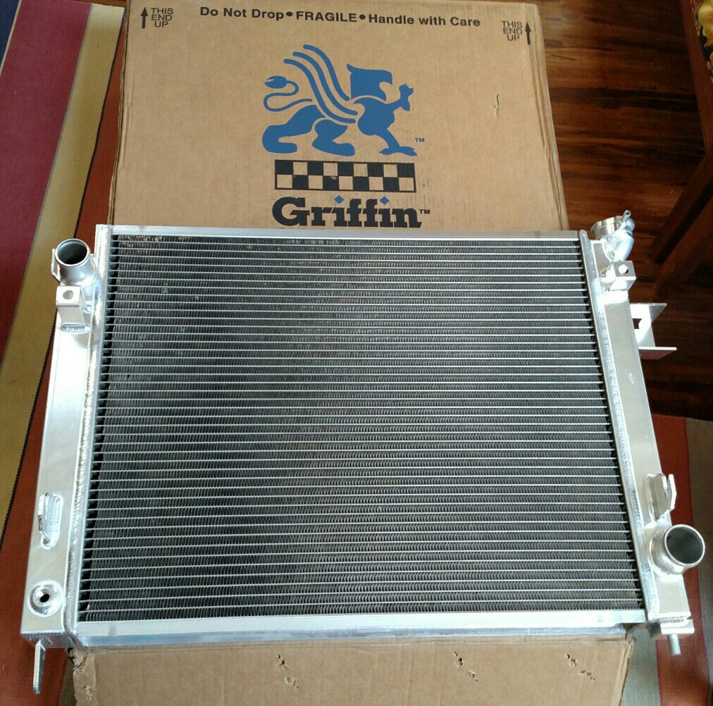

Post by Pit Slave » Mon Mar 23, 2015 3:04 pm
[attachment=-1]uploadfromtaptalk1427137430649.jpg[/attachment]

Post by gun45boat » Mon Mar 23, 2015 6:37 pm
HOLY SHIT!!!!!!!! That is bad ass!!!!!!!!!!! I will order one tom...... Hopefully get it before I depart for Moab on the 25th... Thanks for posting the pics of the radiator!!!!!!!!!!!!

Post by Pit Slave » Mon Mar 23, 2015 7:49 pm
FYI, the first pic is with a quarter and a dollar coin. Not a dime and penny. Lol
Pit Slave
Posts: 1486
Re: boob here with a built Dodge ram Expedition rock cralwer
Post by Pit Slave » Mon Mar 23, 2015 7:54 pm
gun45boat wrote:HOLY SHIT!!!!!!!! That is bad ass!!!!!!!!!!! I will order one tom...... Hopefully get it before I depart for Moab on the 25th... Thanks for posting the pics of the radiator!!!!!!!!!!!!
Dude, it ended up being a two week turnaround to the door from the time it was placed! Just call CJC off road and talk to Paul. Tell him you want what Pit Slave got. Also let him know I sent ya. ;)
