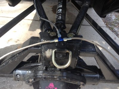

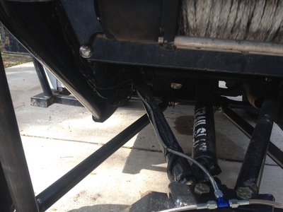

I know this will not go with your build, since mine is a little different, but it is VERY easy to cut you factory line from the frame and flange it to work with a braided system. ANY racing shop in you area with have most the parts you need for a "conversion" ie: lines in all sorts of lengths, fittings, 90's, 45's caps etc.etc.
I used all Areoquip parts and lines. it is easy to cut and flange from the frame feeder, then just tap and go:) I think I have about $90.00 in all the parts and pieces to make mine work with all the flexing that the 4 link will do. Pedal feel is VERY good.

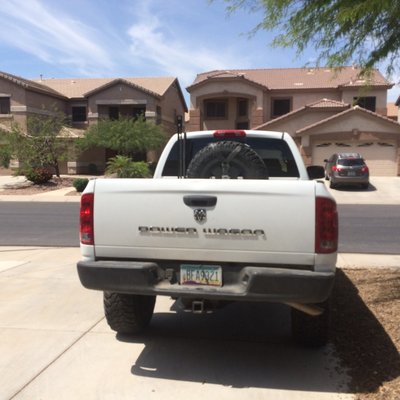

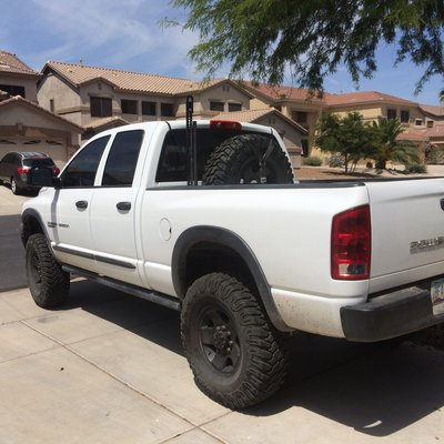

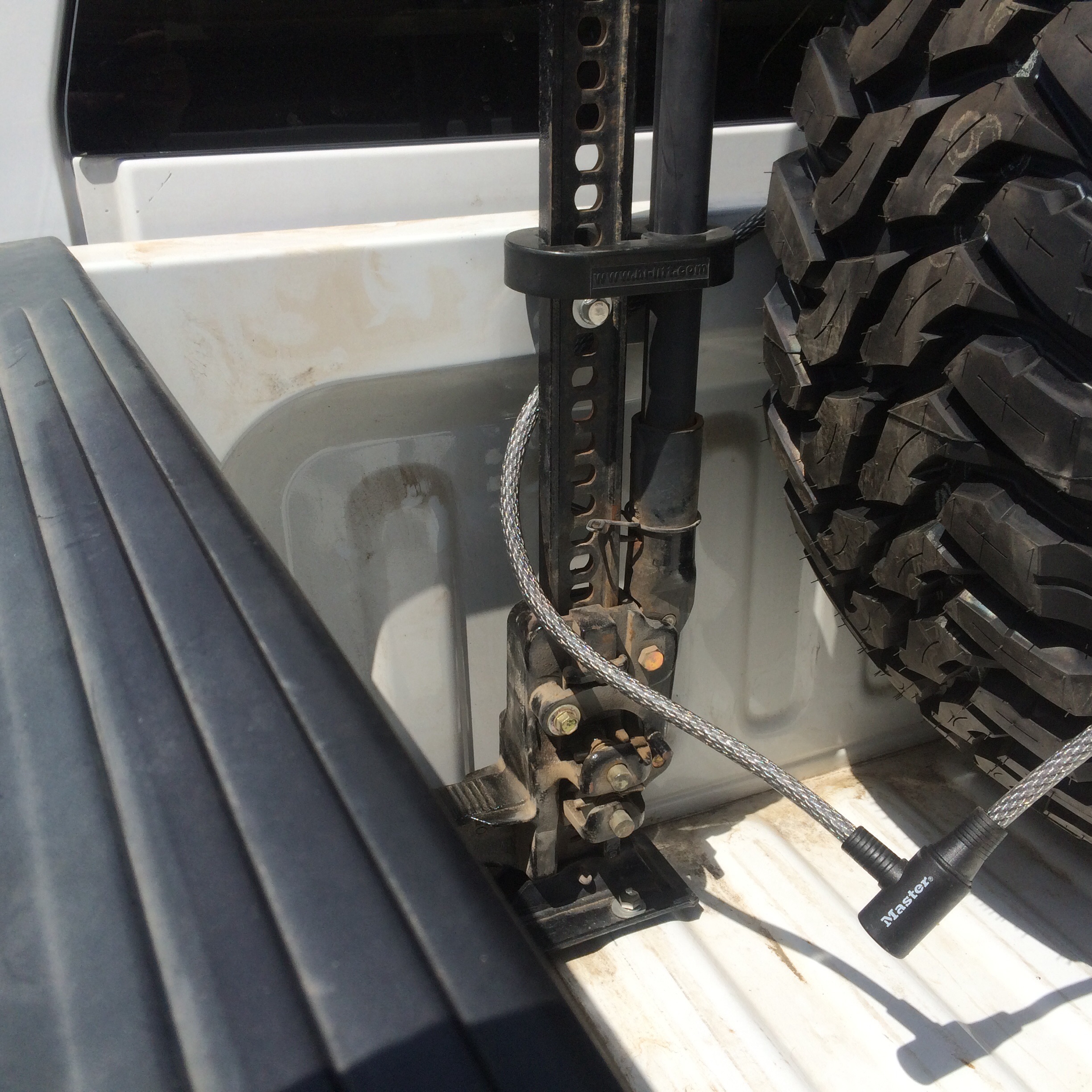

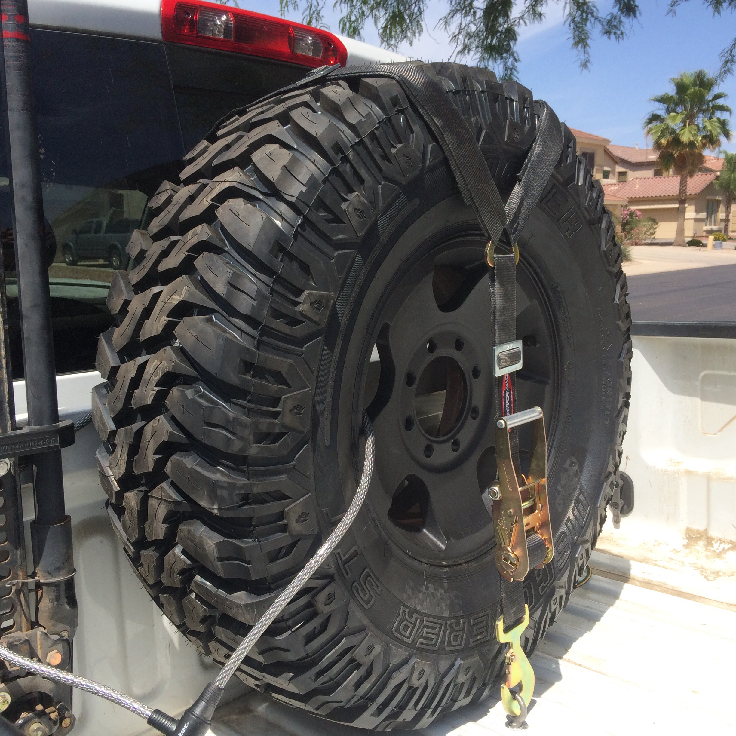

I finally mounted my 37" spare tire. Sheepdog Outdoorsman found a set of 4 power wagon wheels for sale on Craigslist and didn't need all 4, so I bought one for my spare. I mounted the spare vertically in the bed, up against the cab, using rivet nuts, I bolts and a tire hold down strap from Poly Performance. I also mounted my High Lift jack. I used rivet nuts into the bed of the truck and bolted it through the bottom of the jack and one of the holes in the cast iron part. The jack and spare tire are both solid and have no movement. Here are some pics.
