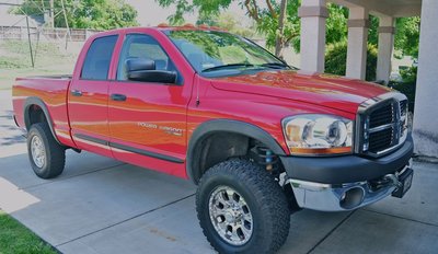

hello all. I think i have introduced my self elsewhere but ill do it again for consistency. My name is Tony, I am relatively new to the off road world but i have been a Mopar consumer (I say consumer only because some times it was not by choice that i drove a Dodge) for a really long time. Back in may i traded my most recent ram a black 1500 QC 4.7 in on what i hope to be a long time member of my family. I purchased an 06 RED Quad Cab manual power wagon from Carmax. The she looks in good shape only had 33500 original miles but was in need of some TLC. she came with after markt rims form Motto with the original KO's and a Dodge drop in bed liner. Ill post a pics once i get a clean one that does not have a part of my thumb in it...(stupid cell phone) i have posted in the pic thread but ill put some of the later pics here.
Since i acquired her on May 5th i have done the following in an effort to get a good baseline of the truck.
Full oil change from what ever Carmax put in to a mobile one synthetic to get the system cleaned out a bit. Replaced the stock air filter with a K&N drop in.
Changed all the spark plugs as it was over 33k on them used the Champion copper.
With this done back in july i took the PW up to Shasta and ran the trails up to Brandy Creek Falls Trail head. Not a rough run but i wanted to exercise the 4wd and it did fine.
after finally getting her a bit dirty i started to evaluate the rest of the truck for what it needed and what i could do my self. (sorry getting a bit long winded and i hate writing...)
I was getting a bit leery of the fact that this truck was 6 years old and as far as i knew the only fluid changes were oil. So i have remedied most of that.
after putting an additionally 4k on the truck i did the following.
replaced the oil with RP 5-30 synthetic and an RP Oil filter
Drained and replaced the G56 fluid as well as the transfer case with RP Synchromax. This quieted down the transmission a lot from the noise i was hearing at low speed.
i had the radiator flushed and filled and added in the RP radiator additive.
I then i replaced the battery. The one i found in there was a wallmart branded battery that was doing ok but i dint trust it for some reason. So out it went and in went a Sears platinum type 65.
my next update is going to be the breaks. I got a burr up so i went and ordered EBC sport rotors the dimpled and slotted not the drilled. And some green stuff pads. I know you have all mentioned the empty wallet syndrome but im beginning to experiences it , WOW :cash: Those arrived today so i know what my weekend should look like but im sure something will get in the way. Ill ad pics of the install when i get it done.
Future will be a spray in bed liner and new diff covers once i see that DOR has them for both front and back then ill pull then and fill them with a nice gear oil.
all commentary is welcome
looking forward to getting to know the crew here seems like a good bunch
