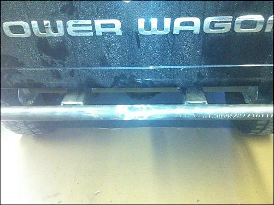

Rear Tube Bumper Build

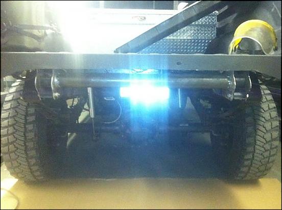

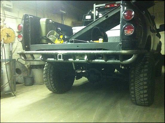

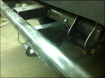

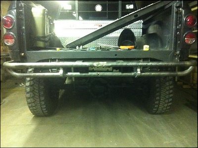

OK here is my rear tube bumper build. I used the stock hitch frame brackets and worked off of those. I am welding in a 3" dia 0.250 wall tube between the brackets. Everything will be out of .250" wall. I am just tacking everything together for now until I get it the way I want, then I will remove it and fully weld it and paint it.

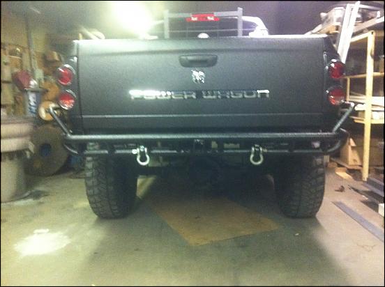

Re: Rear Tube Bumper Build

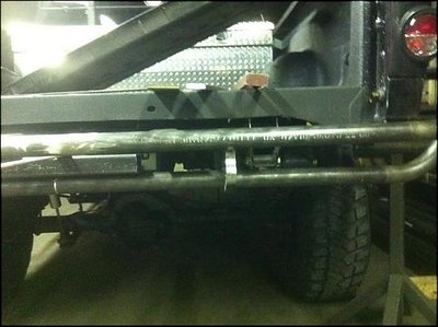

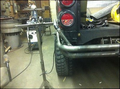

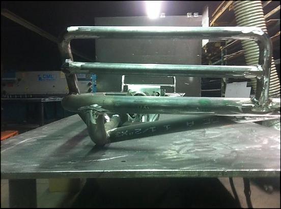

Continued

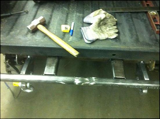

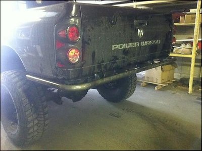

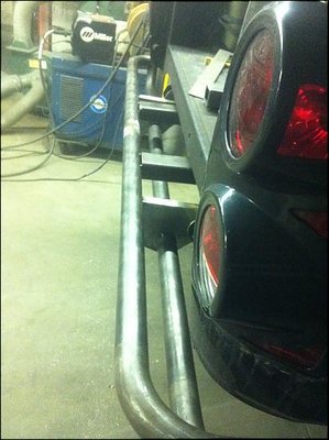

Continued

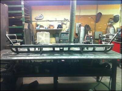

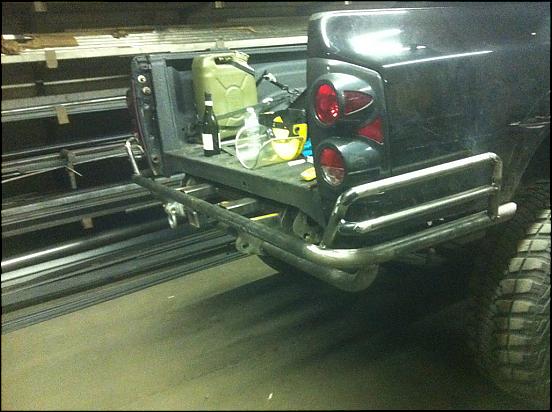

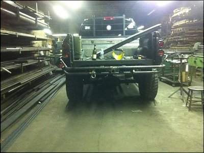

I started on the side hoops I used 1.25" dia tube 3/16th's wall. We dont have a tube bender at work so I tried my best using some elbows that we had lying around.

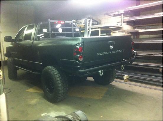

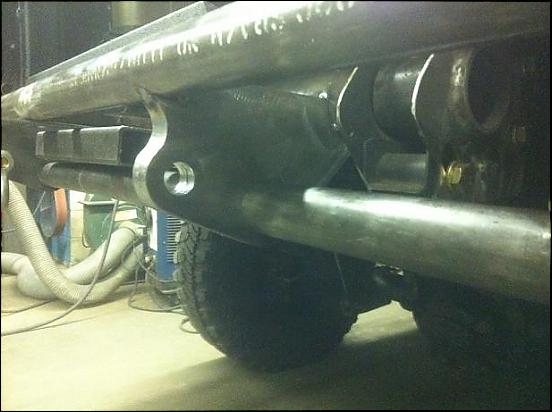

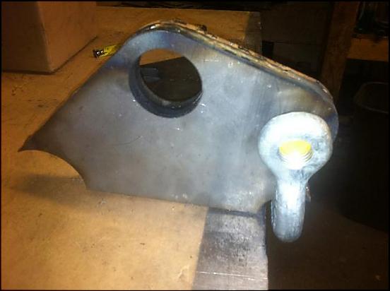

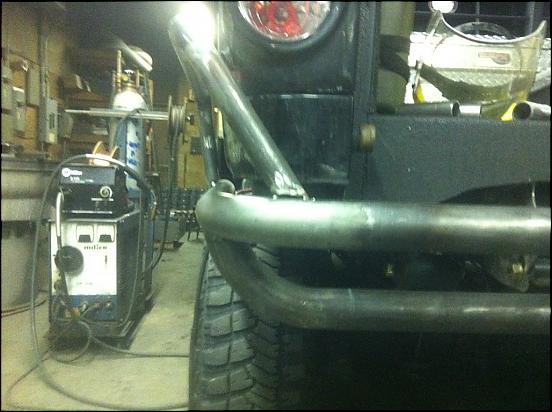

Continued

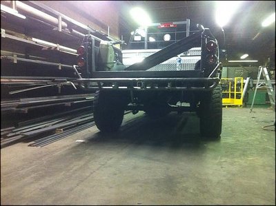

HELL YEAH...NICE WORK MATE!!
Glad you posted a build thread on that because I saw it in your avatar and was going to ask you for details.
Very well done. Love the upper corner hoops too.
Thanks for posting all that.

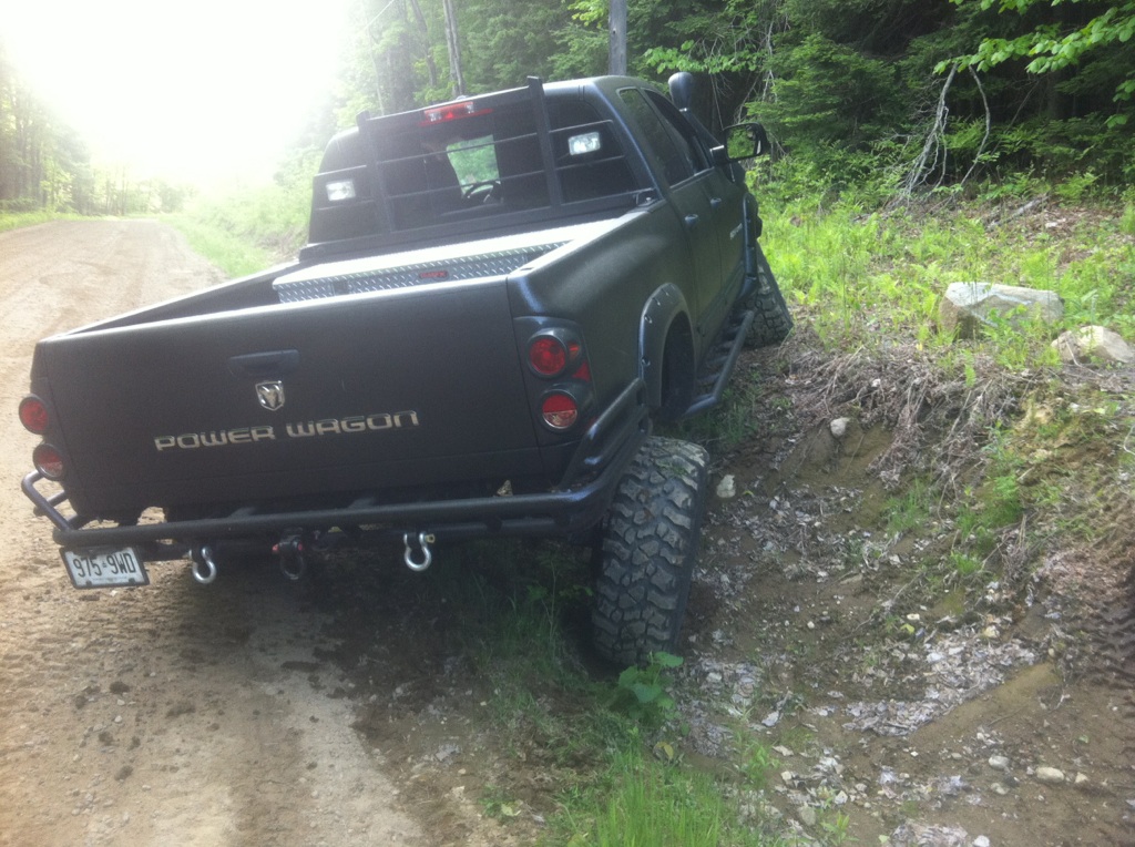

BTW...is your truck completely murdered or is that all Line X type coating?
Either way it looks freakin' mean!
line-x over the whole truck.
- Powerwagonmark
- Posts: 189
- Location: Ontario, Canada
Yup it's completely line-xed2012 PW ST wrote:BTW...is your truck completely murdered or is that all Line X type coating?
