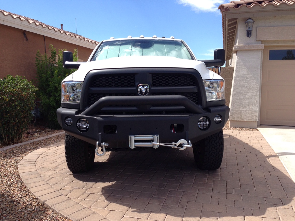

- SheepdogOutdoorsman
- Posts: 1061
- Location: Mesa, AZ
Re: Stickman's Daily Driver/Weekend Warrior Power Wagon Buil

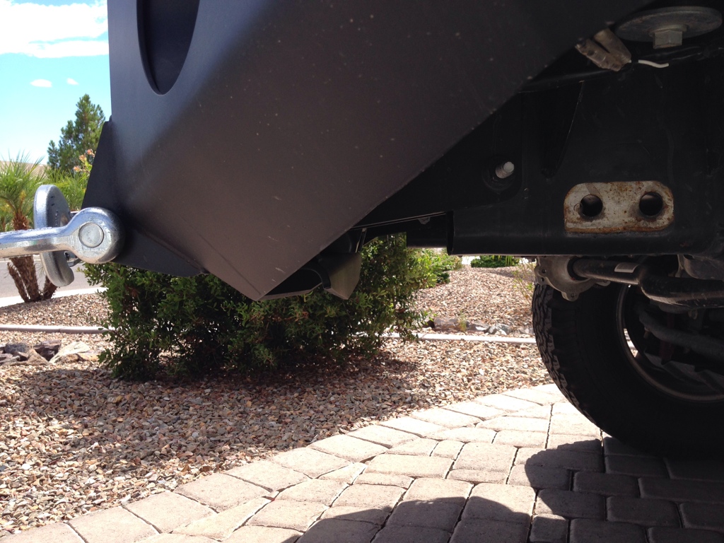

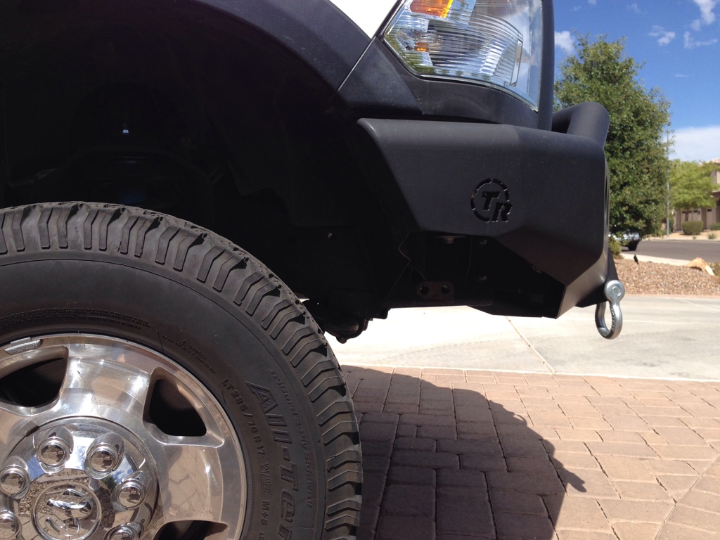

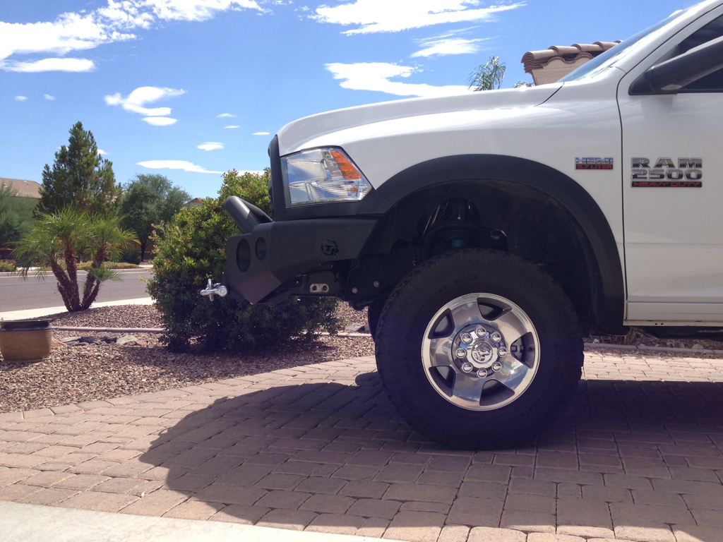

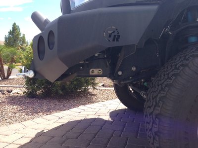

As you can see the Trail Ready bumper sits higher overall, versus the Backwoods bumper, (offering better approach angles) and it's not as wide. The bottom of my bumper is almost level with the bottom of the frame and for having a winch mounted in the bumper it doesn't sit that much further out than the Backwood's bumper.
That does look a little better than the Backwoods. Lots more room on the sides in the front of the wheel wells for larger tires and no clearance issues. Sits right up to the frame, lots of lighting options. Sucks the winch mounts so low in it. I have some thinking to do. Anyway I went to town earlier today and when I came back I decided to pull off the side of the road and flex it a little. I think this is about the limit of the stock setup, it started 3 wheeling for a split second if I tried climbing up the embankment any further.

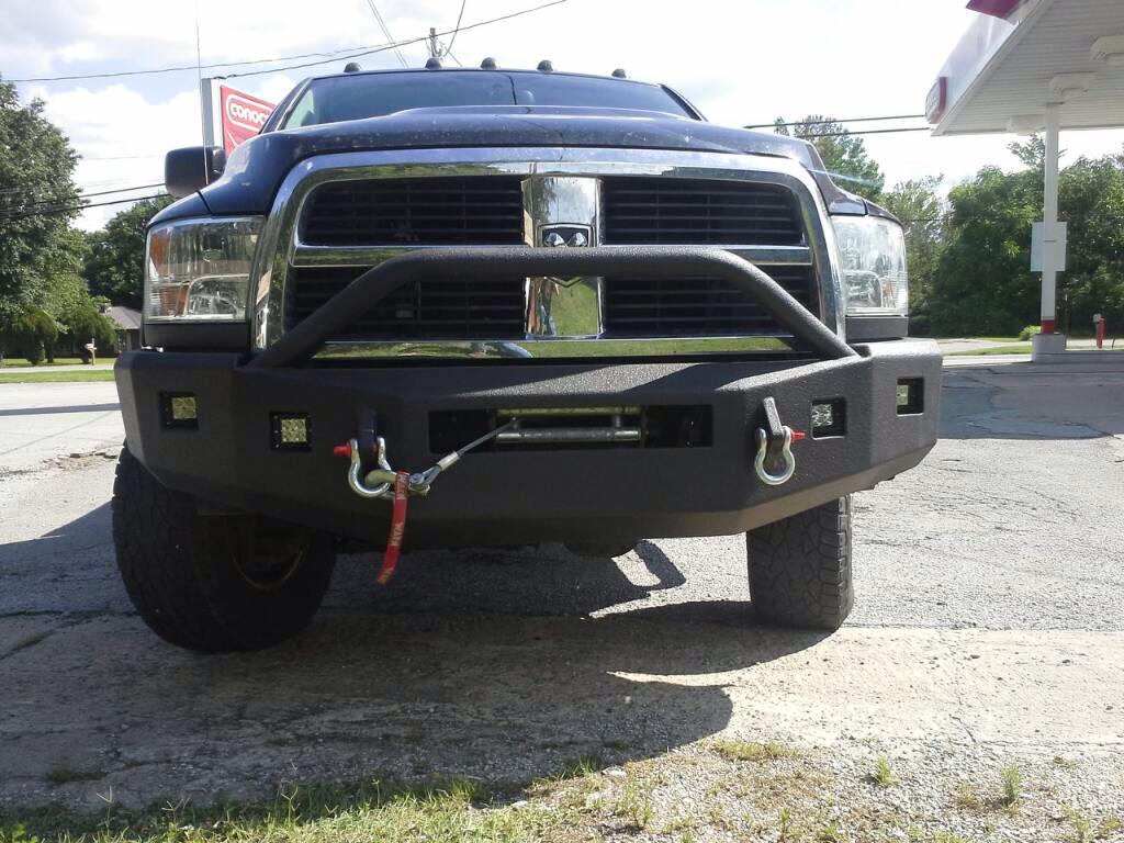

Got my bumpers back yesterday before work, got them fully installed today. Now I want my Retro headlights more than ever. Ended up costing me $675 for both of them and my hook
But it's premium and it is going to look good and is warrantied so I guess I can't complain. Only thing I have discovered about them is if you live in an area with a lot of bugs they make the front of your truck look like crap since they really stand out against the black (notice how my grille looks like chite?). Didn't take me any longer to physically install them, but it took me a total of 2-3 hours using a dremel and a utility knife cutting excess Line X out of the rear park sensor holes in the back bumper, cutting out the plastic that is behind the trailer plug in the plastic step In the rear bumper since the Line X was so thick it wouldn't clip in unless it only had to go through the Line X and not the Line X and plastic. Then the front bumper gave me fits trying to install the fog lights brackets. Again, Line X was so thick I had to wedge them in there in just the right spot or the bolts wouldn't line up with the catch nuts on the other side. Also had to remove the valence to get the fog lights in (since there's not nearly enough room to wedge the fog brackets in with the 2 bolts sticking out in the way in the bottom), then when I tried putting it back on I had to use some of my Honda plastic push rivets and washers in place of the cheap, crappy, brittle plastic Dodge push rivets that wouldn't do anything but break and not go all the way through, even though they were in there before I had to remove them...
Anyways other than a couple other little stupid things that were easily solved when assembling them and installing them it wasn't too hard at all. Still need to get a small, long bolt and nyloc nut to put back on my winch hook for the safety latch since they had to cut the factory rivet off to Line X the hook since it would have made the spring useless. Loving the tough look it gives it and also loving the fact I won't have to polish and shine the chrome to make it look good anymore, just hit it with the power washer with soap at the local car wash and it'll look show room new (at least for a truck with Line X on it) Also gives it a "trail ready" look. I actually used a dead blow mallet to get the rear bumper on when installing it and hit it 4 or 5 really good times and it didn't even give it a slight flex, still looked perfect, I love how tough bed liner can make even the weakest things tougher. Hell even that front valence got stronger, not just a thin weak piece of plastic anymore, it actually takes a good bit of force to bend it. And even then it will just spring right back to it's original shape (most of the time) and never have a scratch. On to the pics! Btw I only flipped the tow mirrors up to see what it would look like, I run them down everywhere unless actually pulling a trailer
