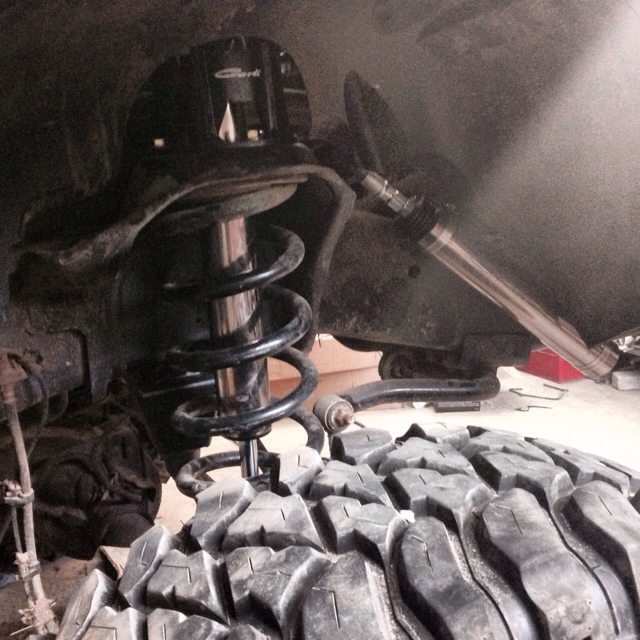

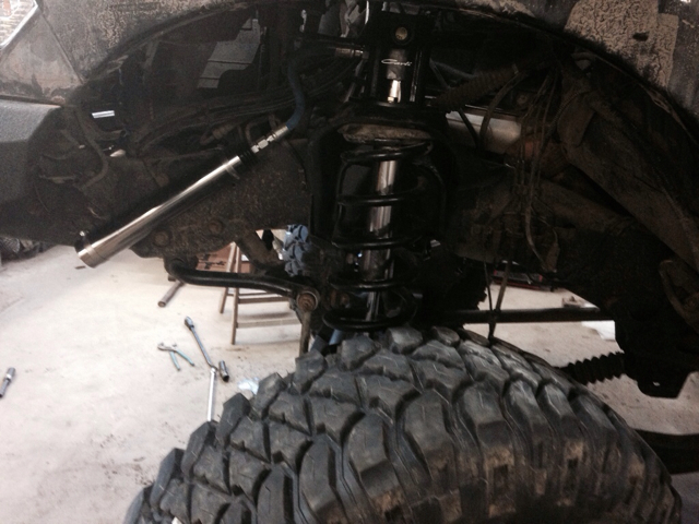

Fronts are in. Need bigger coils now. With the shock extended (no limit straps) my coils are falling out lol have to save some more dough for Carli coils next maybe. Need to find a way to chop my fender liner though so the acv's co-exist with the fender liner cause their facking massive resi's !!!!
Changed the plugs today also...wow what a pain in my backside. Doesn't help the trucks pretty big. Glad I have that bumper to stand on now!

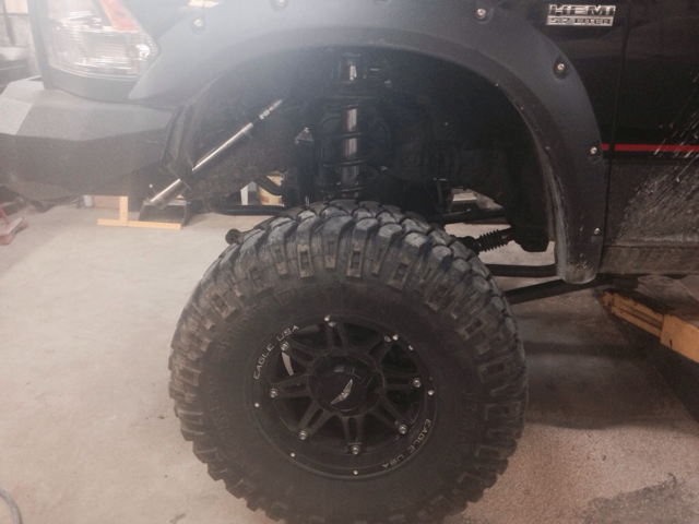

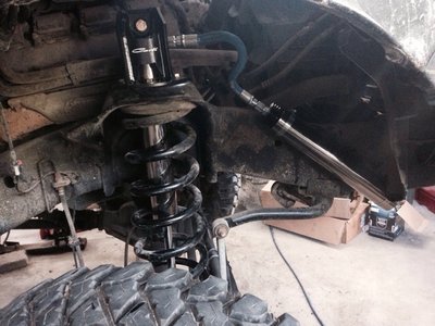

ImageUploadedByTapatalk1402280511.500551.jpg[/ attachment] Rears are in front fender liners are cut. Now waiting for coils and brake lines! Apperantly when you build a long travel suspension you need to extend your brake lines lol so ya! need them. Driveshaft is still being lengthened pipe was back ordered. Thuren coils have been ordered hoping strapt will have them soon and send them up here so I can pay an extraordinary amount of duty on them lmao :( [attachment=0]ImageUploadedByTapatalk1402280760.583920.jpg

Post by TwinStick » Sun Jun 08, 2014 11:41 pm
:rockon: Looks awesome !
You gonna coat the shiny aluminum with anything to prevent corrosion ?

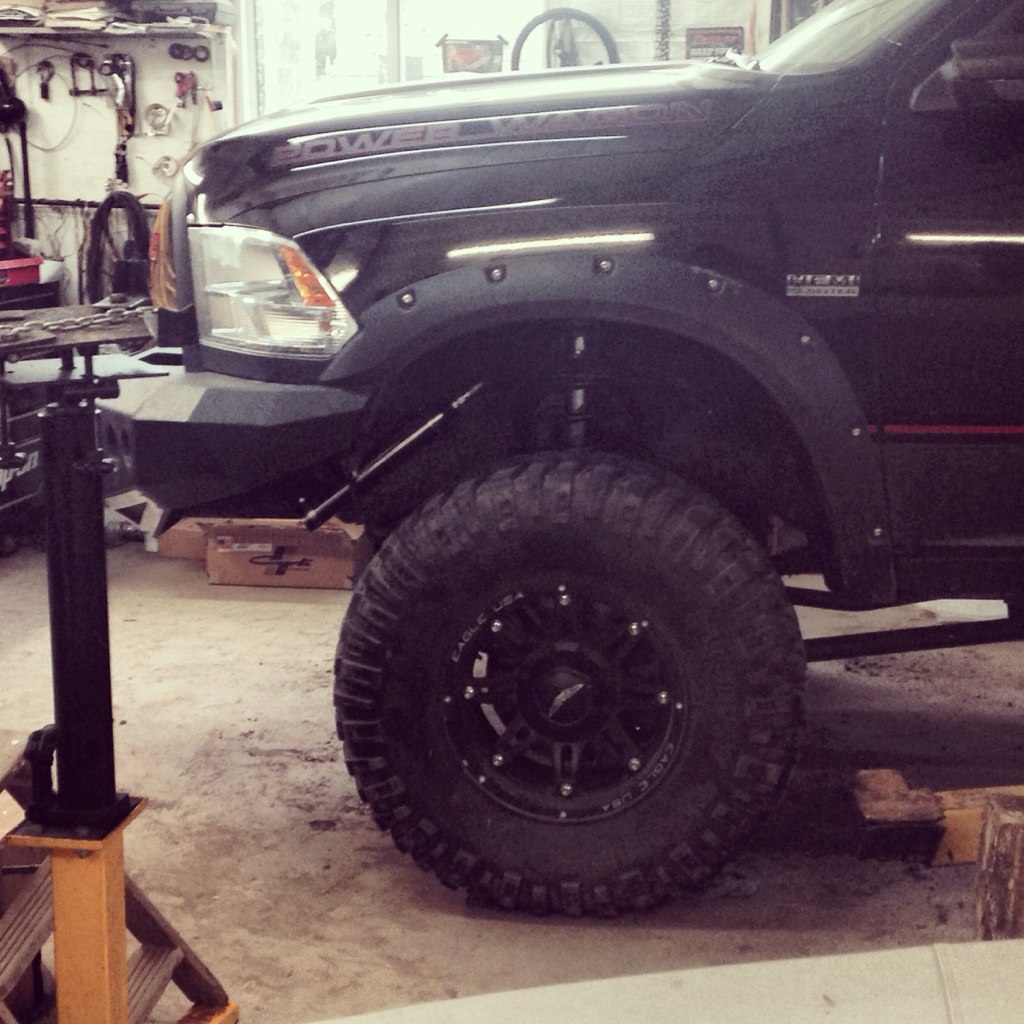

Damn those look sexy. The whole thing looks sexy. That last pic of the front with it on the ground looks badass, those rims look good. Did they increase the ride height any? Or is that just with a full charge in them? Looks like it's sitting a little higher, or maybe that's just me. :excited: You're making me want to do all of this to mine and make it look like it's twin. :cash:

TwinStick wrote::rockon: Looks awesome !
I'm heating from skydram that I don't really have to he says the triple plate bilstein coating works well aha isn't corrosion he showed me a pic of his Truck which lives in michigan after 3 years their still shining!

Stickman wrote:Damn those look sexy. The whole thing looks sexy. That last pic of the front with it on the ground looks badass, those rims look good. Did they increase the ride height any? Or is that just with a full charge in them? Looks like it's sitting a little higher, or maybe that's just me. :excited: You're making me want to do all of this to mine and make it look like it's twin. :cash:
I think they did alittle bit ! Only have 90psi of air pressure in them now just to drive it around the shop and my front yard until new Thuren coils come and brake lines so I can actually use this insane amount of travel without my coils saying good bye and taking the brake lines with them! Also have to chop my exhaust and lower it so the driveshaft can actually articulate to the full width of the Tavel now too!

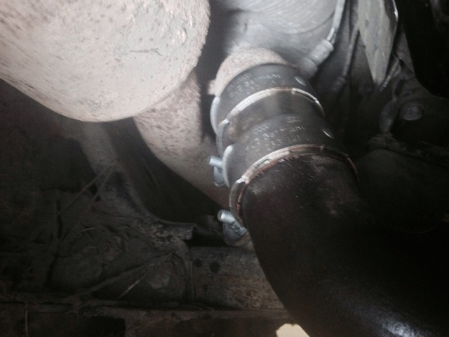

Also installed my lengthened driveshaft and greased the hidden zerk! Marked it with some paint to help find it. Damn it felt good taking that spacer out!!
That's right I painted it red!! Lol it's what I had in stock....matches the shackles lol
also cut and lowered the exhaust for the extended travel shocks and lower driveshaft angle now. Found some sweet exhaust clamps in my tool box from
When I worked at Audi that's fit the hemi exhaust perfect literally chopped twice with a sawzall installed these couplings and lowered it approx 3/4" -1" nice and tight no leaks way cheaper then getting a new exhaust too!!

So if anyone's doing a lengthened driveshaft or exhaust id suggest just getting your hands on a pair of those clamps makes life super easy and much cheaper then buying a replacement exhaust or piece to install.
